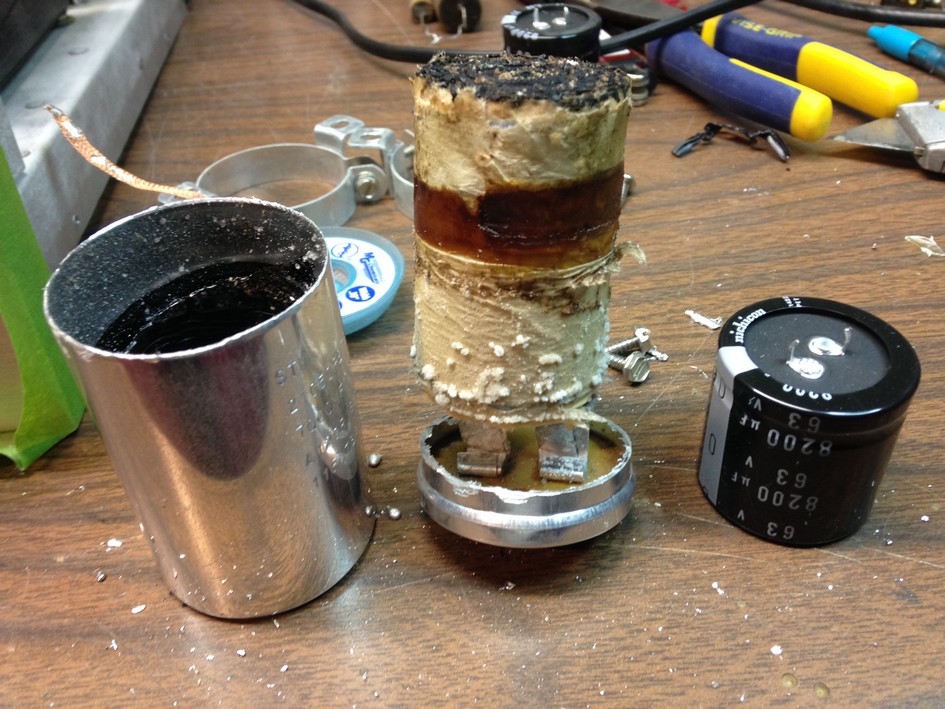

The first thing I did was what I felt would be the hardest part: restuffing the two main electrolytic cans.
I unsoldered everything from them (taking notes beforehand), removed the cans, and cut them open. Here's how they looked:
[Image: http://www.philcoradio.com/images/phorum/S7900A_018.jpg]

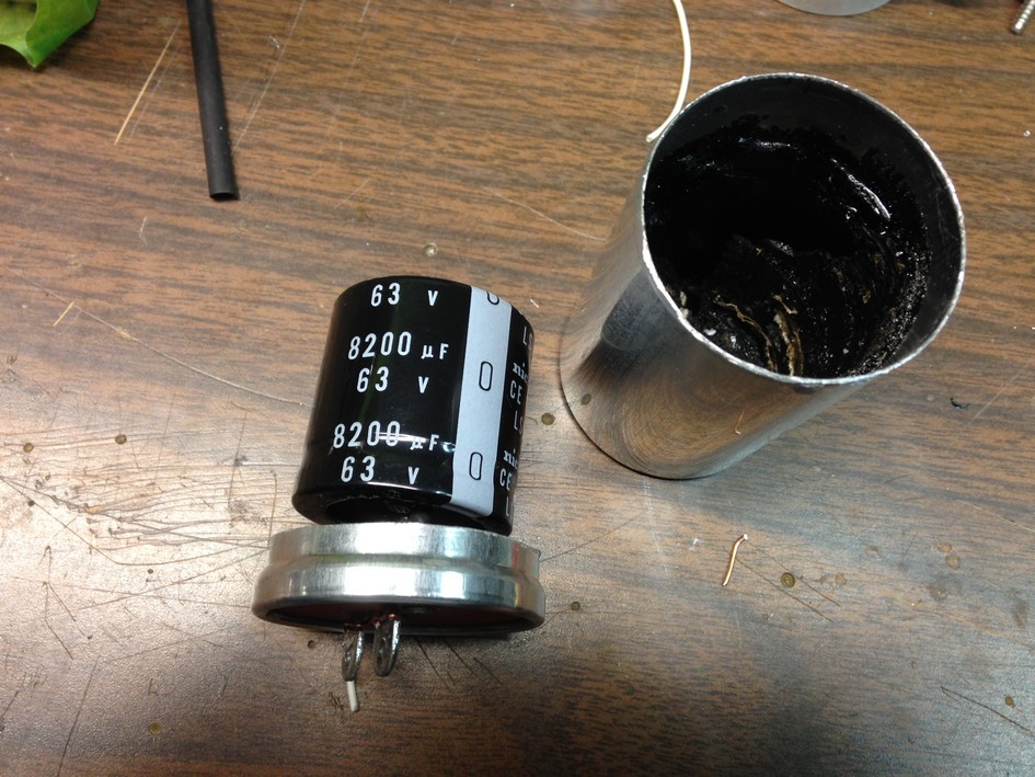

I cut away the old electrolytic, drilled two holes in the base, and soldered two wires to the positive and negative leads of new Nichicon electrolytics. The originals were 7000 uF, 50 volts - the new ones are 8200 uF, 63 volts.
[Image: http://www.philcoradio.com/images/phorum/S7900A_019.jpg]

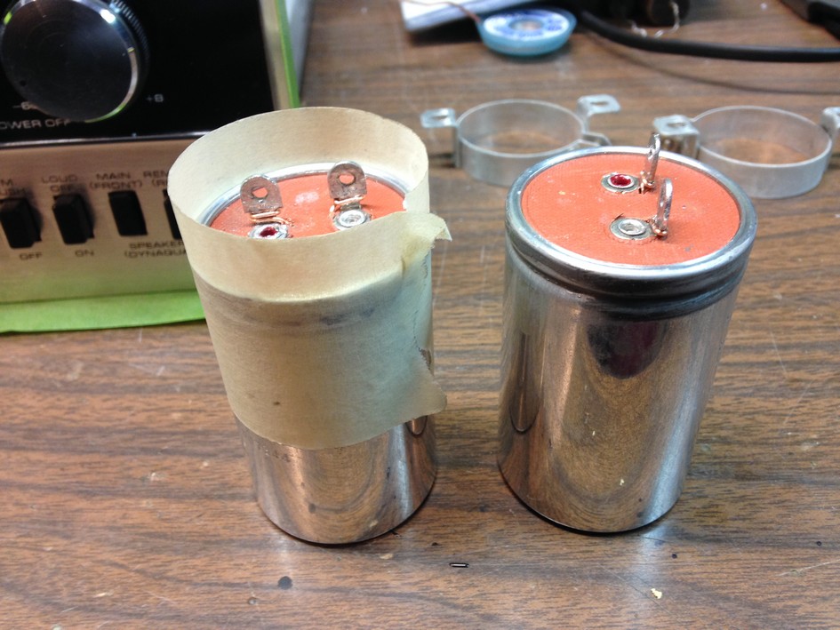

Then I glued the cans back together:
[Image: http://www.philcoradio.com/images/phorum/S7900A_020.jpg]
Tomorrow, once the glue dries, I'll reinstall these into the receiver. I will also be replacing the four rectifier diodes and a few other electrolytics.

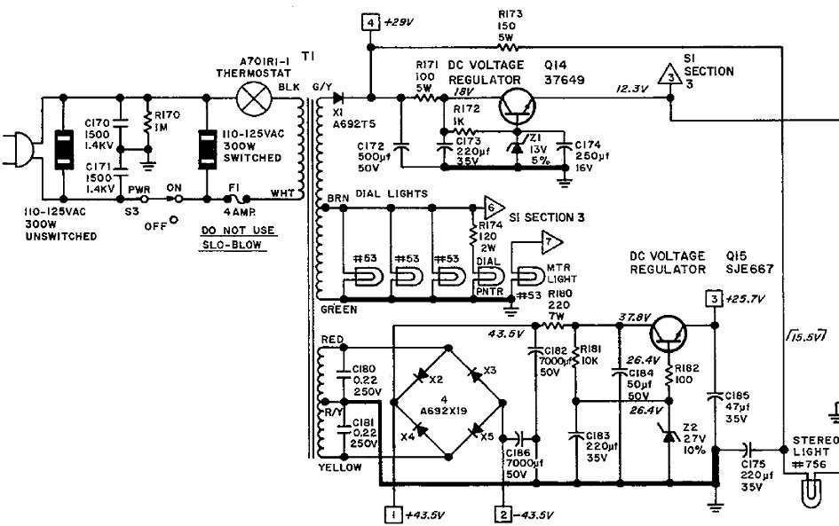

This receiver not only has the death caps from each side of the line to ground, but also in the high voltage secondary winding of the power transformer. The originals in the secondary are 0.22 uF film caps (not safety caps). I'm thinking of replacing them with .01 uF safety caps. What say you, people?
Ron
You never gave the sch link.
So I am not sure what you call high voltage secondary. But from what I know, the secondary side caps do not need to be the safety type. Only the primary.
...schematic...who needs a steenkin' schematic?
Well, okay. Here's a partial, showing the power supply:
[Image: http://www.philcoradio.com/images/phorum/S7900A_021.jpg]
C180 and C181 are the caps I was asking about.
You call THAT high voltage? Ron, solid state is getting to you.
1. Those are not the death caps.
2. They do not need to be Y-caps.
3. Leave them be.
C'mon, Mike, I know that isn't high voltage... Icon_rolleyes
I was making a comparison to a tube circuit, in which this secondary would be on the order of a few hundred volts instead of around 40 volts. You know, the rough equivalent to the B supply.
OK. The original film caps shall remain. But I will replace C170 and C171 with safety caps.
Yes the C170 and C171 have to be safety Y-caps.
C180 and C181 are so called snubbing caps. They take care of potential unwanted noise from diode switching. they take different forms: sometimes placed across the diodes, sometimes just one cap across the transformer, sometimes like what you have.

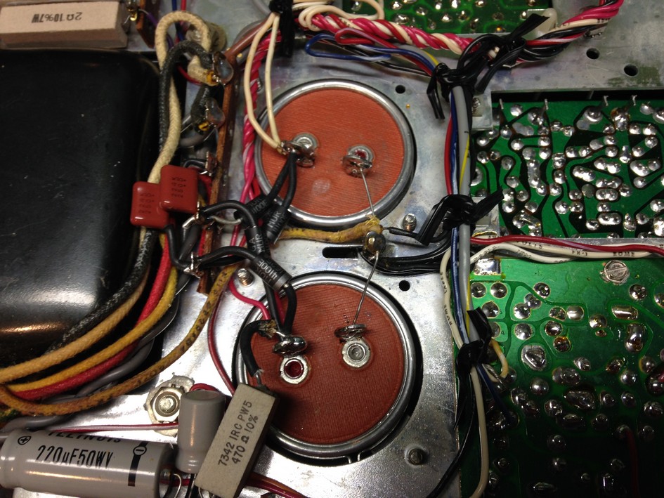

So...first thing this morning, I reinstalled the newly restuffed power supply electrolytics:
[Image: http://www.philcoradio.com/images/phorum/S7900A_022.jpg]
I also installed four new rectifier diodes. And for good measure, I also replaced the snubbers (0.22 uF, 250 VDC), C180 and C181. These are the two burgundy items to the left of the new diodes that look like Chiclets.

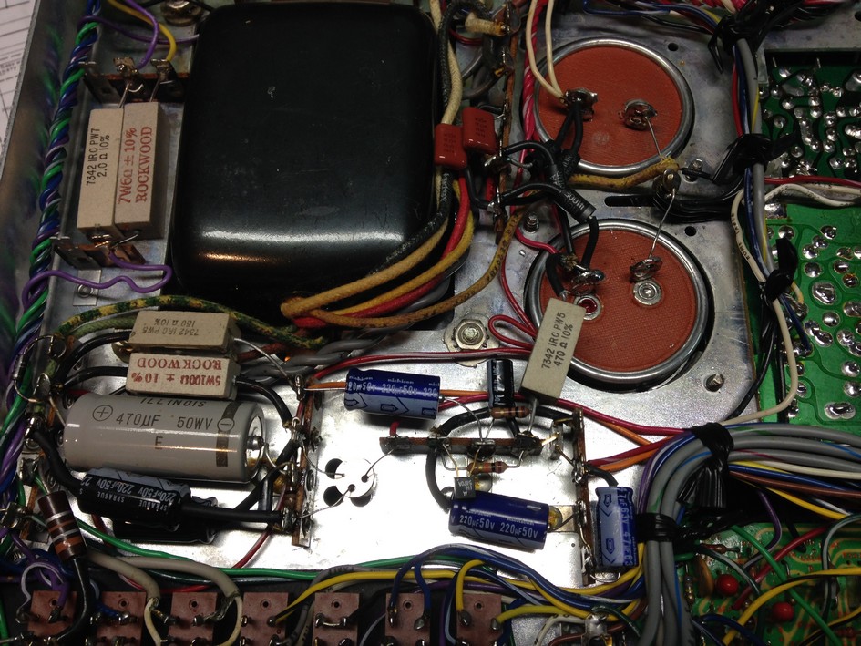

I then proceeded to replace as many of the electrolytics under the chassis as I could.
The result:
[Image: http://www.philcoradio.com/images/phorum/S7900A_023.jpg]
No, the 470 uF 50 VDC electrolytic did not get replaced - I forgot to order one. Icon_redface Perhaps in the near future, I will go back in and take care of that.
