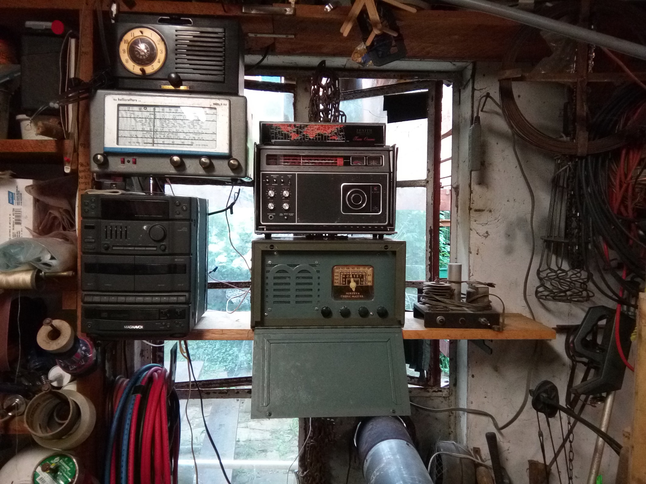

missing in this pic of my repaired sets (notice i dont say resto cause im not really doing purist work), are 4) s38's, 1) s53, &  1) philco 46-1226 which is in the master bedroom.

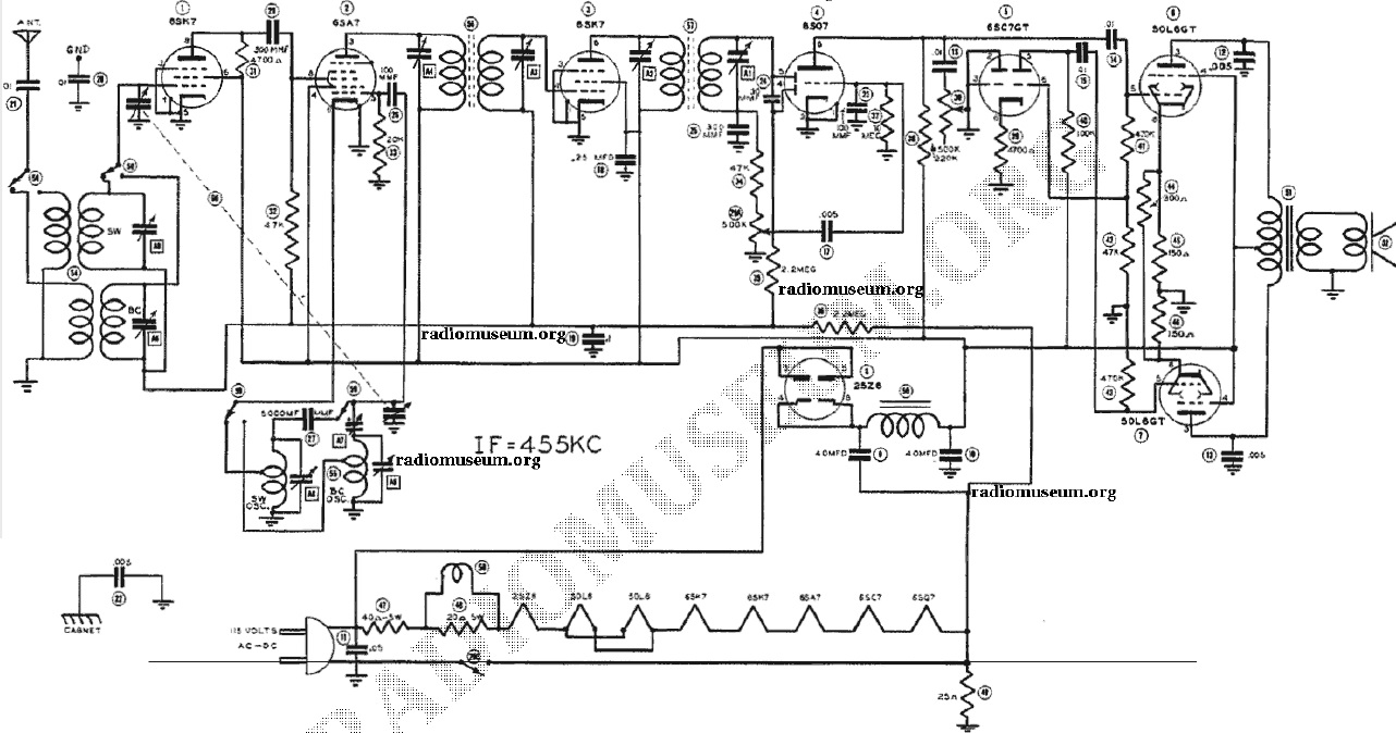

-If the set has the letter "M" in the speaker grill *AND* is occupied by the schematic showing series 50L6's,
~~~civilian sets had a louver grill over the speaker.
-then the set was only found for sale in a military exchange army/navy.
**this means that the set "should" have been on the front lines as the moral radio of the minerva line.
if the radio schematic has parallel audio output push/pull's & other rectifier tubes, then it was civilian ordered.

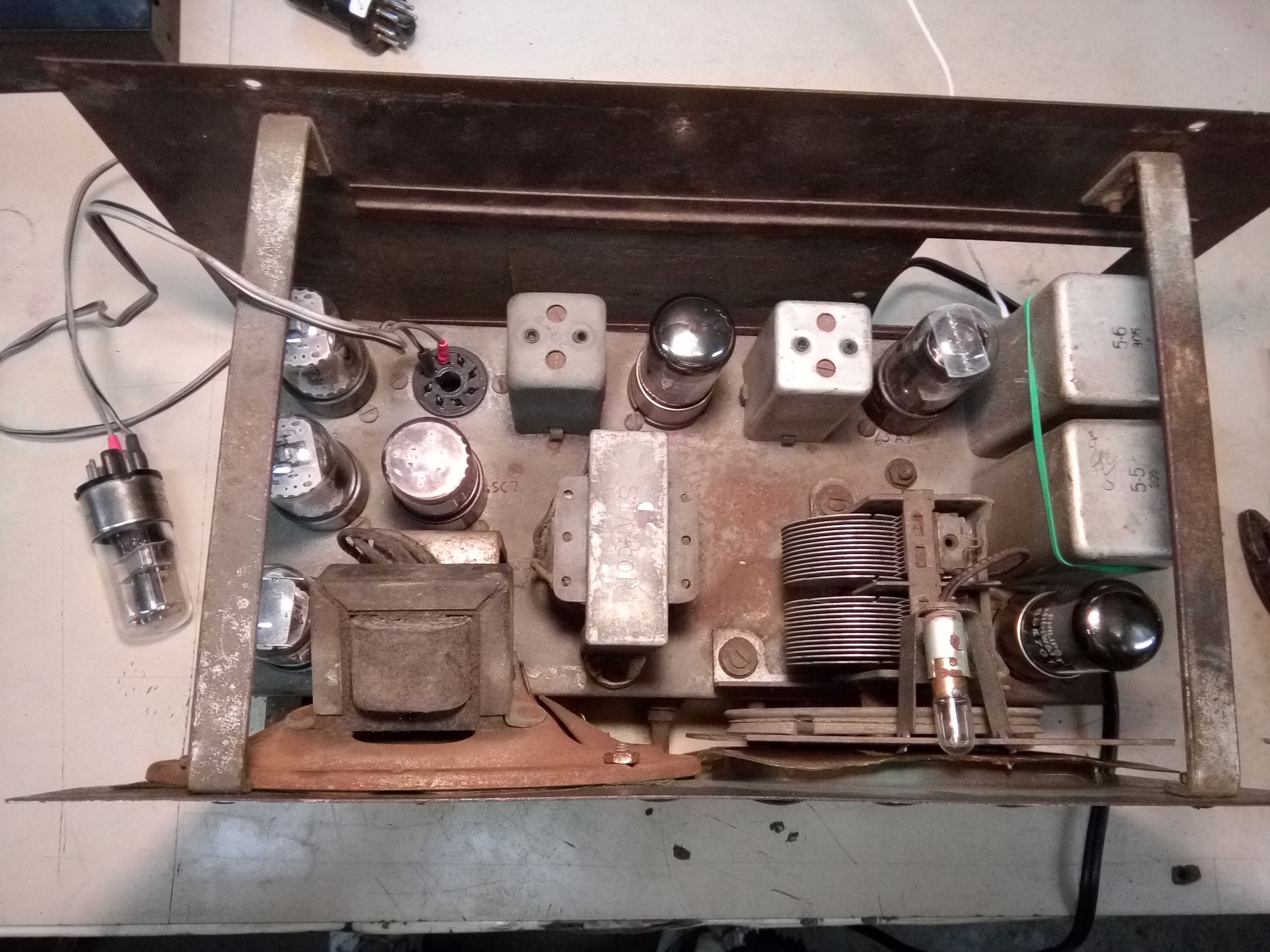

bench tested each tube to dongle off to the side jumper wiring only the filiment. see picture(s
--this was done to establish when the noise went away compared to which tube i had out of the ckt.
--after all tubes were dongle bench isolated & tested, the noise remained still!
----two of my tubes have the filliment on pins 7 & 8, the rest are 2 & 7.
--the above dongle test excludes the 25L6 and the 2) 50L6's.

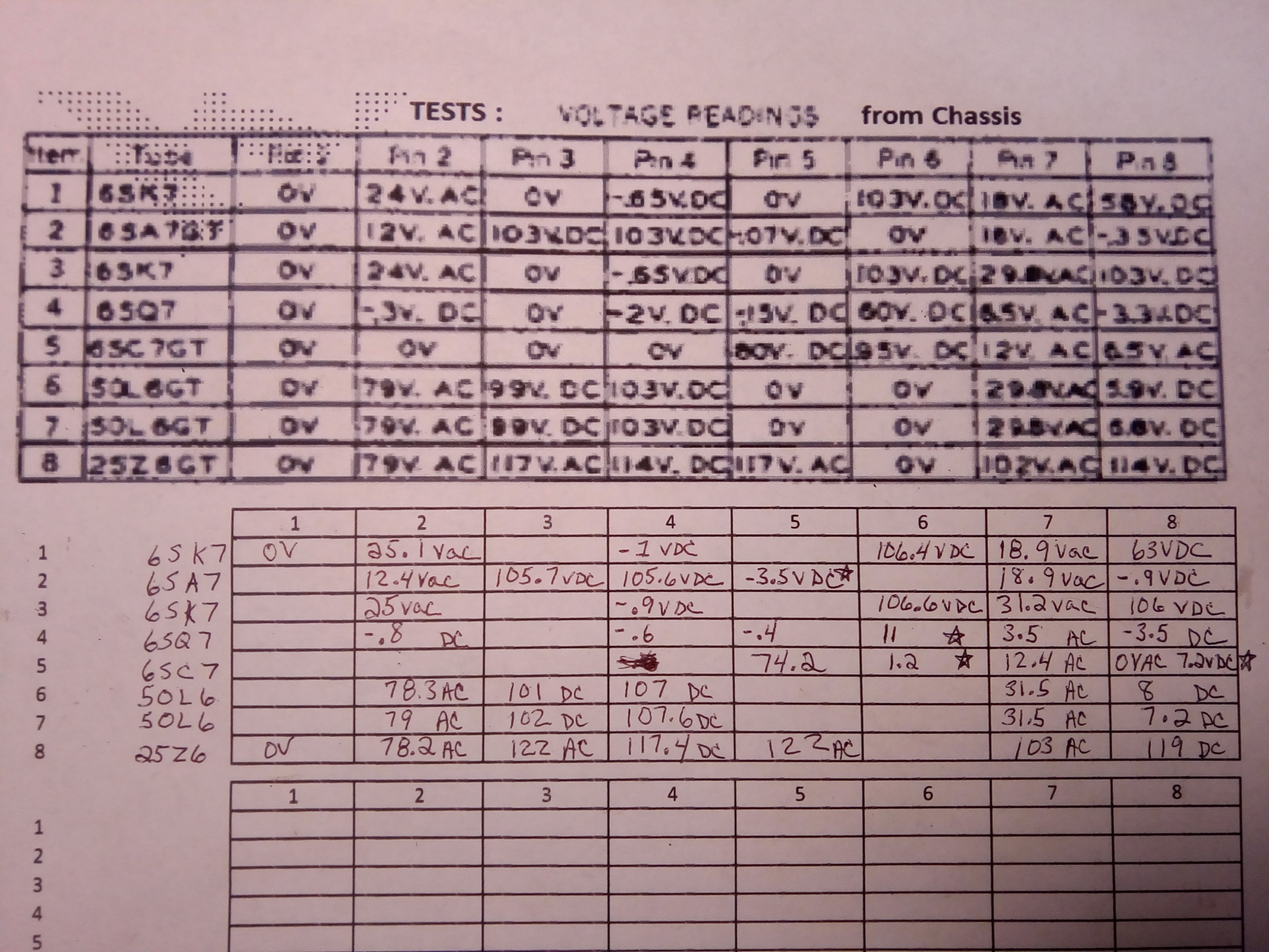

pull up the print, zoom in on the voltage and resistance tables ,, copy / paste to paint, then save as a jpg then print and jot down my readings.

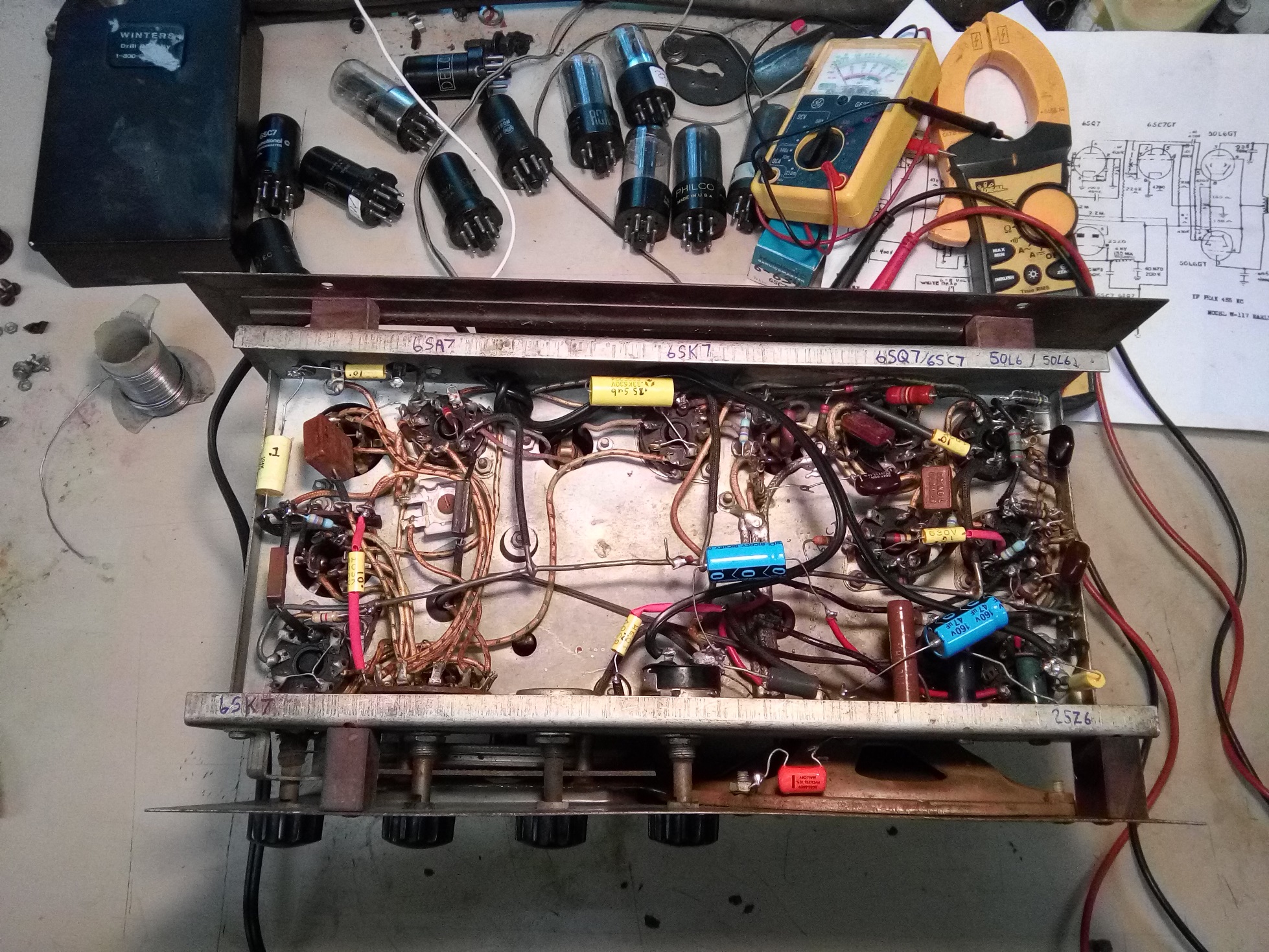

here is a pic of the current view of the bottom of the set showing some replacement resistors and temp connections in various spots while testing.
here are the voltages i just took compared to the OEM data sheet suggested readings.
i seem to have a couple problem areas around my 6SC7???
11v on the 6sq7 is a problem. Measure the resistance from p6 to the chassis should see a high resistance. Perhaps 50K or better. A wrong value resistor on pin 6 or + voltage on the grid of the 6SQ7 could cause this circumstance. Voltage on the 6SC7 are good the one you noted is .95v vs 1.2 not a big deal.
Pin 6(plate) of 6SQ7 should measure at least 220K ohms which is it's plate load resistor. Through the power supply is its only  ground reference. If it measures lower there is a leaky cap or maybe tube socket.
The likely scenario is resistance will measure high, meaning the 220K has increased in value. If resistor value was low, plate voltage should be high. If all resistance is good, likely the tube has issues. If all is good and tube doesn't fix it, quit worrying, a 6SQ7 will operate with only 11v on plate..
For tube heaters, measure voltage across heater pins, if it's 6v(or 25v on higher voltage tubes) you're golden.

>>>replaced filter caps from 450v 47uf to 160v 47uf
Hopefully, that's a typo  Icon_smile  If not,...
Ah, yes. now looking closer at the blue caps, it can be seen that you did in fact put 160v replacements in. If these call for 450v, therein lies the problem... (maybe)
B+ is derived from the AC line, 160v caps are fine.
Considering the voltage drop within rectifier, B+ will likely never be greater than 135V(in fact is listed as 117.4 & 119v on chart).
NOW, since the voltage on pins on 4 & 8 is different, is there a resistor between these two points? Cathodes should be tied together.
Tom
Thanks for that. Couldn't really see the schematics too good from here. Zero chance of anything being that obvious, of course. Never is. Icon_lol

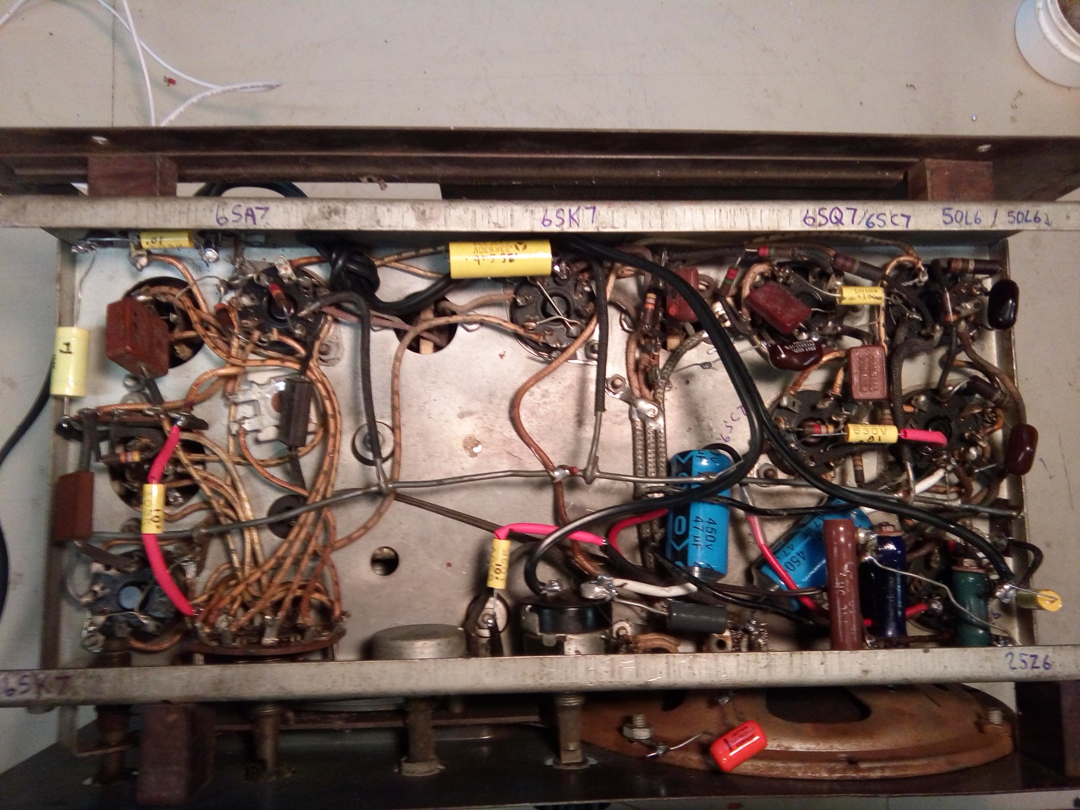

when i got the set, it had a single filter cap and a modified or repaired power supply (power resistors) end that i had to undo and redo to match the prints.
the set came with a single filter cap that was too big.
i downgraded from 450v 47uf to 160v 47uf dual filter caps.
the big bare sol bar is B+!!
the 6sq7 pin 6 220k ohm resistor is new and is actually 270k and twice the watts than original.. thats what i had.
the original resistor was reading 330k.

the pic above showes a "GREEN" resistor which is the 40ohm 5w power resistor on the AC hot line cord.,,,, this gets very hot, a bolt passes through the center and fixes the resistor against the metal chassis to wick heat,,, prior work shows someone used plastic insulators which tells me the heat cant easily get off the resistor. I temp'd in a 50ohm 50w made for free air and noise remains.
there are two resistors to the left which i had to reconfigure. the blue is 40ohm and the longer brown is 50ohm. i soldered them in parallel to make what reads now as 23ohms which becomes the single resistor for the pilot lamp, the output side of these two resistors feeds the filament string.

when i dongle / jumper wire bench test just the filament of the 6sq7 the problem **STILL** remains,,,, and hopefully what this really says is that i have a bad tube socket.
the filament voltage on pin 7 & 8 of the 6sq7 reading was about 7vac when set was warm and failing.

Actually you can more or less tell with the heater test setup of 6SQ7 pictured. If you have additional leads, connecting pins other than 4 & 5 would be a valid test.
