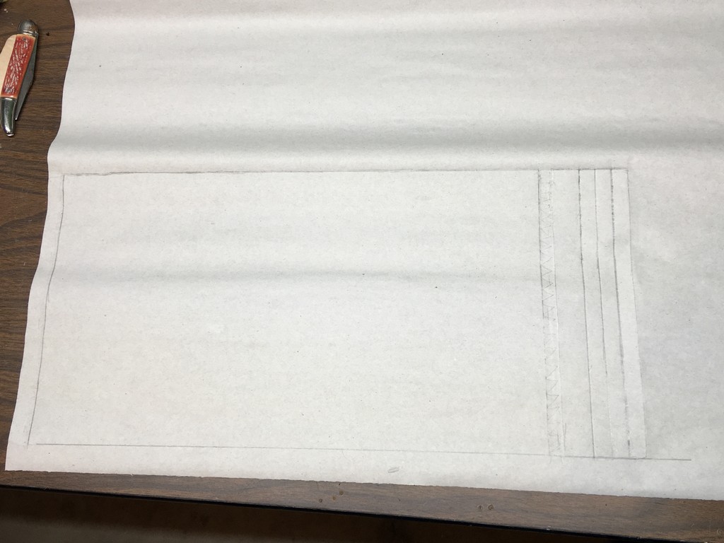

I traced out a template of the left side, showing the various pieces of veneer which need to be cut.
Of course, the large piece is not square.
Well, between working on my RCA 6T2 and my Philco 66, plus mowing the yard, this is as far as I was able to get with the T7-5. Maybe one evening this coming week, I can get the veneer cut to size and ready to glue into place.

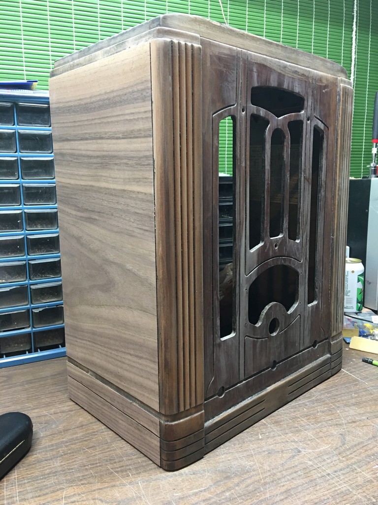

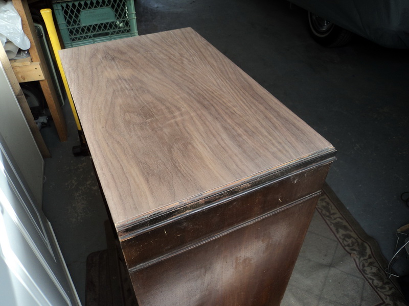

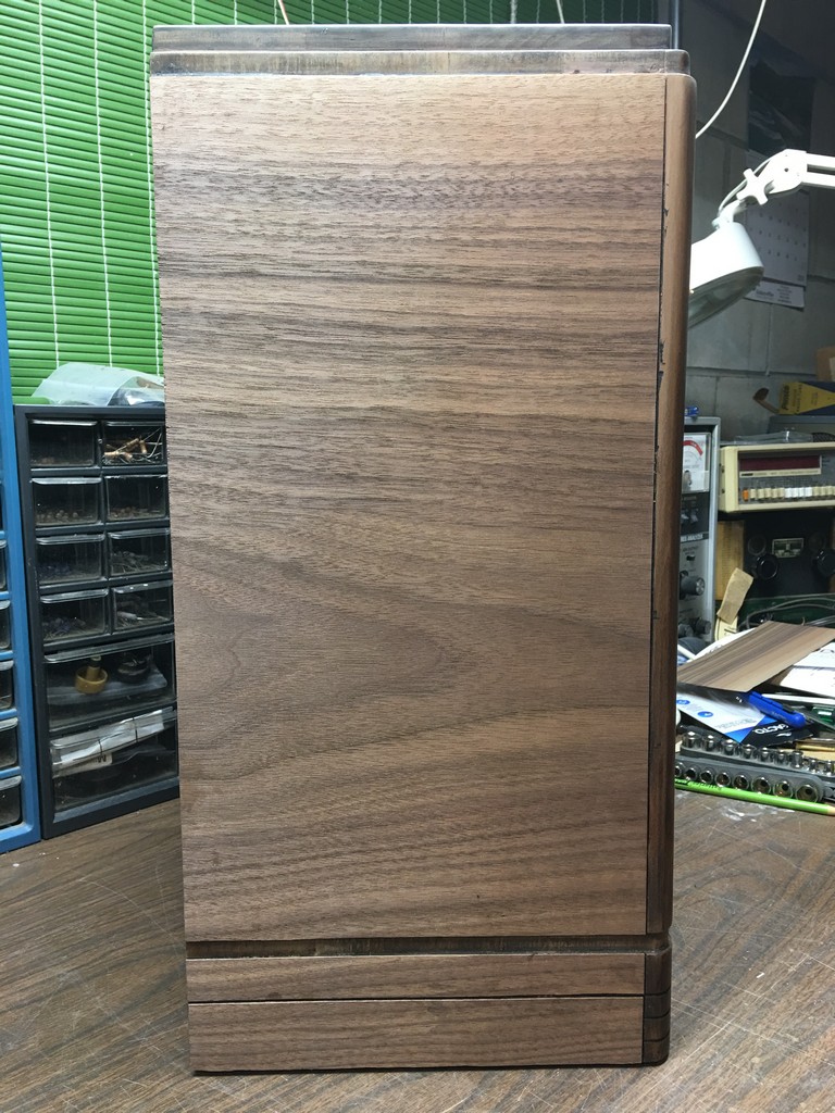

Tonight, while you lucky guys were enjoying your drinks and food at the Basin Street Hotel in Kutztown, PA, I was outside my garage, cutting veneer and gluiing it to the T7-5 cabinet.
The first large piece I cut was just slightly too small (naturally) so I gave up on trying to cut it the right size and made it slightly oversized, lining it up on the front edge before pushing it down and rolling it into place with my little rubber roller which I had purchased just for this job.
The next piece was cut just slightly oversize and was glued into place.
For the bottom three strips, Arran, I followed your advice and glued one solid piece in place. I will attempt to cut the grooves later...hoping that works out because I've never done that before.
After I glued the veneer into place and rolled it out, I carefully trimmed the excess from the large top piece and the second smaller piece, as well as the back and bottom edges of the bottom piece.

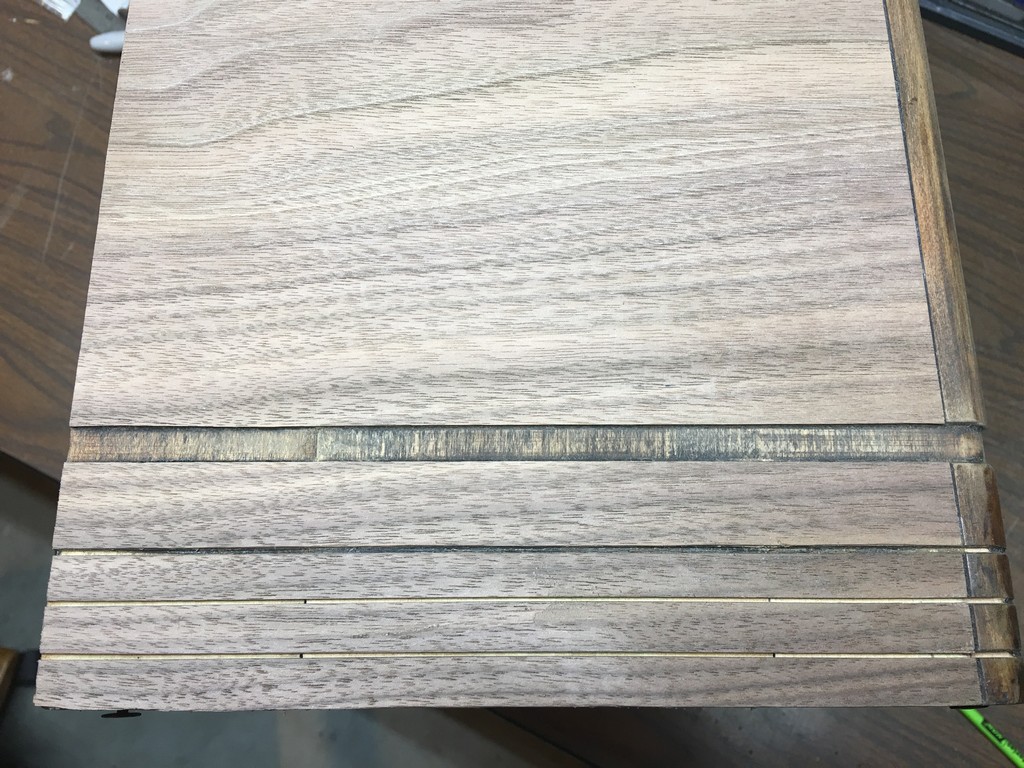

Now, that leaves the three thin strips on the lower right side which also need to be replaced. I have one of the original strips which will be glued back. As for the other two...I will glue one solid piece on and then cut a groove in the middle of it.
Posts: 5,650
Ron;
A thin saw blade should be able to cut out those grooves, such as a hack saw blade following a straight edge, unless you happen to have a veneer saw, which is unlikely. The reason I suggested putting these on in one piece is if you didn't you would go crazy trying to line up each strip, and trying to get the grain running in the right direction, it's also what they did in the factory when they built the cabinet many years ago.

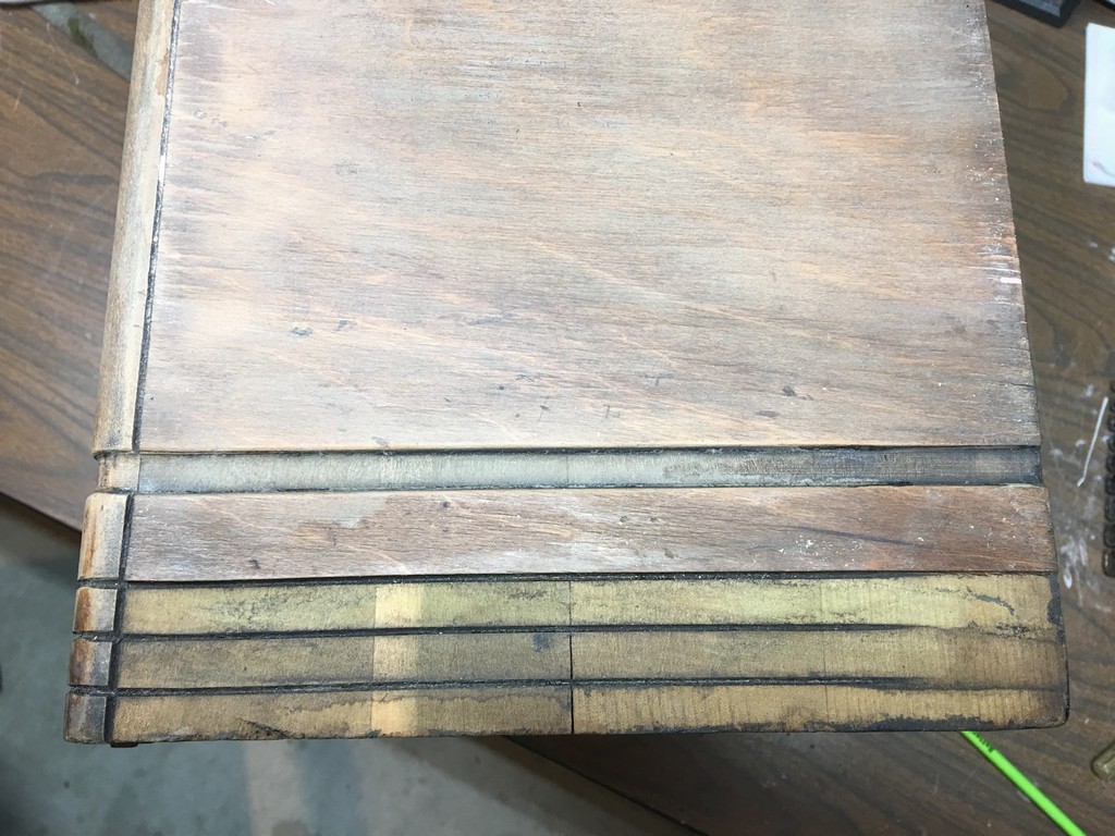

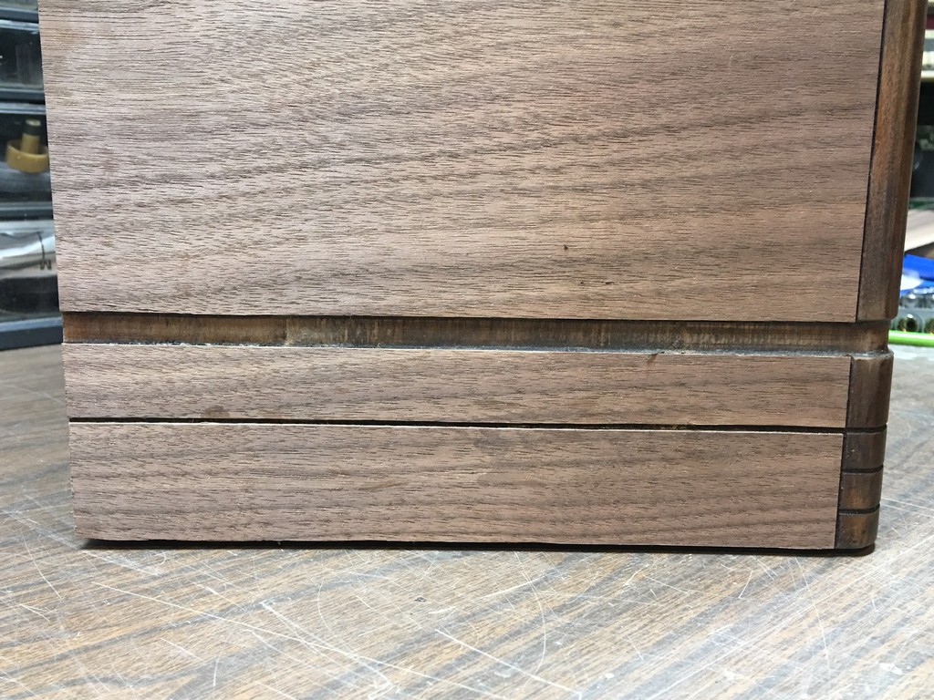

So this evening, I tried it:
[Image: http://www.philcoradio.com/images/phorum...-5_101.jpg]
It turned out perfectly, I think. The width of the hacksaw blade was perfect (or nearly so) for the job.
Now all it needs is the black lacquer in the grooves again and it will look "factory".

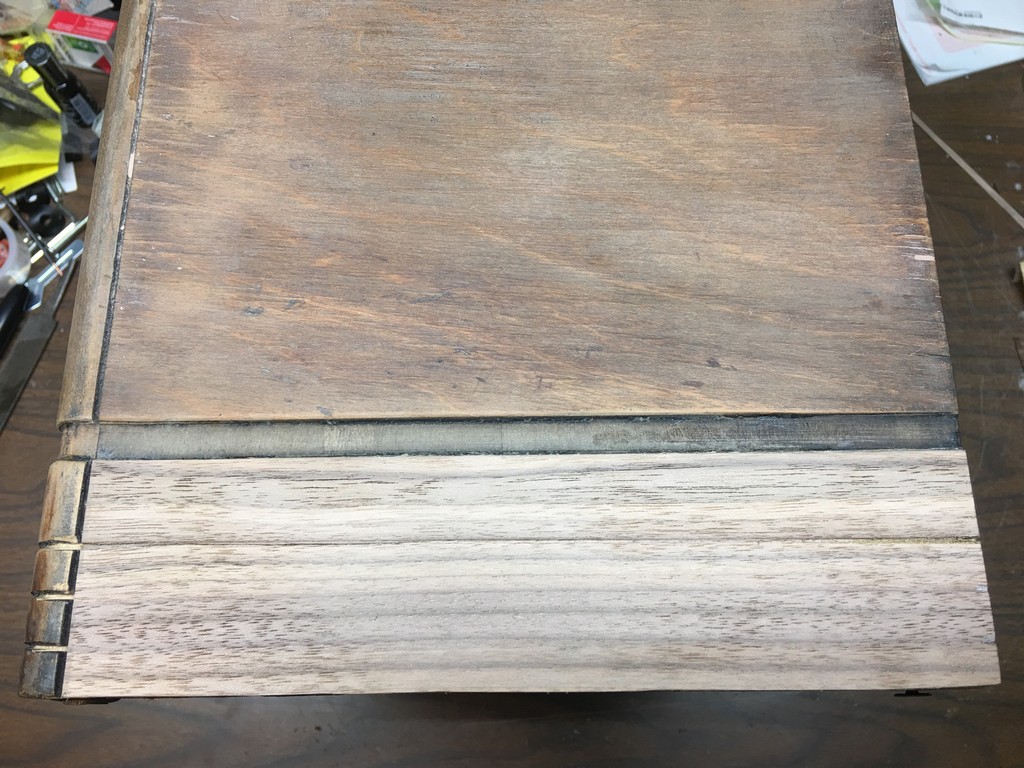

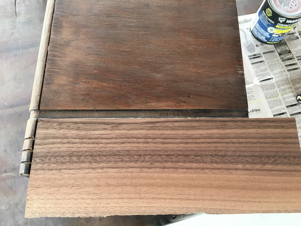

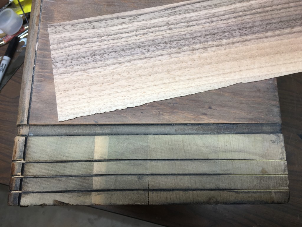

I decided to remove the loose strip of veneer and apply a piece of new veneer to the lower section of the right side of the cabinet.
Here is how it looked prior to applying the contact cement, with the replacement veneer properly cut and ready to apply:
[Image: http://www.philcoradio.com/images/phorum...-5_103.jpg]
I took the cabinet and veneer outside, and set up my folding work table. It wasn't raining but was cool and cloudy, looking as if it could rain at any time, so I set up shop under the carport. I opened up the can of contact cement and applied it to the cabinet where the veneer was going to be attached, and to the back of the sheet of veneer I was going to use.
After waiting the requisite 15 minutes, I carefully attached the veneer to the cabinet.
The contact cement does not immediately grab the veneer - it allows you the chance to properly position it first, which is a good thing!

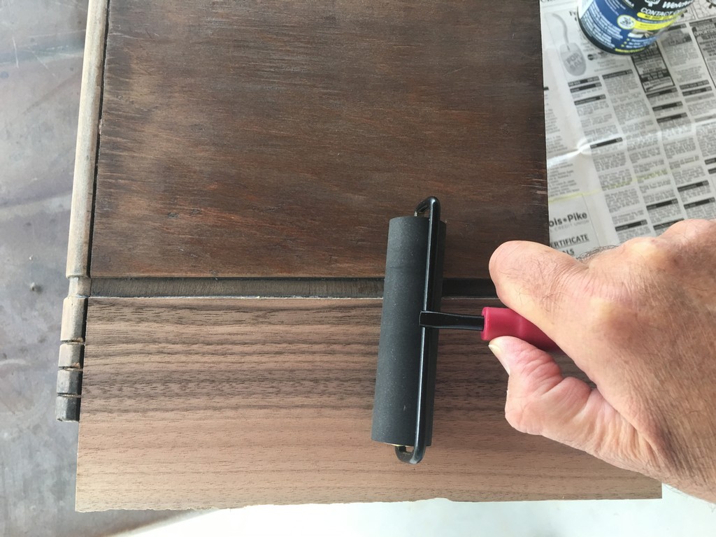

Once positioned, I pressed it down with one hand, then began to roll it out.
[Image: http://www.philcoradio.com/images/phorum...-5_104.jpg]
After rolling, here is how it looked:
[Image: http://www.philcoradio.com/images/phorum...-5_105.jpg]

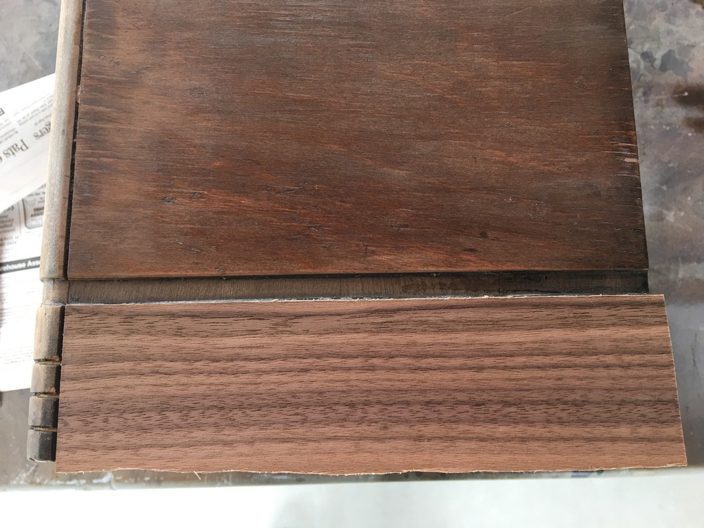

After rough cutting of the excess veneer:
[Image: http://www.philcoradio.com/images/phorum...-5_106.jpg]
Then, I took the cabinet inside and with a combination of more cutting and sanding, I had the new veneer fitting the contours of the cabinet. This is why it looks uneven along the bottom edge in the photo below - the bottom edge of the cabinet is uneven.
[Image: http://www.philcoradio.com/images/phorum...-5_107.jpg]
I started to cut one of the grooves before realizing that I needed to let the contact cement dry first. So the grooves won't get cut for a day or two.

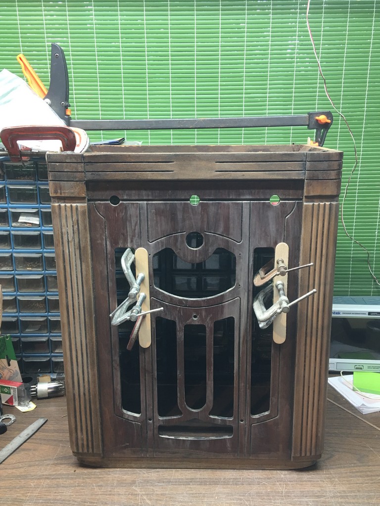

I've glued all of the spots which I had identified as needing to be glued down. Those also include the right front corner of the top veneer, and the lower front and back corners of the right side veneer. In those areas, I glued them the way I used to - by getting as much Titebond glue into the corners as possible, then ironing them down with an old iron.
Since I took the photo above this afternoon, I have removed the clamps only to find another spot needing to be glued which is the bottom front trim on the right side. That has now been glued and is clamped.
On the first decent outdoor afternoon we have this week, I hope to finish preparing this cabinet by cleaning a few remaining trouble spots in front with acetone. I will also cut those grooves in the bottom right side veneer, and apply a little wood putty in a couple spots that need it. And then next weekend (which is supposed to be sunny and cooler)...I hope to get this cabinet sealed and then apply the grain filler. I might just get this one refinished this year after all. We shall see.
