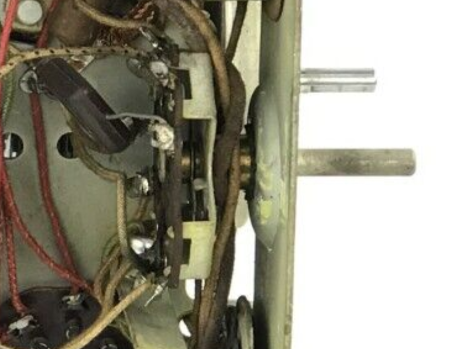

Though I do have 118, it would take me removing the chassis and look at the switch to answer you, but the main thing is, this is not even important, though I think, yes - the shaft is one piece all the way through the switch.
And it is unimportant, because there is no way in holy h..ll for you to make this move well again without extracting the shaft from the barrel. You do need to fully clean old lubricant. The diluting it with PBBlaster will allow it to move some eventually (maybe?), but is not the full solution: the full solution is 1) remove the shaft altohgether (whether or not you have to remove the switch, is another matter, but I think you may have to), 2) clean the barrel fully of the old lubricant, 3) same for the shaft. 4) apply the new lubricant and re-assemble.
THis is the switch, it is 1 wafer.
I cannot see the back of it, so I am not sre if you could maneuver the switch so that it would be able to be pushed out without tremoving the switch and then removing the rotating contact first and only then pushing the shaft out after heating. But it should not be too bad, it's just 1-wafer switch.

I appreciate your help. The switch you pictured is a little different from mine which does have a 2nd piece of wafer material on the back The thing is how do I disassemble the switch? The outside shaft seems to have I don't know a collarwhere it enters the bushing and it does not allow it to be pushed thru to the back. Normally I would expect a c clip between the bushing and the shaft but I don't find one. So I don't see how the shaft can be removed or the bushing removed.

I just looked at my 18/118 chassis. There is a steel ring at the front of the shaft where it meets the bushing. At the back of the shaft there's a washer is peened that holds the wafer in place. Don't think you can get the shaft out without taking the wafer with it.
I would clamp a pair of vise grips on the shaft and push it towards the right (CW) little by little rocking it. But I'm a brute. I would assume it's set to the broadcast band. You wouldn't want to push it to the left as you could break the stop or the switch.
