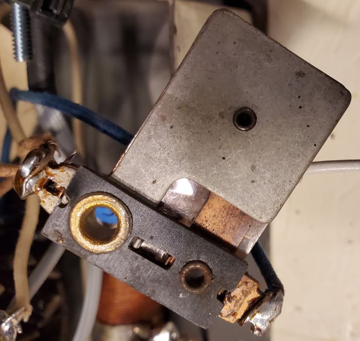

I have traced the wiring to #47 and it shows like the schematic. There is no hole in the back of the chassis for that and there is no adjustment nut or screw either.
OK, it was just a thought as it looked similar to me like a trimmer for alignment purposes!  Icon_thumbup

It sure does. Only there is no hole.
Dconant
Here's the idea: if you haven't done so already (I am lazy to go and re-check), desolder one lead of that "trimmer" and measure the capacitance. I bet it won't be any close to a few nanofarads. But...
Mike I did that already and can't really get any kind of reading. My little Honeytek A6013L reads 0 on all scales. One schematic say it is .001 and another with a resistor in series says it is .006 and another schematic says it is a .006 without the series resistor. I will dismount that cap/trimmer so I can take a back side picture of #47.

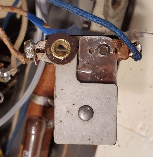

Here is the cap in question. Both front and back pictures. With my CCC it reads 1.094 nf. So .001 then. Now I'm stuck on calling my meter CCC.

Also, if the meter measures Farads, then it should also have that "Delta" button where you nullify the capacitance it shows when the leads are just hanging. (Fluke does).
This way you will now the true capacityance.
While I am surprised this thing is a 1nF, but that at least explaines its existance: the padders do not go into that range.
