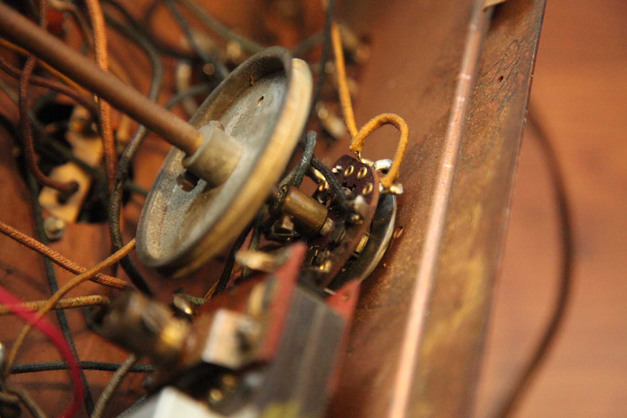

Just realized the tone control packet switch (the one on top) is broken. A cap came off of one of the tubes, and one was marked as "bad" by someone. I'm sure few more tubes are probably bad.

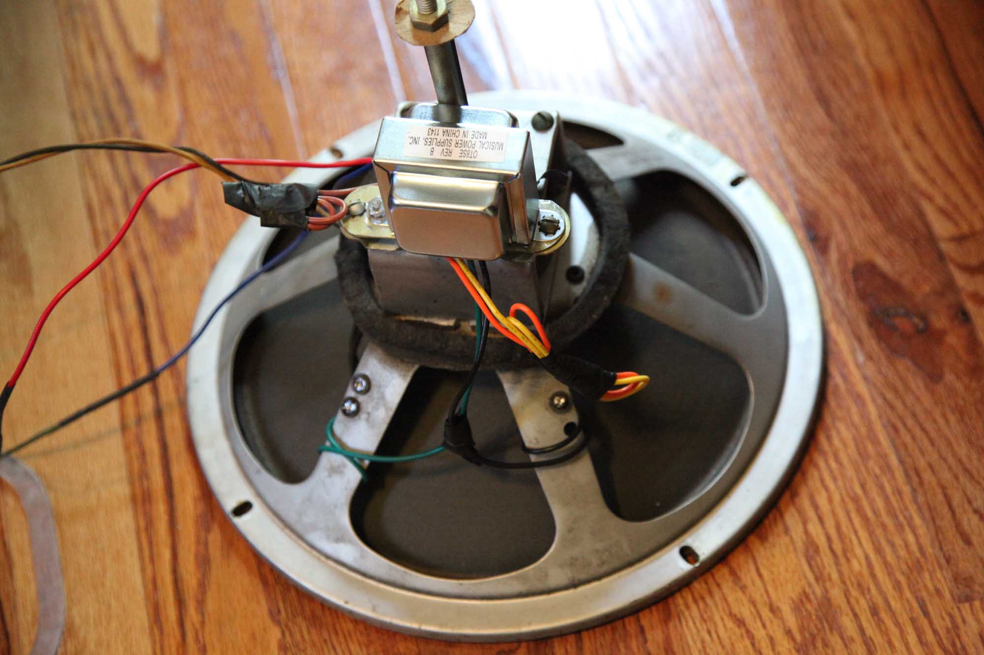

Installed the transformer onto the speaker and stuffed the cap - it looks nice and has whopping 11 Chinese microfarads inside it, rated at 700V.

The transformer I bought fit in nicely and it seems to be a very good match, with 7K impedance and 3 Ohms coil matching, plus 10 Watts rating, and with all this it is the size I need.

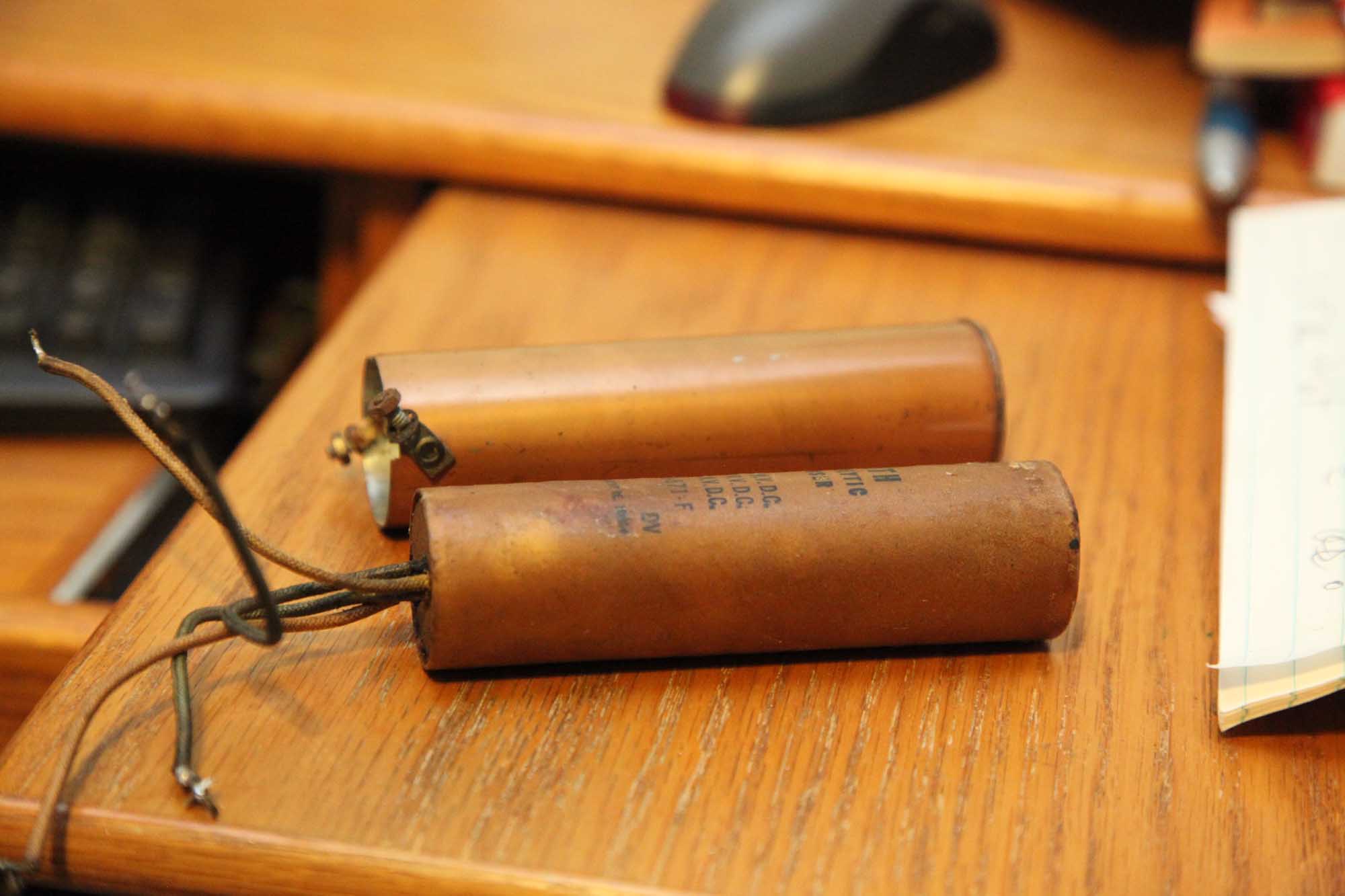

Some pictures of the cap and the speaker.
This is the speaker with the new XFMR.

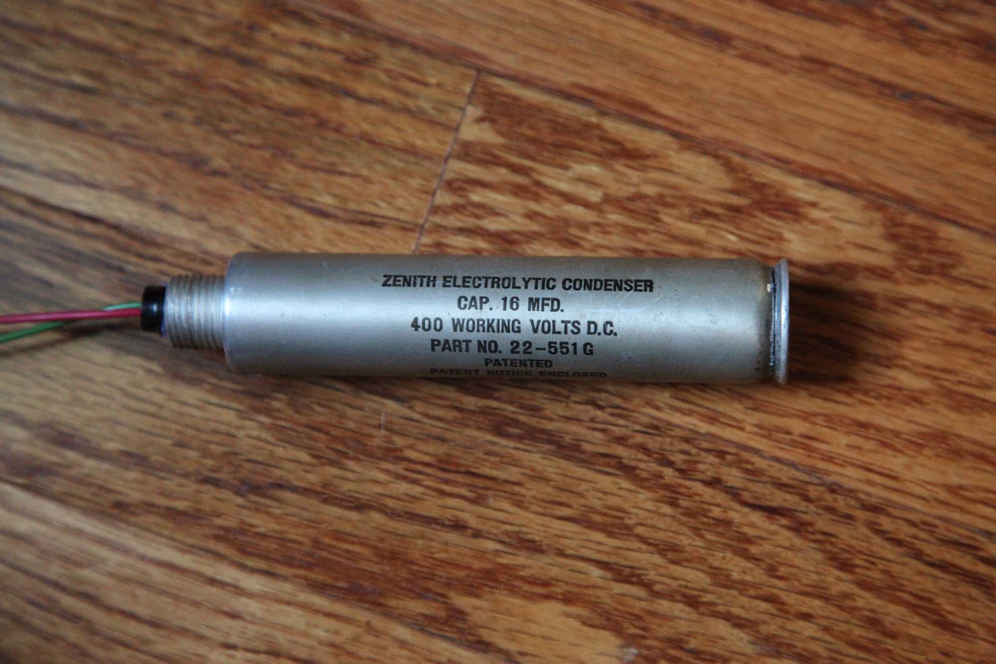

These are the stages of restoring the cap I was dreading.
Well, every cloud has a silver lining: to fix the cap I needed to buy a glue gun, so eventually I got me one. And a trip to Lowes is always pleasant.
Leave the wife and kids for 1/2 hr and go walk between the aisles of instruments.....
Also bought a staple gun - at some point I want to stretch that cloth on my Philco 20.
And all because of an old 16uF Zenith cap

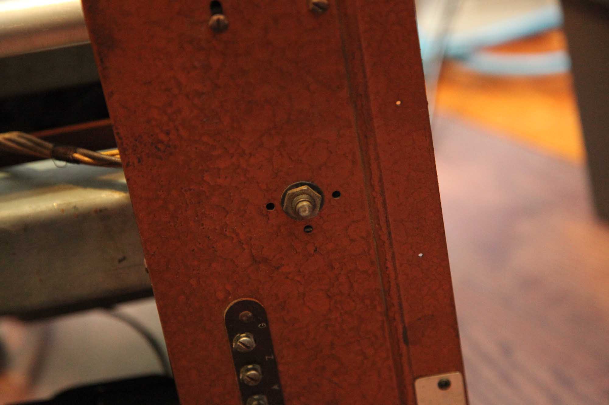

Do you have a pic of your band switch? Where is the set screw located on the switch? Mine is missing and I am looking for a replacement.
Gene
Gene,
I'll take a shot first thing when I come home this evening, and will post it.

Gene,
Here it is, if this is what you meant.

Sorry my error.  I was talking about the band switch lever but I guess I now know it has the set screw on the side of the lever and not on top like I originally thought.
Thanks for taking the time to get the pics.

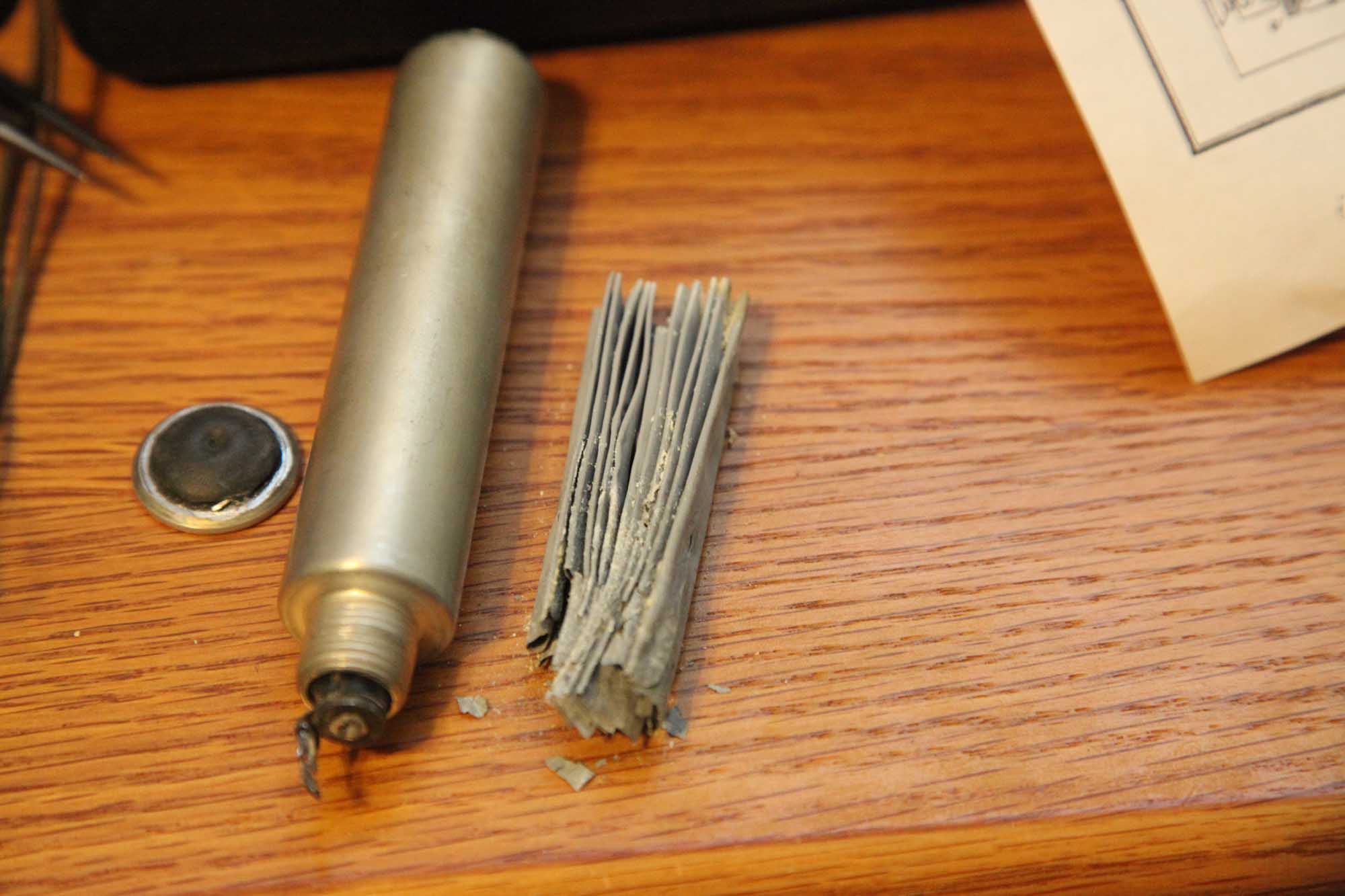

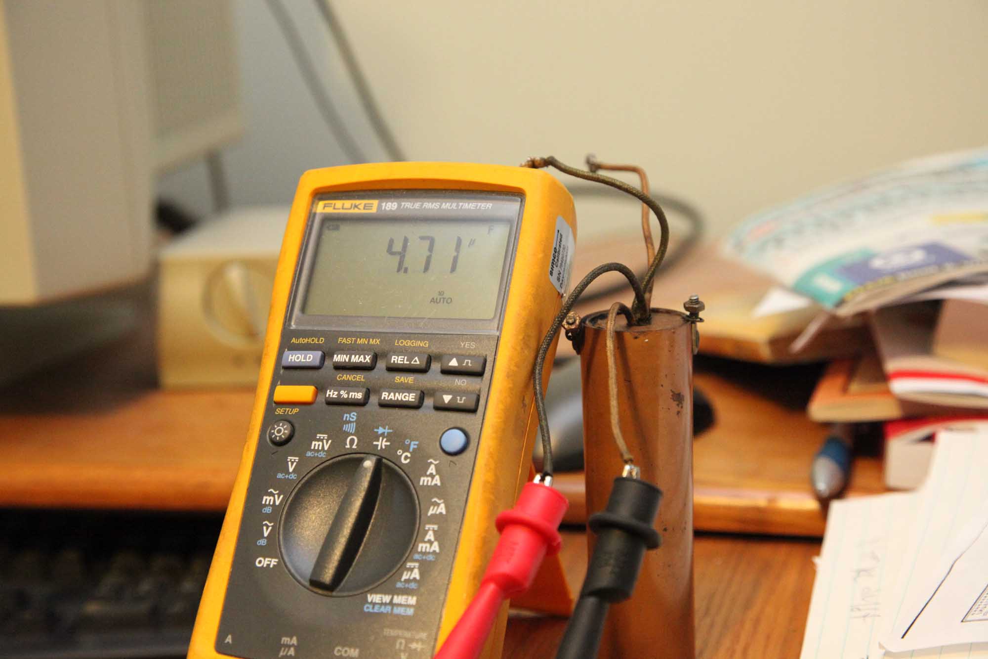

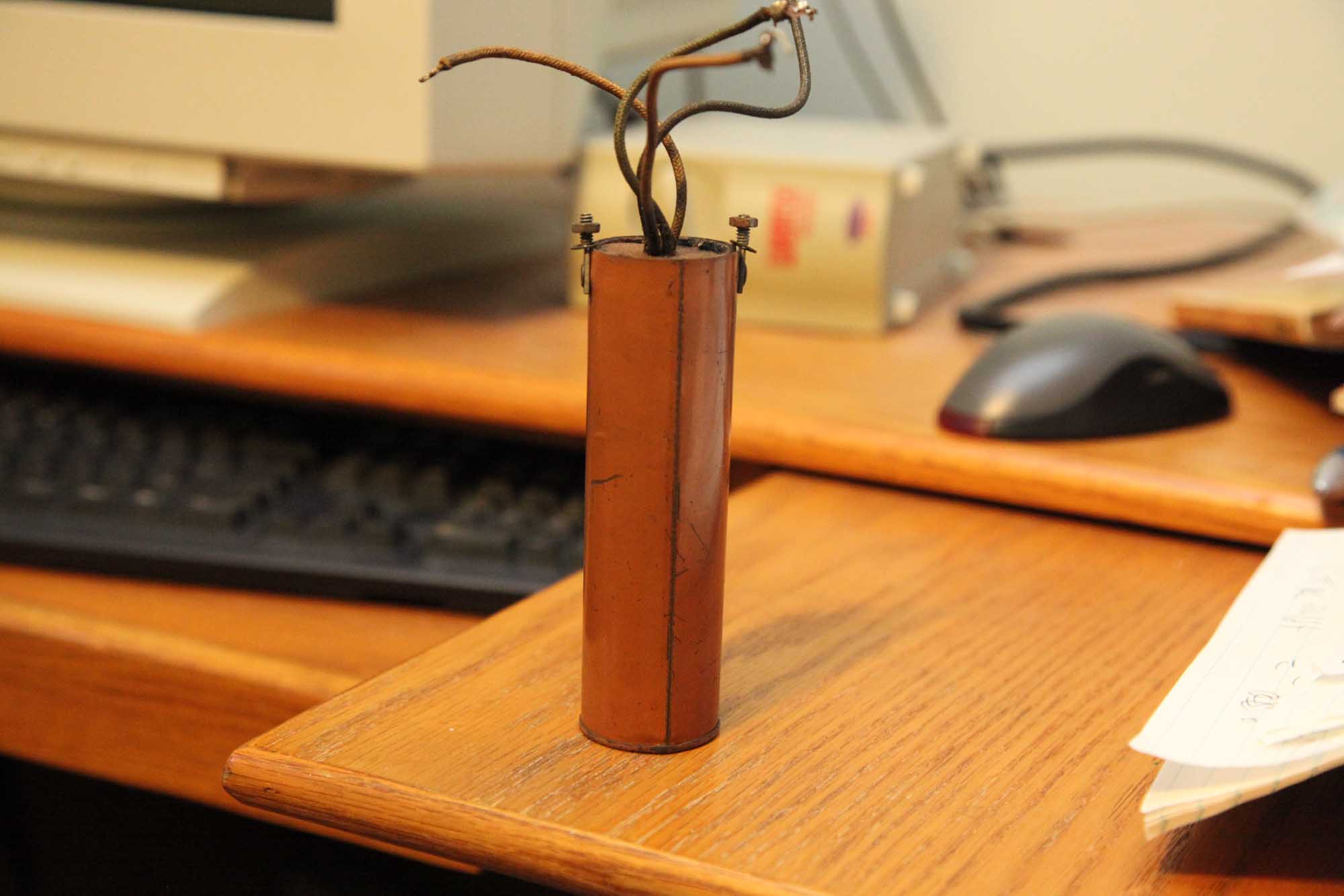

Here's a triple electrolytic capacitor i restored.
This is the cap.

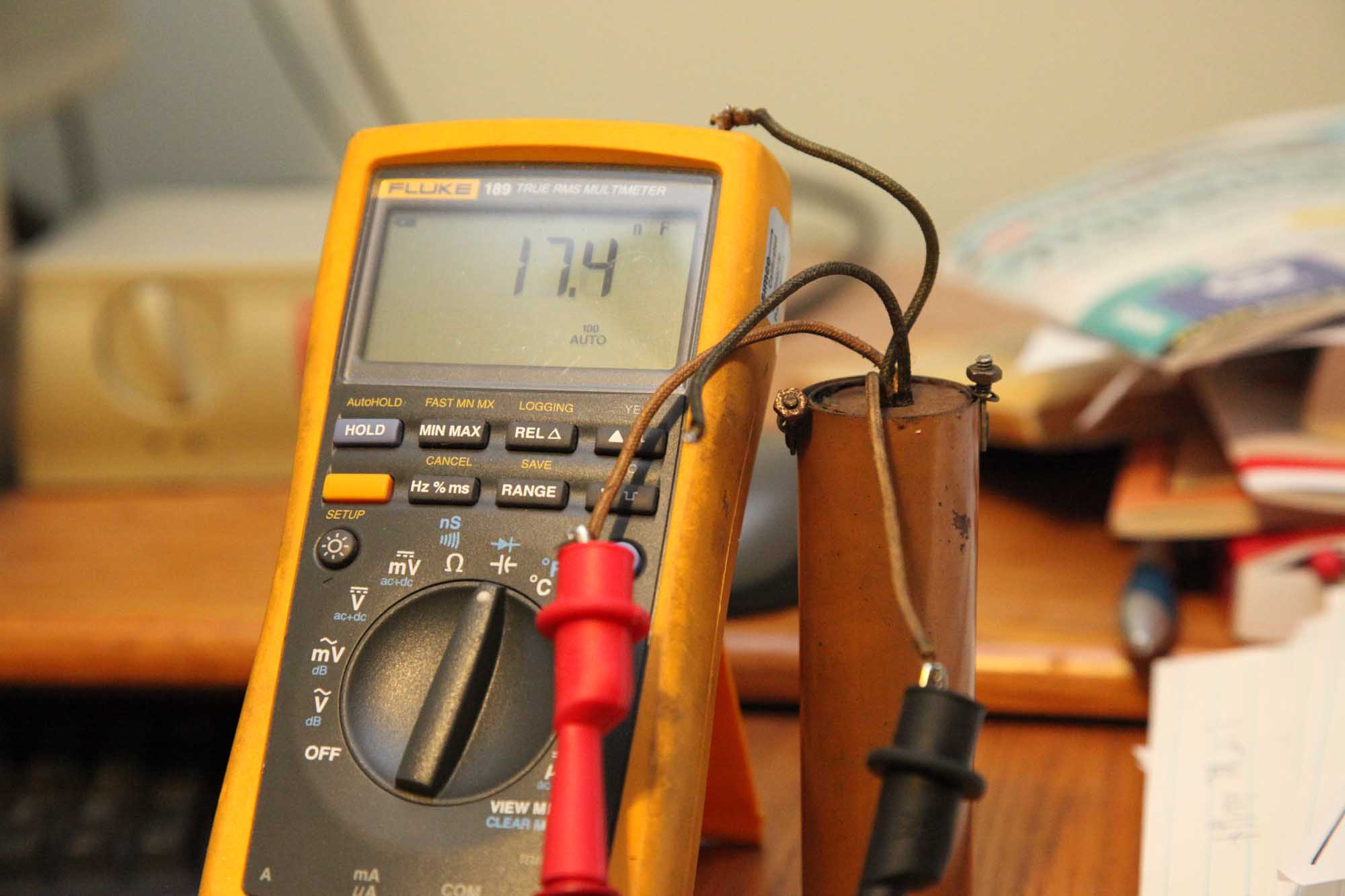

One of them tests fine.
And another one
But the 10uF one is dry.
So I have to take it apart.

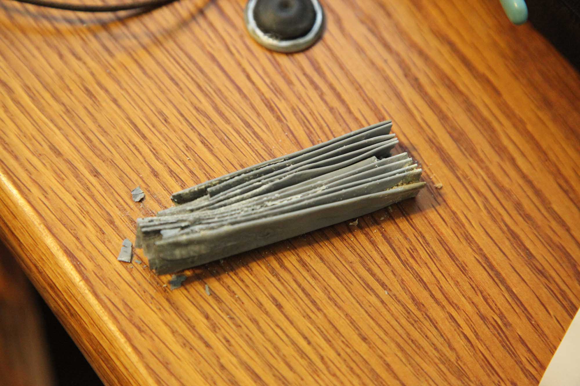

The cartridge comes out easy.

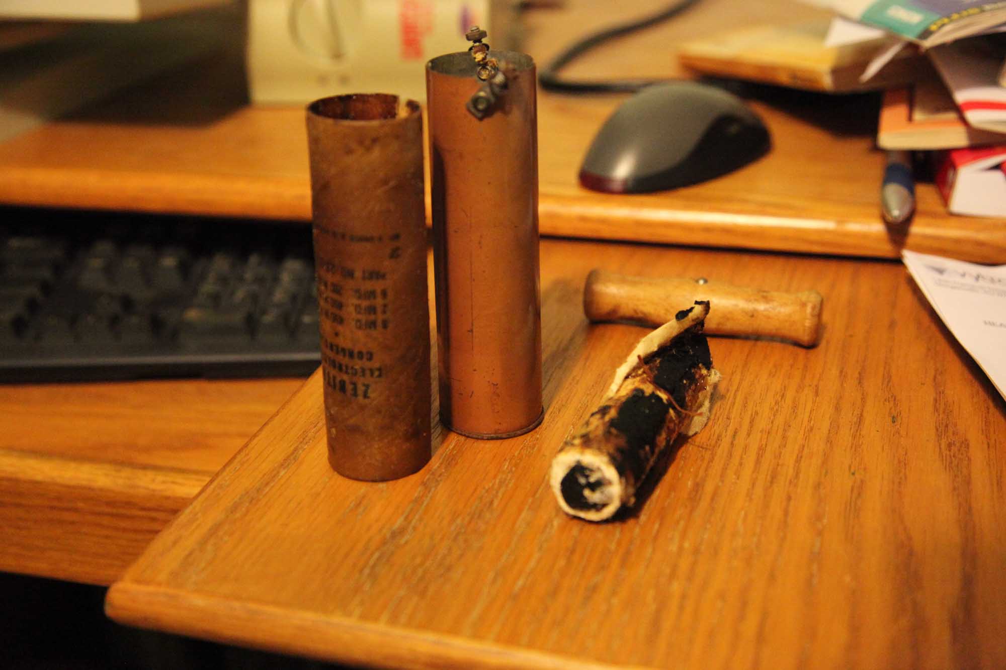

And then we use the corkscrew.
Success!
The rest is as usual.
I put the caps in the paper cartridge and saved some tar inside and some chinks for the later use. Potted the caps with hot glue, put the tar or top and melted it with Milwaukee gun. Put the paper lid with the hole back on top - looks indistinguishable.

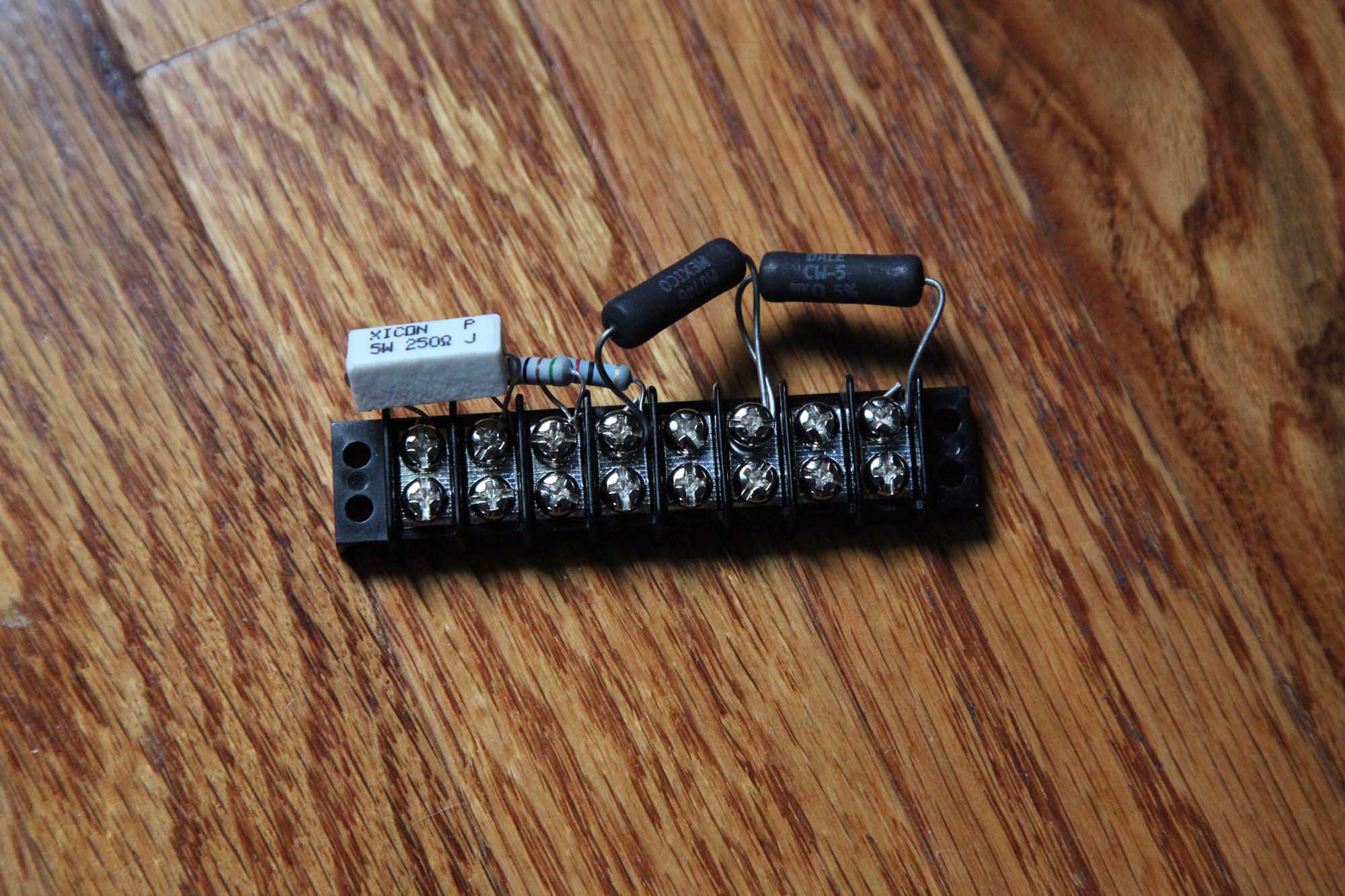

And the Candohm replacement.
I did not go fancy on it - a terminal screw strip and resistors. The wattage came from the Rider Manual, and got multiplied by 4 or 5 due to no heatsinking. all 1-watters became 5-watters, and 1/4 watters became 1-watters.

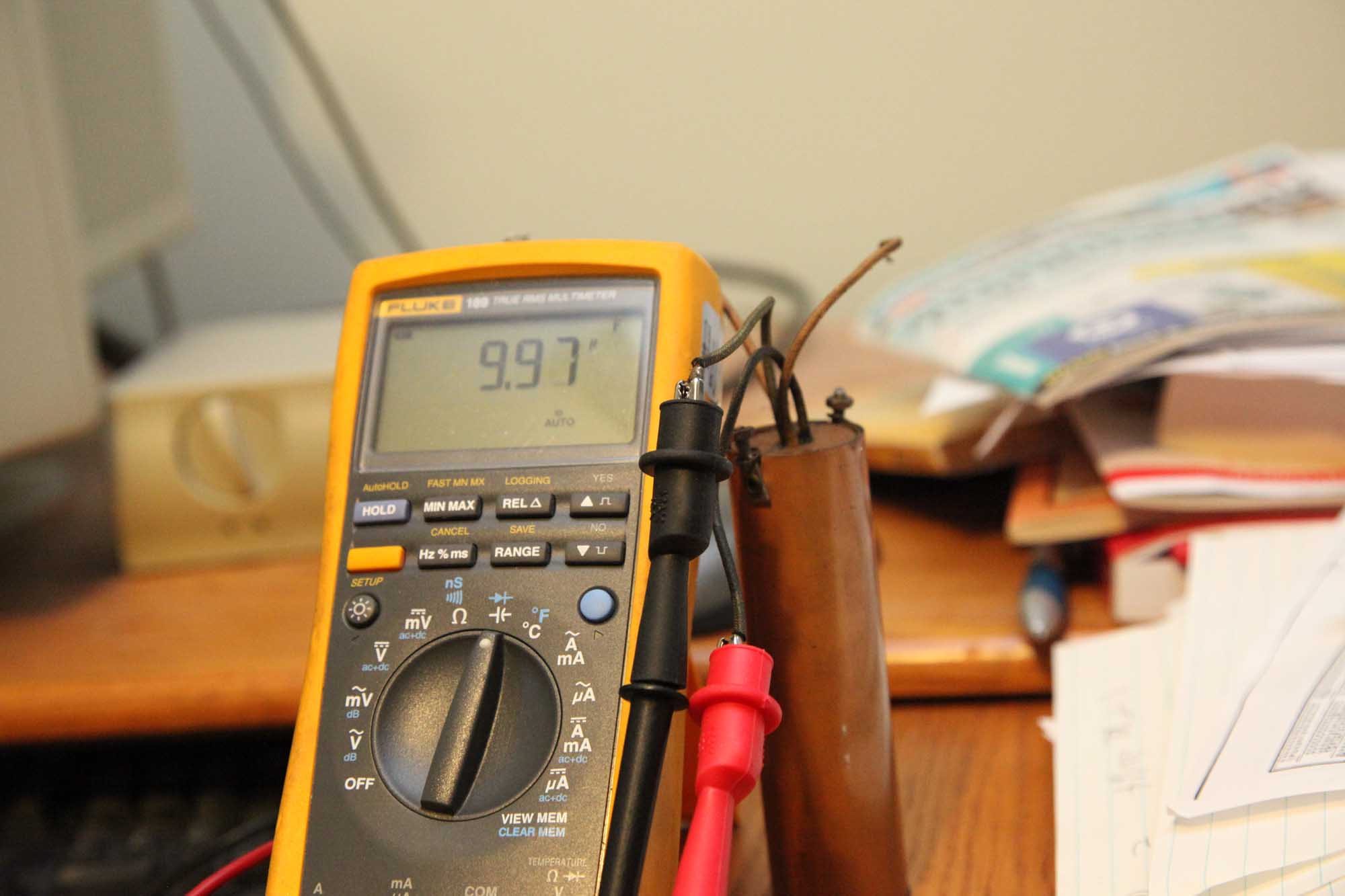

Good news, the XFMR seems to work, the secondary being about 700V (it is centertapped, so it will be half), the filament 6V, and the motor running. Have the dial light bulb bad, but I think the winding will be OK. (a separate winding for dial light).
