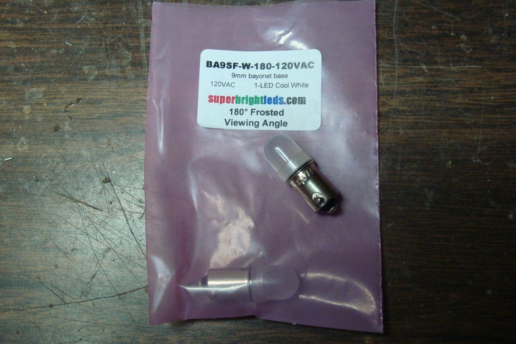

Quote:John, I am planning to try a BA9SF-W-180-120VAC LED from superbrightleds.com:
Ron, a 120 VAC miniature bayonet base LED lamp is well worth the minimal cost to see if it fits your needs. I think these new LED miniature lamp replacements have a lot of potential, but that is the first time I've seen a 120 VAC mini based LED in a bayonet base .. be sure to keep us posted.
I certainly will, John. I expect to be ordering the lamp - and the needed power resistor and electrolytics - by this weekend.
Well, I've ordered the necessary parts - two 120 volt LED lamps from superbrightleds.com , and the resistors and electrolytics from Mouser. I also ordered one extra chassis mount resistor and a few 1813 lamps (14V, 100 mA) in case the LED is not to my liking - this way, I can go back to the original design if need be.

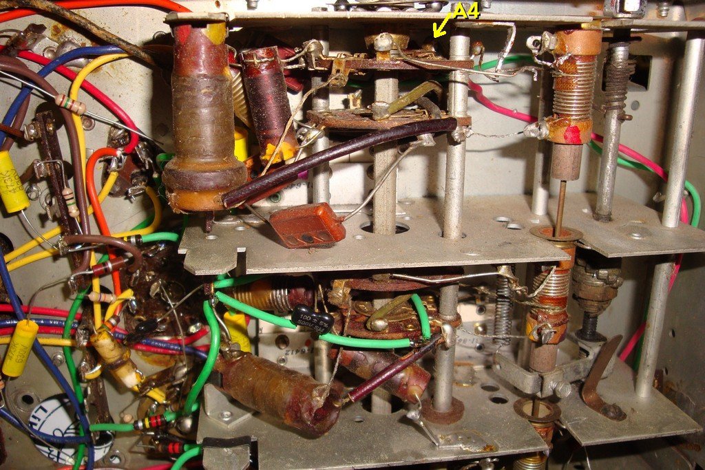

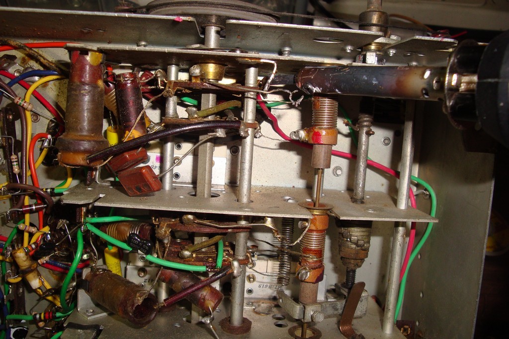

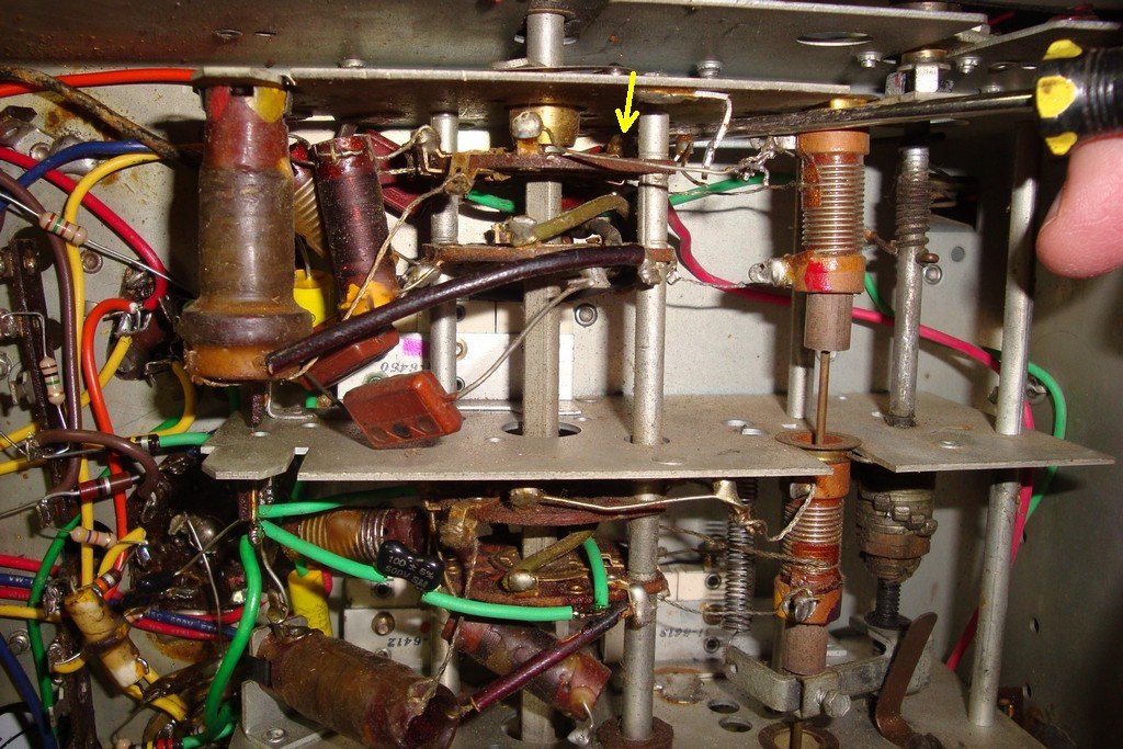

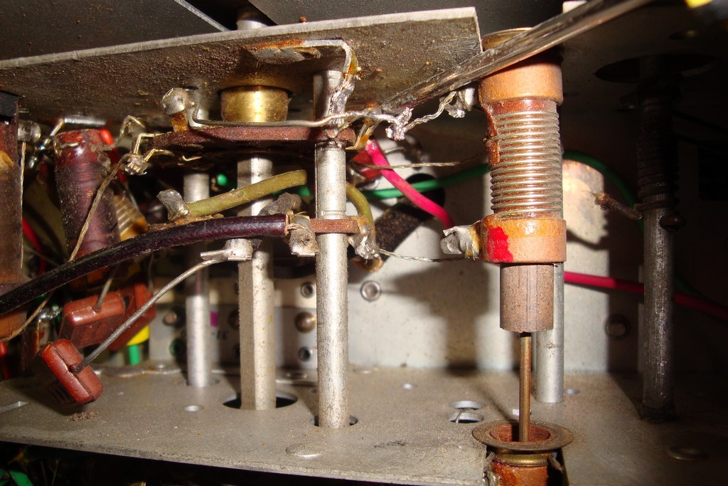

The following four photos will hopefully illustrate what I am up against if I even wanted to replace the wire - which I have decided not to bother with.
[Image: http://www.philcoradio.com/images/phorum...e6a854.jpg]
This photo shows part of the band switch assembly. The yellow arrow labeled "A4" is pointing to terminal A4 on the front wafer, which is difficult to see not only in this photo, but the others to follow. This is the terminal from which the wire came off.
[Image: http://www.philcoradio.com/images/phorum...af04e3.jpg]
Another view of the same area. Here, I am holding a small flat-blade screwdriver; the end of this screwdriver is resting upon terminal A4 which is barely visible. You will notice a coil to the right with a slug in it - this is part of the set's permeability tuning assembly. I removed the clip holding it in place last night only to discover that the slug will not allow the coil to be removed. Therefore I am not going to force the issue. If the coil could be removed and moved out of the way, I *might* be able to reach A4 with a soldering iron.
[Image: http://www.philcoradio.com/images/phorum...a3f3ab.jpg]
Another view with the end of the small screwdriver resting on A4, which can't even be seen here.

I have a dual 15/40 watt Radio Shack pencil soldering iron. It is off and cool here, but you can see that it is too big to fit down in there where it would need to go. It would burn up coil (6), the "band spread" antenna coil, before it ever reached A4 - and, besides, the tip is too short to reach A4 anyway due to the cramped quarters here.

Meanwhile, my LED bulbs were scheduled to arrive on Monday (4th) - they arrived today!
[Image: http://www.philcoradio.com/images/phorum...120eaf.jpg]

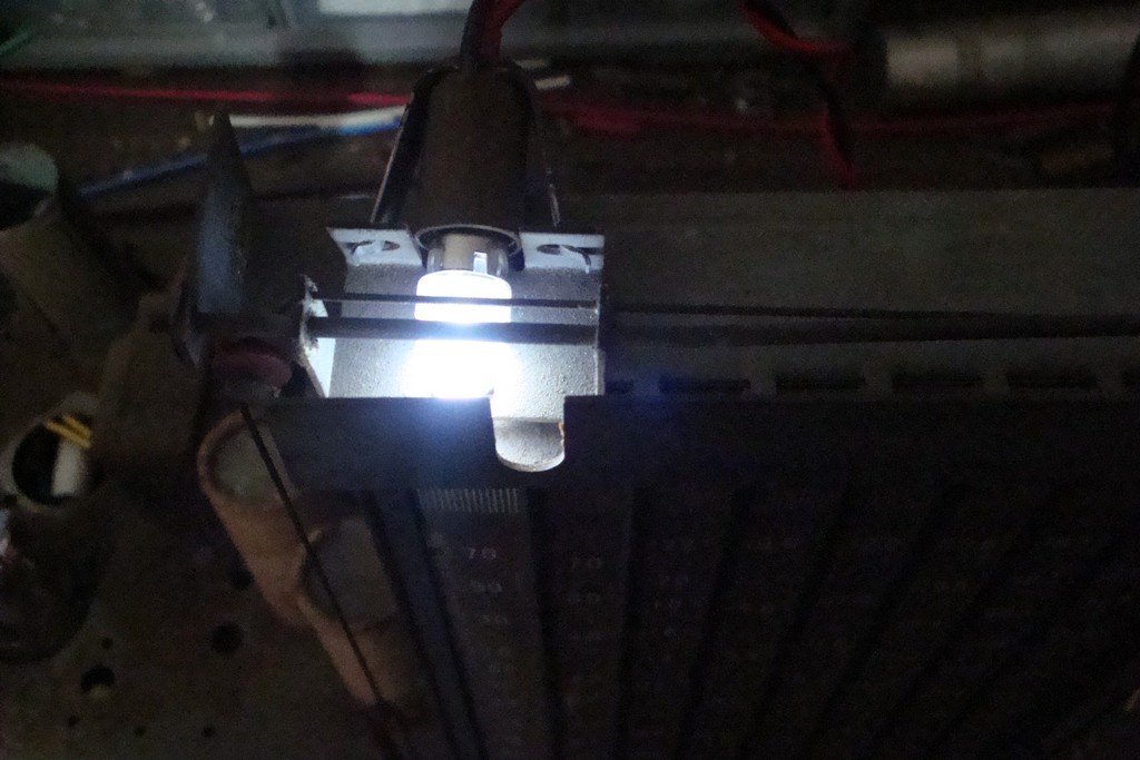

I quickly rebuilt the dial lamp and attached a power cord. Installed one of the two 120 volt LED lamps, and tried the radio out with most of the tubes removed since I am still waiting on the new electrolytics:

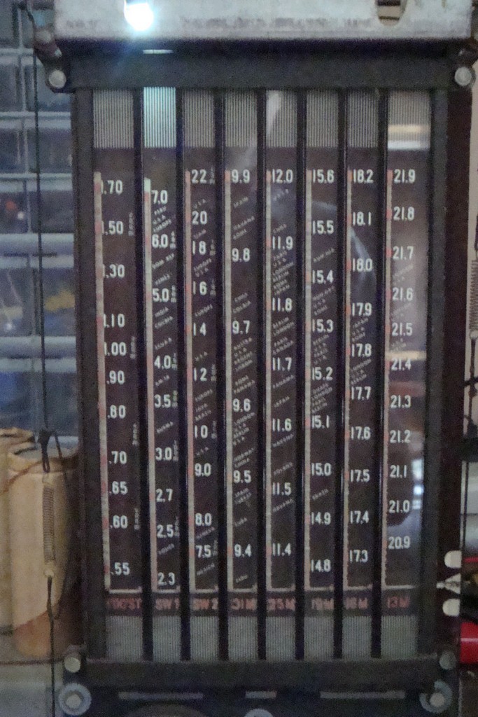

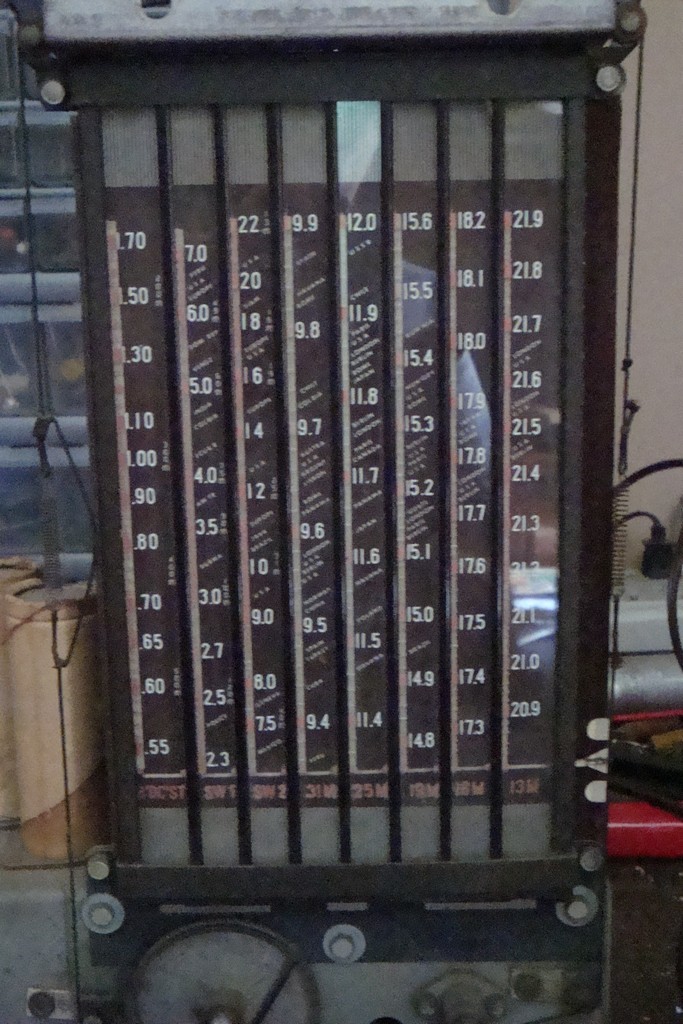

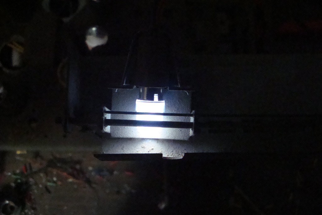

It isn't real bright. The previous two photos, as well as the next three, were taken with the lights out in the room and only a little bit of light coming in from the window off to the right of the photos. The camera automatically compensated for the low light, so it looks like more light is in the room than there is. ( Edit: The camera's compensating for low light also makes the LED lamp look much brighter than it really is.)
[Image: http://www.philcoradio.com/images/phorum...29937d.jpg]
AM or "broadcast" band (band 1)
[Image: http://www.philcoradio.com/images/phorum...ba79b0.jpg]
2.3 to 7 mc SW (band 2)
[Image: http://www.philcoradio.com/images/phorum...4153e6.jpg]
25 meters (band 5)
You can just see that each band is illuminated, but barely.
I might just leave it in place and try it inside the cabinet once the electrolytics arrive and I install them and (hopefully) get this set going. If I don't like how the LED light looks with the set in the cabinet, I'll convert it back to use the 14 volt lamp.
