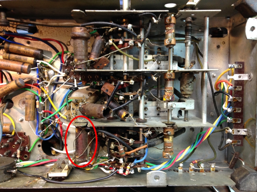

No doubt about it - the AM oscillator coil is bad.
[Image: http://www.philcoradio.com/images/phorum...88_044.jpg]
The culprit is identified above with a red oval around it.

The same coil is used for the AM band and for the second band, SW 1 (1.5 to 2.6 mc). It is a single tapped winding, and is open between the top of the coil and the tap. From the tap to the bottom of the coil, it is OK.
I am hoping that I can rewind this coil and make it work again.

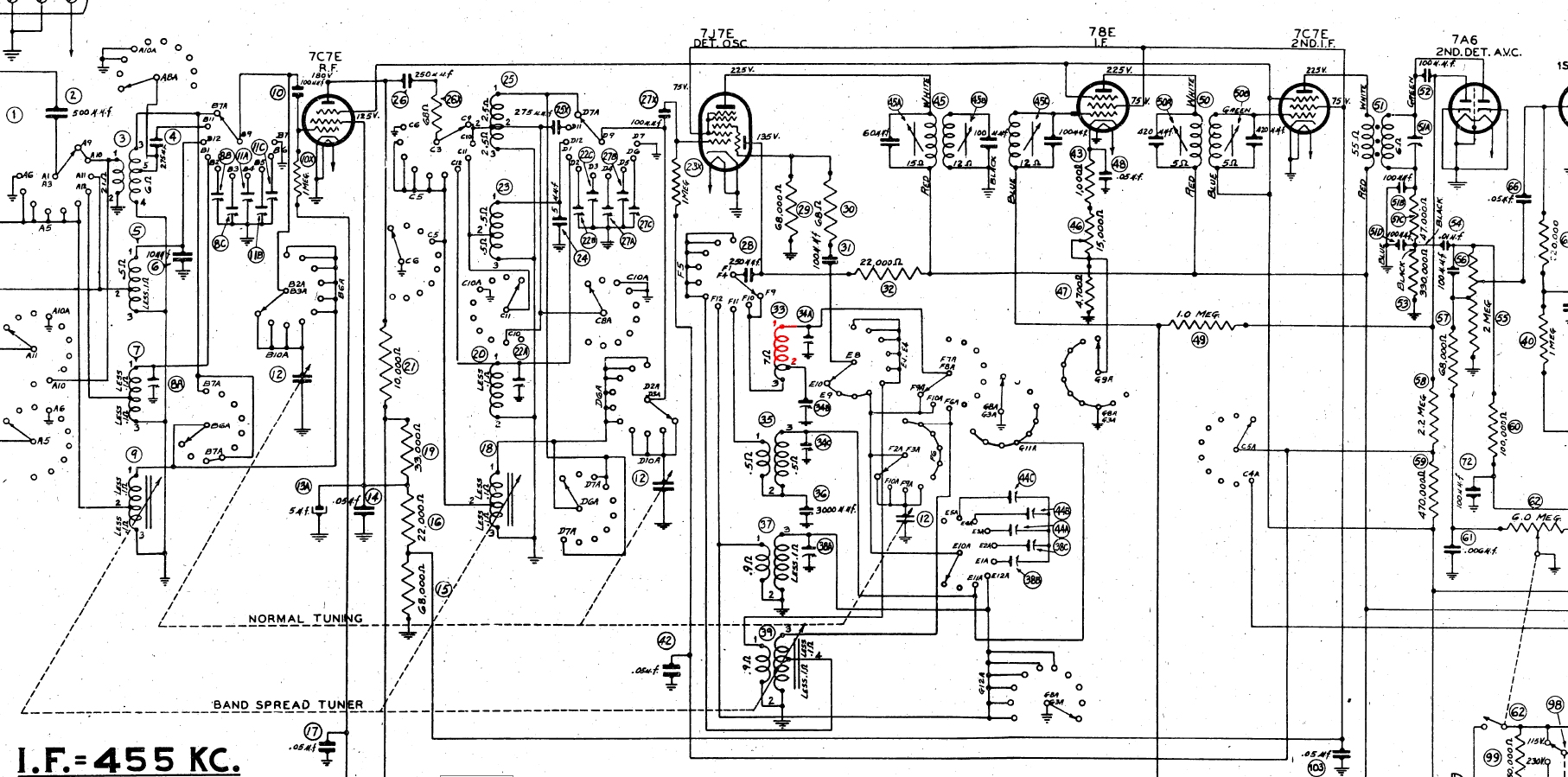

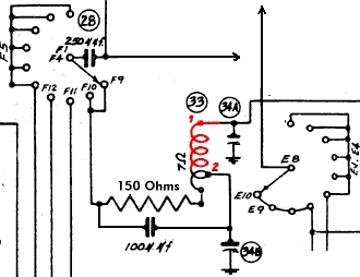

Take a look at a partial schematic here (opens in new tab, click to enlarge if necessary depending on your monitor size). It shows the coil in question in red.

If you look at the partial schematic and compare it to the photos above, you may notice an extra mica capacitor and resistor. This was a production change:
[Image: http://www.philcoradio.com/images/phorum...88_rev.jpg]
This 42-788 has the changes. The 100 pF cap is new.
Of course, that won't fix an open winding on a coil.

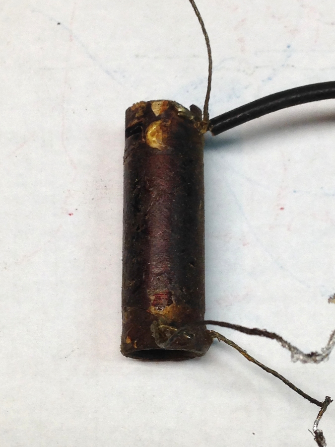

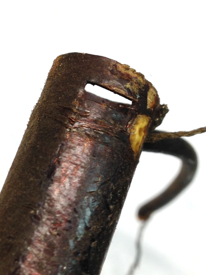

I had noticed what looked like a broken wire near terminal 1 of the coil before I removed it. After removal, it was readily apparent:
[Image: http://www.philcoradio.com/images/phorum...88_047.jpg]
It looks like something hit this coil, or scraped across it, causing a wire to break.

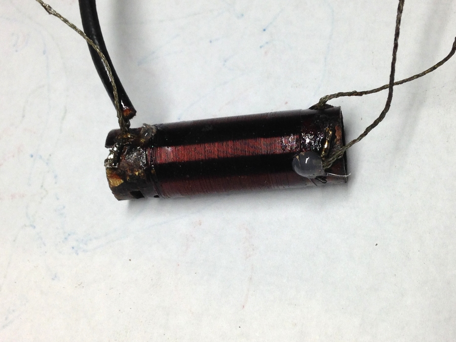

I carefully went over the coil with a heat gun to remove most of the old wax in order to see things better.
As it turned out, it was broken only one turn from the beginning. I unwound a few more turns just to see if the wire broke where it had been hit or scraped; the wire did not break, so those few turns were rewound and I soldered the end back to terminal 1.
After securing both the beginning and the end with hot glue, I went over each end of the coil with clear nail polish to hold the windings in place.
Afterward, it looked like this.
[Image: http://www.philcoradio.com/images/phorum...88_048.jpg]

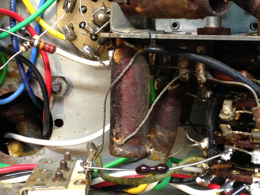

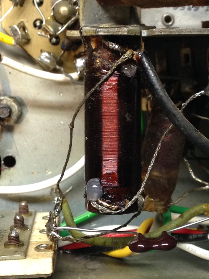

I kept checking the coil with the ohms function of my DMM to make sure it was OK. I checked it over a final time after it was back in the radio.
[Image: http://www.philcoradio.com/images/phorum...88_049.jpg]

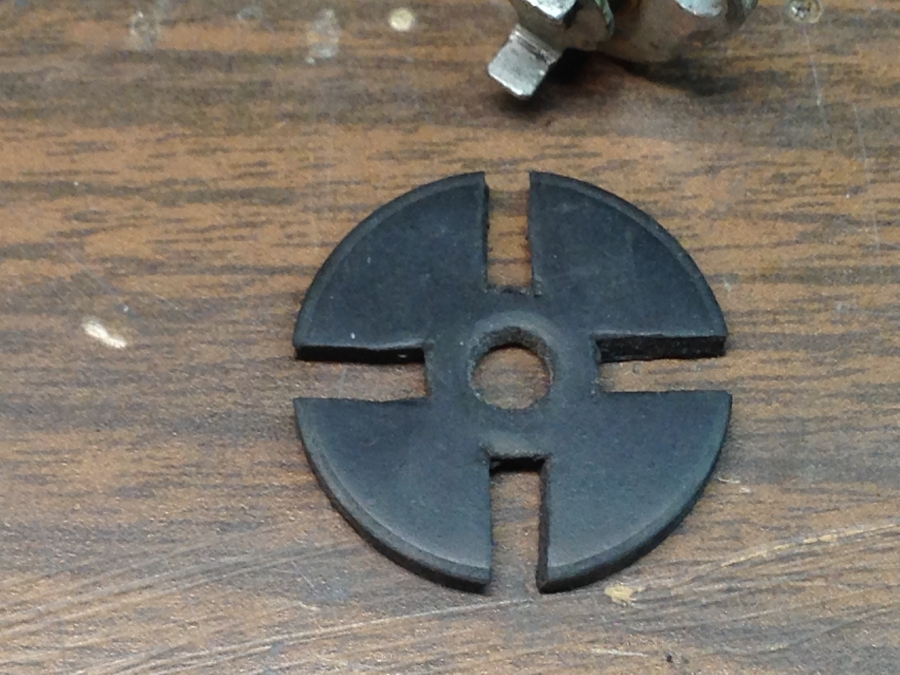

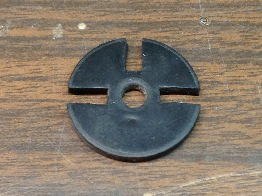

I aligned the left side of bands today. I can't find the other rubber discs I bought when I had to perform a similar repair on my 42-761EZ's dial drive. I must have lost/misplaced them in our 2013 move. So, anyway...the right side dial, which is controlled by a separate tuning control which needs a piece of rubber just like the one I made for my 42-761EZ, will have to wait to be aligned until I get another rubber disc and cut it to fit.
So, armed with a new rubber washer, I proceeded to cut another coupling.
[Image: http://www.philcoradio.com/images/phorum...88_051.jpg]
[Image: http://www.philcoradio.com/images/phorum...88_052.jpg]

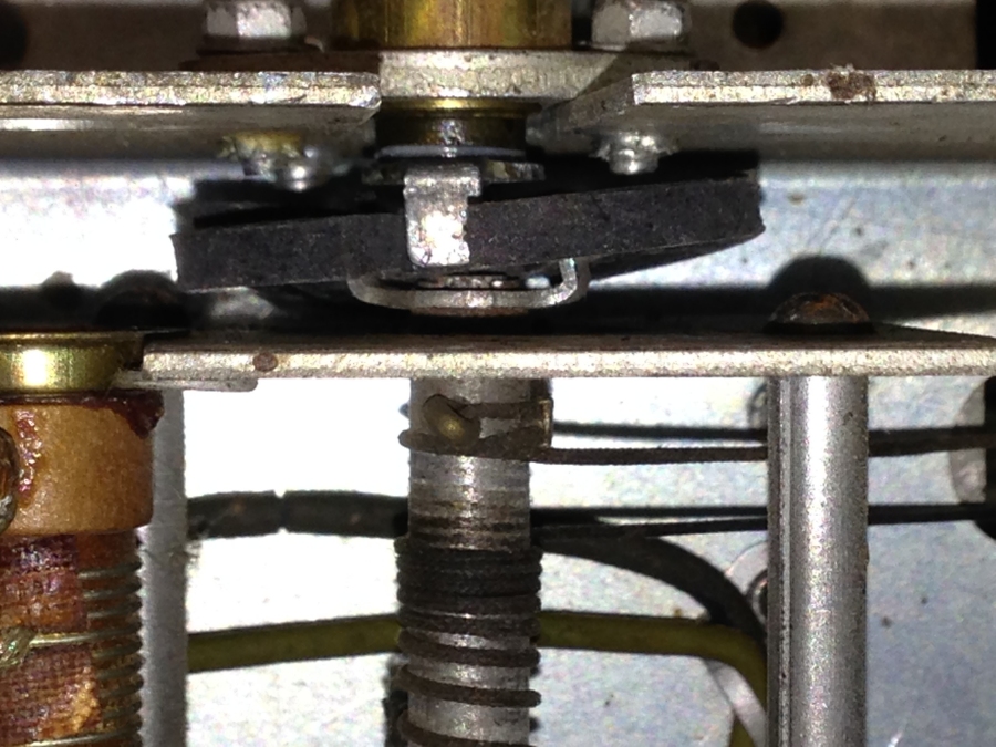

It was a pain to get the washer installed into the dial drive under the chassis, but I finally managed.
[Image: http://www.philcoradio.com/images/phorum...88_053.jpg]
I noticed when I removed the outer tuning shaft that it required some force to turn the shaft. So I removed the "C" retainer and pulled the shaft from the bushing. I cleaned it up, added some white lithium grease, and reinstalled into the bushing. Result: It turns very easily now. And with the new rubber coupling, the right side tuning works very well indeed.
I had to glue the pointer together, I shall see tomorrow once the glue dries how well it holds together. If it is OK, I will install the pointer and proceed to align the right side dial (five bands). Once that is done, the chassis will be complete.

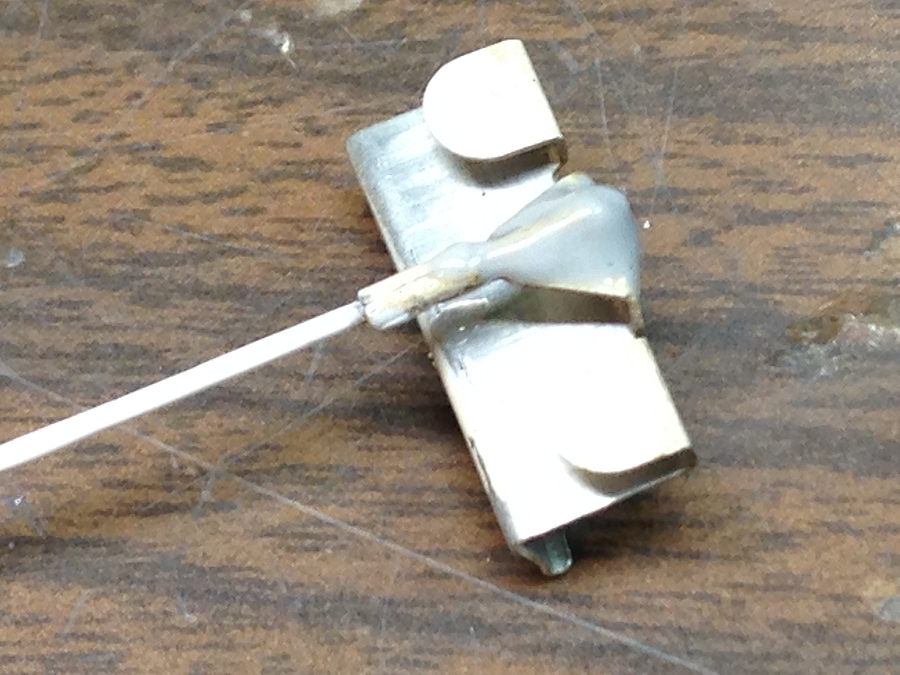

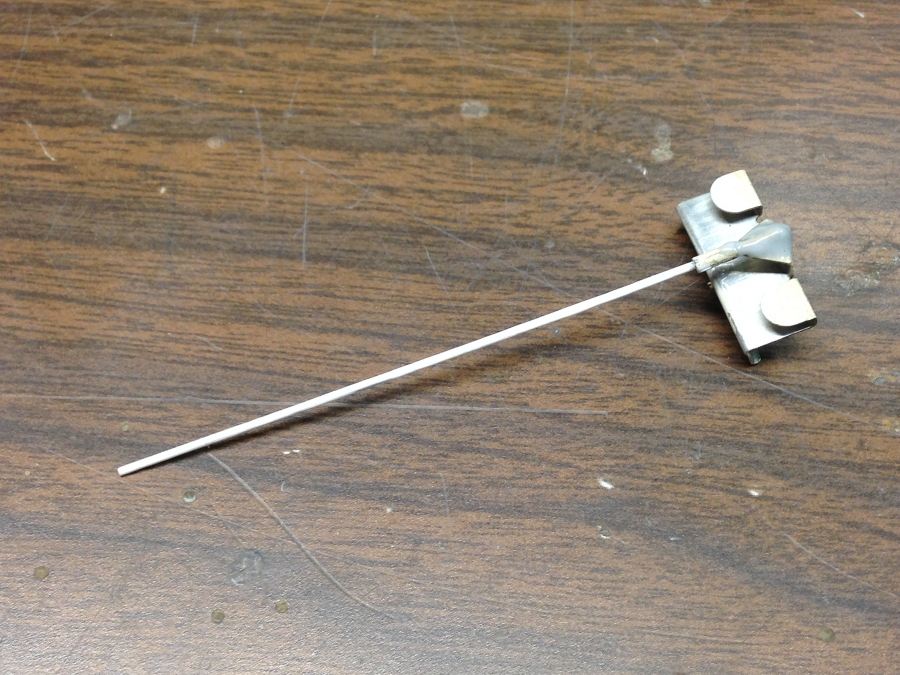

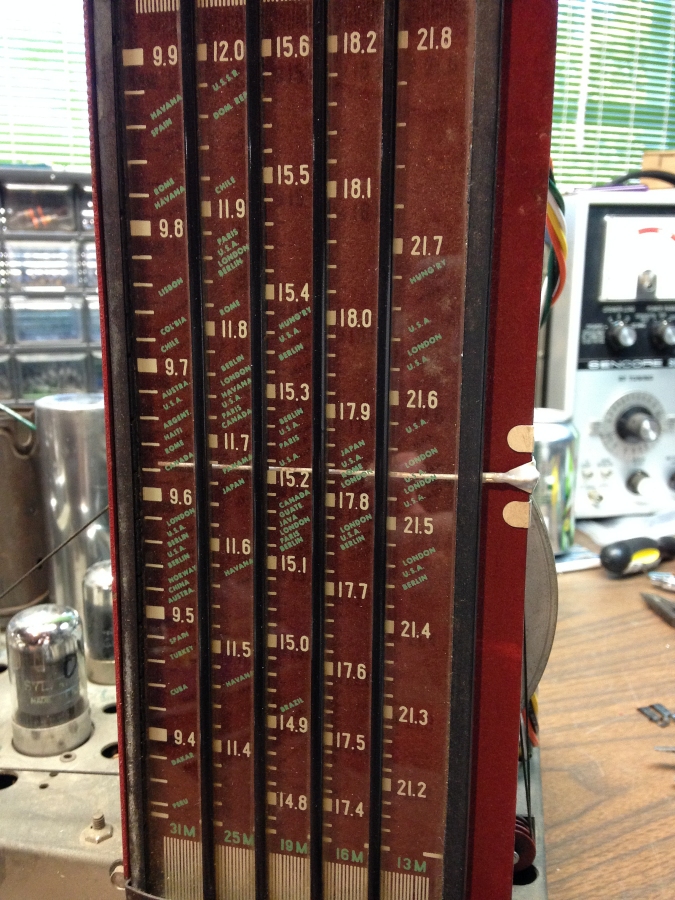

Here is the repaired right side dial pointer:
[Image: http://www.philcoradio.com/images/phorum...88_054.jpg]
[Image: http://www.philcoradio.com/images/phorum...88_055.jpg]
The pointer broke at the point where the pointer wire is clamped to the aluminum frame. The wire bends over the top of the frame, and was unbroken. This helped make the repair possible.

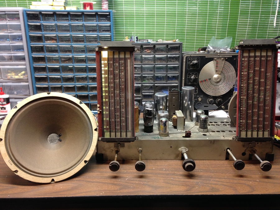

So I installed the repaired pointer in the dial this morning.
[Image: http://www.philcoradio.com/images/phorum...88_056.jpg]
[Image: http://www.philcoradio.com/images/phorum...88_057.jpg]
After aligning the "spread-bands" on the right side of the radio, I listened to an African station in English in the 16m band for a little while before checking the other bands to confirm that all five are working (and they are).
That concludes the chassis work on this radio. Now the original speaker (which I have not yet shown in any pictures) needs to be reconed, and the cabinet is going to need a lot of help.
