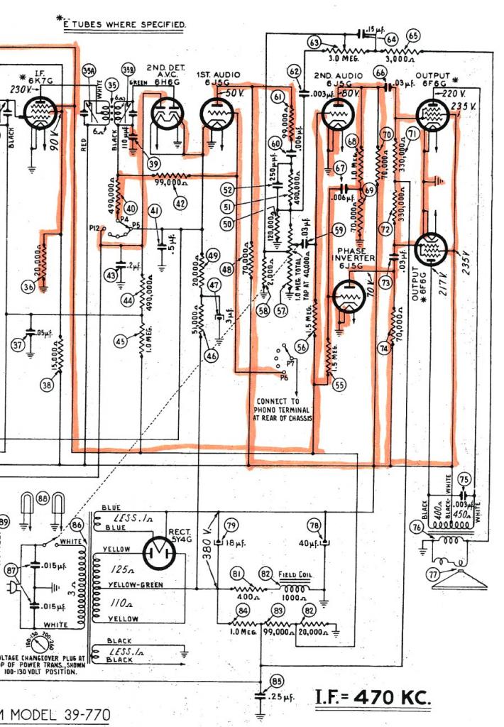

Today's progress so far:
[Image: http://www.philcoradio.com/images/phorum...770-26.jpg]
Or if you prefer, a photo:
[Image: http://www.philcoradio.com/images/phorum...770-27.jpg]
It's starting to look like a radio underneath the chassis again. As you can see, more wires have been installed, and some resistors and capacitors are now in place.
Using a highlighter on a copy of the schematic as I go along helps me to make sure things are getting put back in place as they should (wiring, capacitors, resistors, etc.).

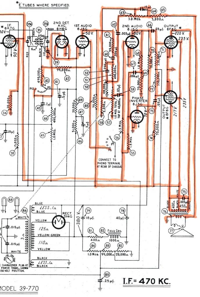

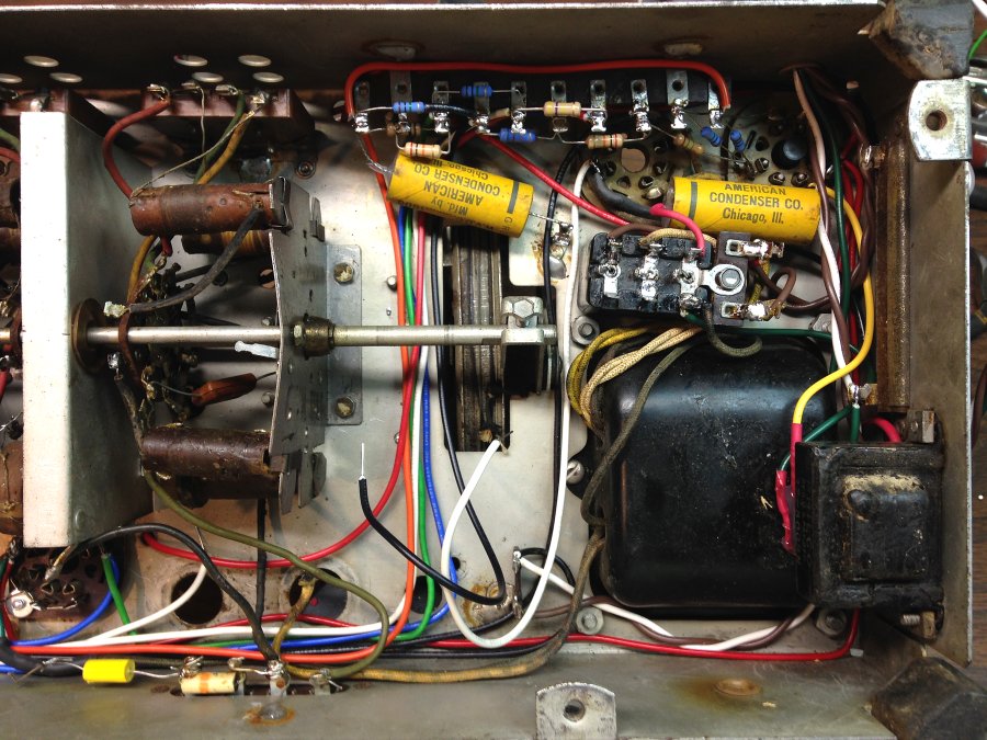

Today's progress, on the schematic:
[Image: http://www.philcoradio.com/images/phorum...770-28.jpg]

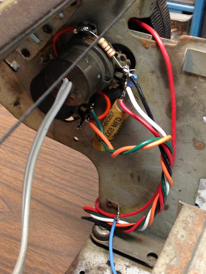

and looking under the chassis:
[Image: http://www.philcoradio.com/images/phorum...770-29.jpg]
It may not look like much was done today, but I replaced all of the wires running from the volume and tone controls to their respective points under the chassis. (I have not yet replaced the wires which run to the power switch.)

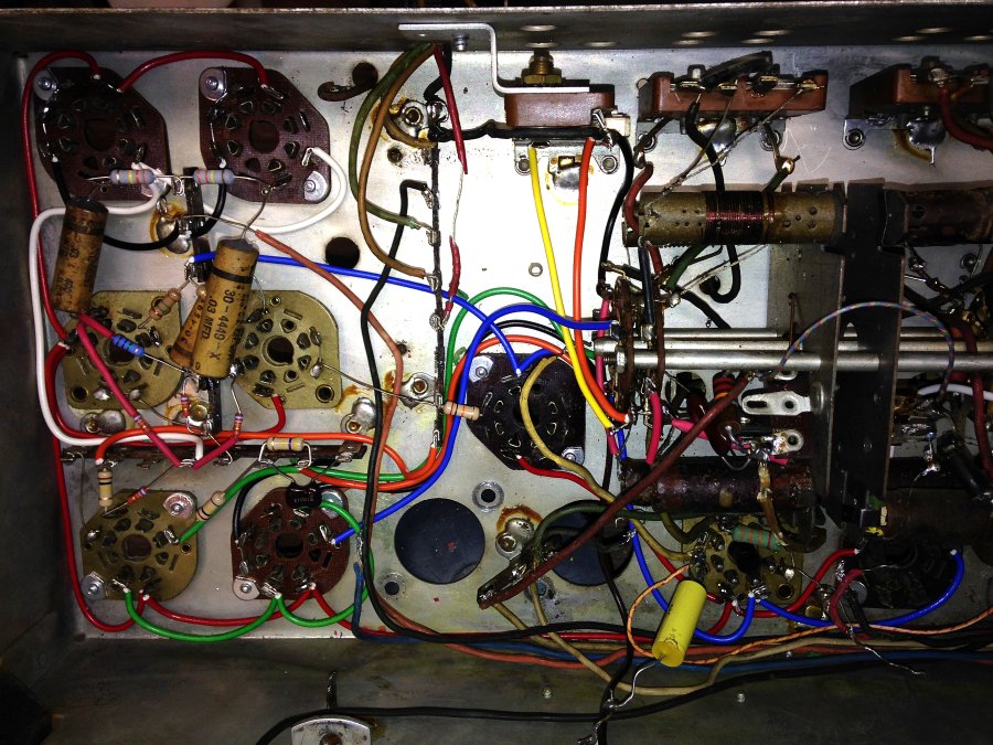

[Image: http://www.philcoradio.com/images/phorum...770-30.jpg]

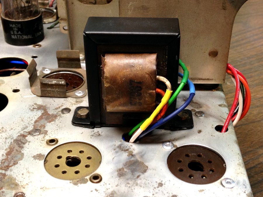

In addition, I lengthened the wires of the audio output transformer, as needed, and installed it.

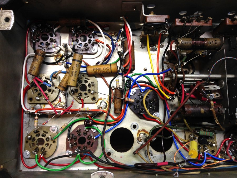

[Image: http://www.philcoradio.com/images/phorum...770-31.jpg]
Oh, and I also rebuilt the dial lamp socket which is used on the left side of the dial, and installed a new wire for that socket.
I think from here, I will next move to the other side of the chassis and address a long terminal board which has several resistors and one capacitor. I am going to save the RF and det-osc tubes for last, as well as checking the coils.

I worked on it some more this evening. I moved over to the right side of the chassis where there is a long terminal strip with many resistors, and wires coming from it which go to various places. I removed all of the resistors, and all of the interconnecting wires. I have almost all of those wires replaced, and started replacing the resistors with new ones.
So it's coming right along...

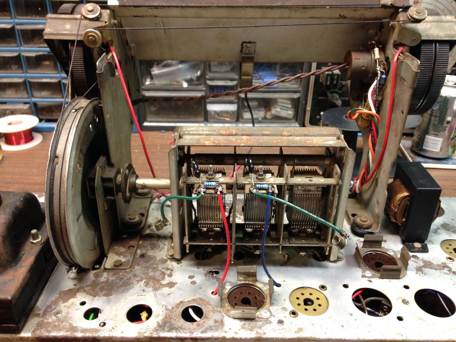

While I was working above the chassis, I replaced the grid leads at the tuning condenser, and also replaced the two 250 pF mica caps and 1 meg resistors connected at the tuning condenser.
[Image: http://www.philcoradio.com/images/phorum...770-33.jpg]

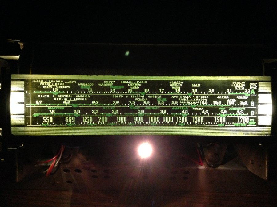

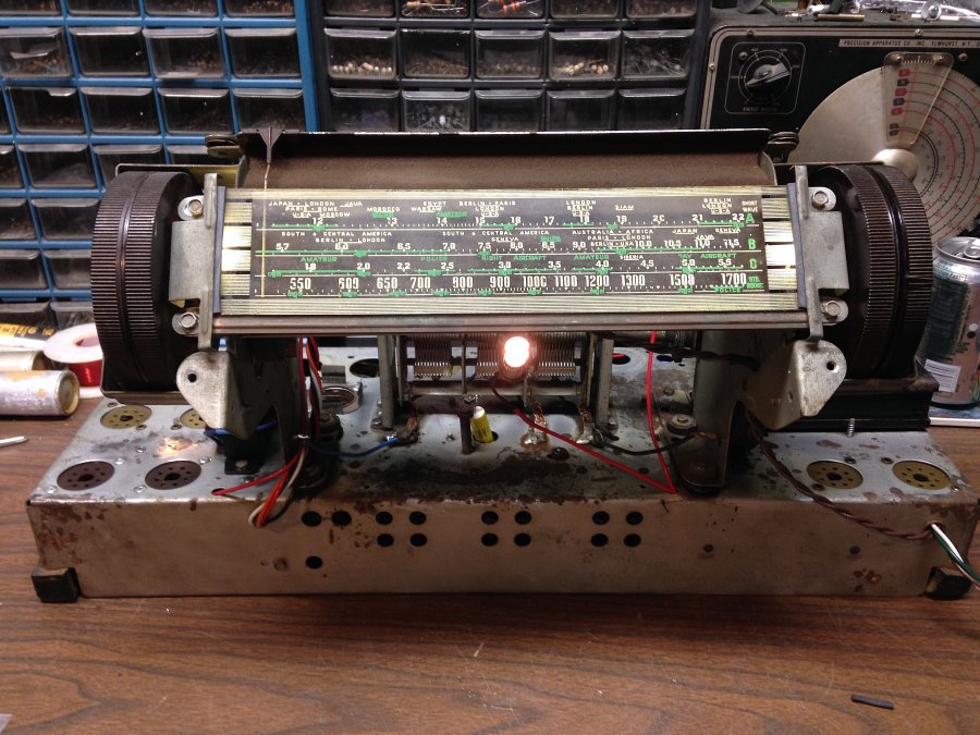

Once all of that was done, I decided to attach a power cord, install new dial lamps, and turn it on with no tubes installed, just to see the dial illuminated.
Here it is:
[Image: http://www.philcoradio.com/images/phorum...770-34.jpg]
[Image: http://www.philcoradio.com/images/phorum...770-35.jpg]
After that, I removed the dial scale, wrapped it in a towel and put it in a safe place. Now that I'm nearing the home stretch, I don't want anything to happen to it!
