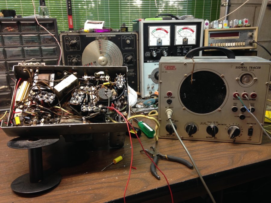

I looked...I do not have a PM speaker with an output transformer attached to it.
Then I remembered my Eico signal tracer. This signal tracer allows you to use its output transformer and speaker as a test speaker with output transformer...and the signal tracer does not have to be on to perform this test. (A good thing, because both the signal tracer and the 604 are AC/DC...and the two connected together and powered up would certainly cause the GFCI in line with my basement outlets to trip.)
I disconnected the plate leads from the 43 tube. I then connected the signal tracer's output transformer to the 43 plate and to B+.
The 604 plays loud and clear...
[Image: http://www.philcoradio.com/images/phorum...4_0026.jpg]
If I turn the volume control about 1/3 of the way up, I get a normal listening level with the 604 tuned to my SSTRAN at 660 kc. Which is how it should be.

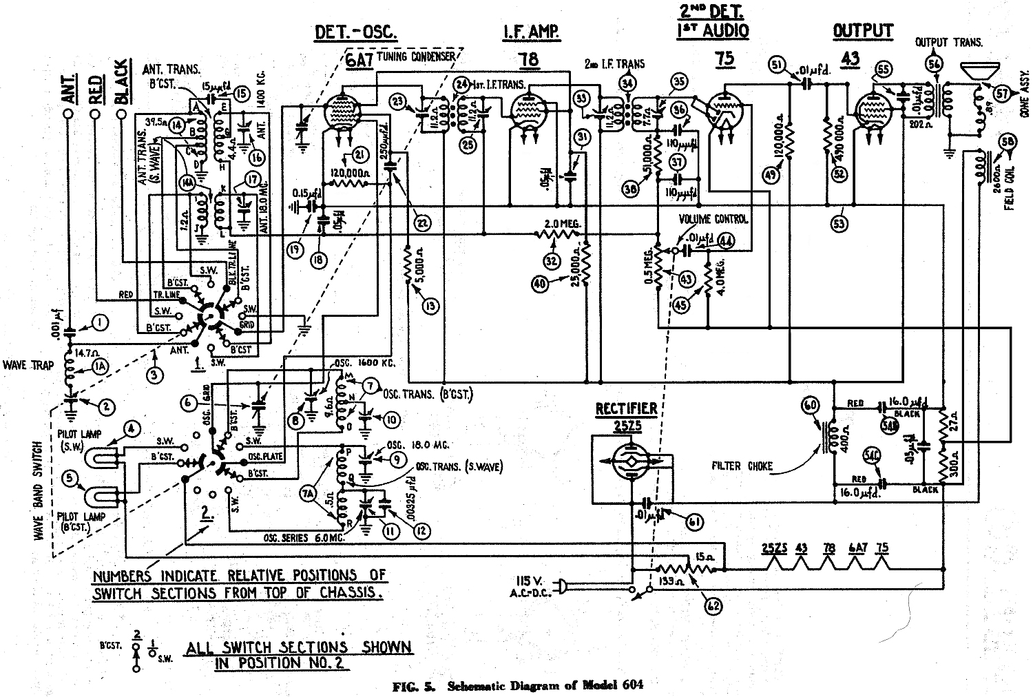

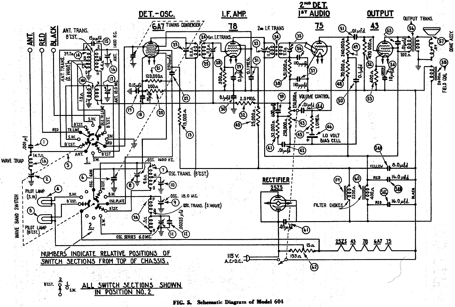

However, I've already set a course on a total re-do of this set. The circuitry will be changed slightly, to match that of a 38-14 save for the front end.
The original schematic:
[Image: http://www.philcoradio.com/images/phorum...604_sm.jpg]
The modified schematic:
[Image: http://www.philcoradio.com/images/phorum...mod_sm.jpg]
Larger versions may be seen by following the links just below:
Original 604 schematic:
http://www.philcoradio.com/images/604.jpg
Modified 604 schematic:
http://www.philcoradio.com/images/604mod.jpg

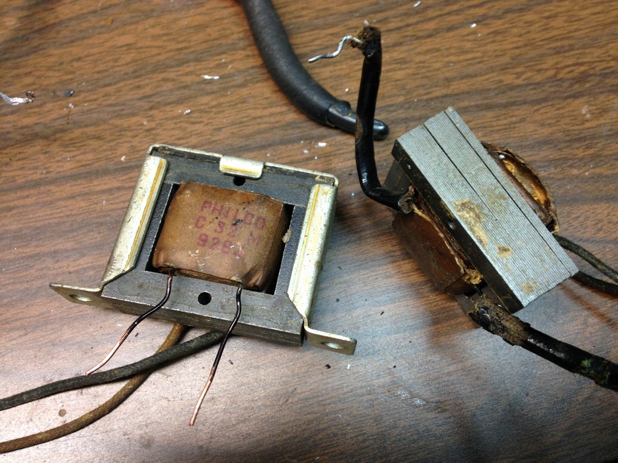

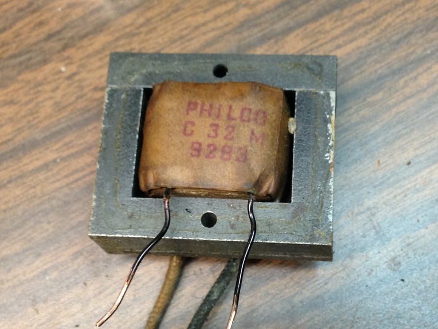

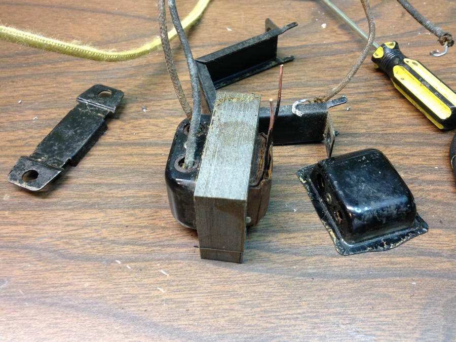

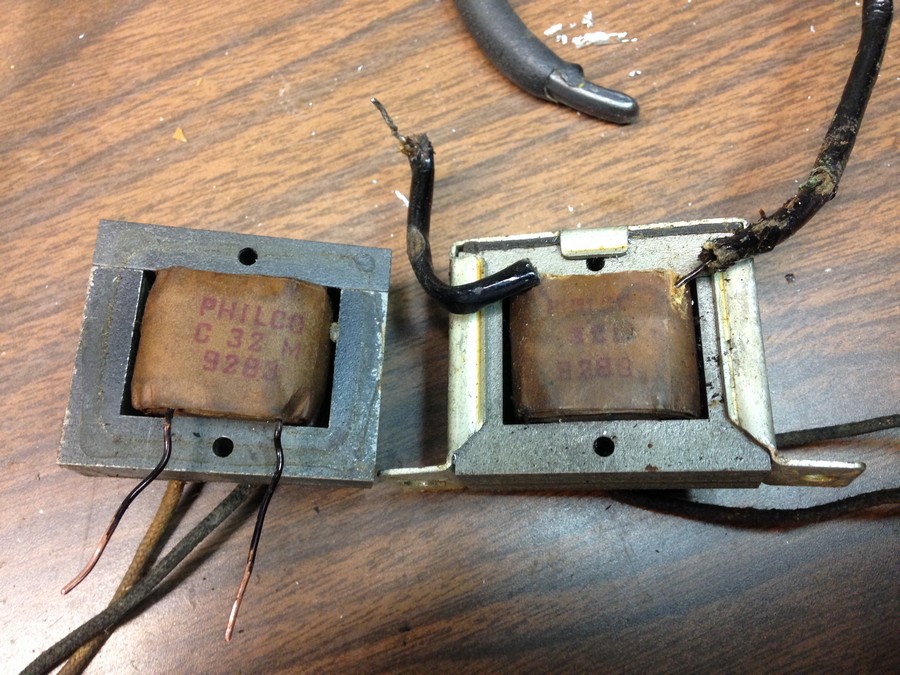

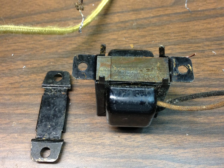

But first...Let me show you how I made a 602/37-602 audio output transformer fit underneath a 604 chassis.

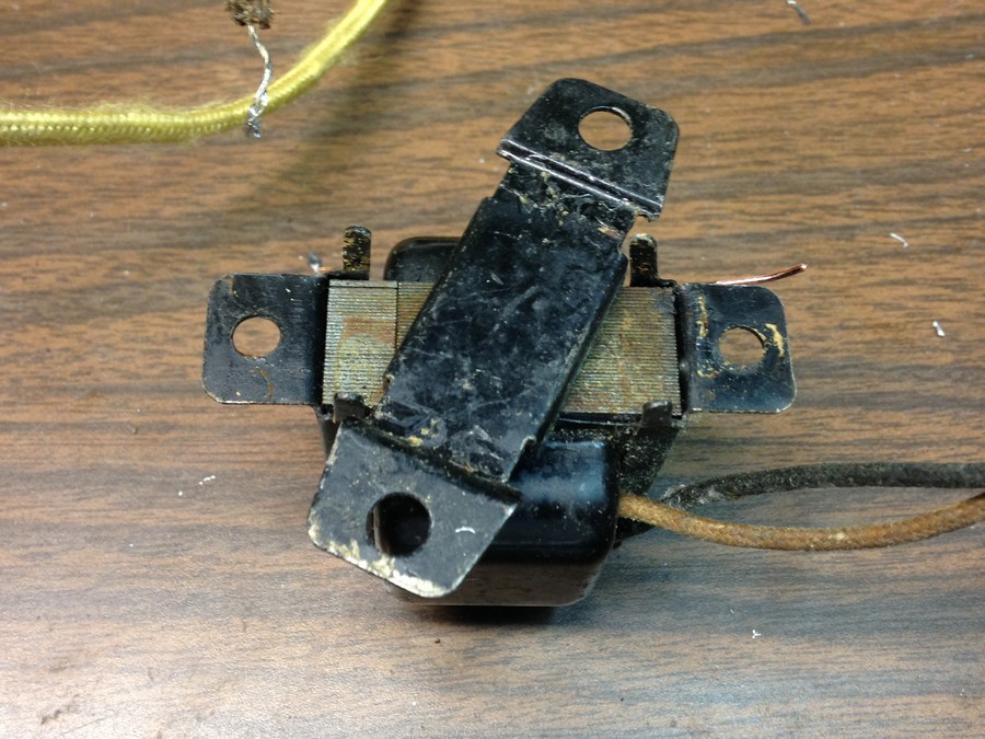

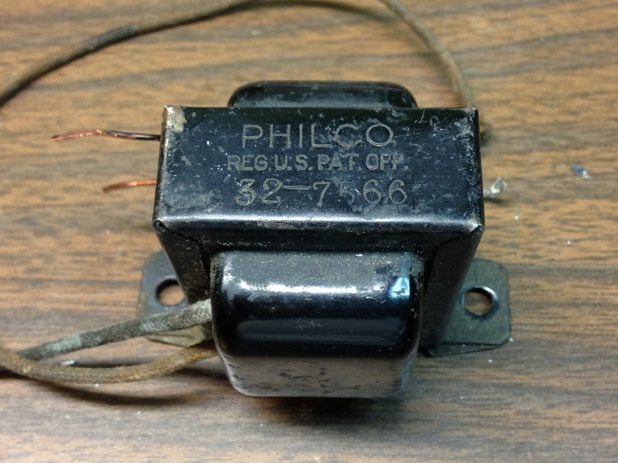

You take the 37-602 audio output transformer...
[Image: http://www.philcoradio.com/images/phorum..._00027.jpg]
shine it up real nice... no, no, wait, getting carried away with a former wrestler and now action-adventure movie star's catch phrases. Anyway...
You have to remove the core from the shell. It's not too hard, really.
[Image: http://www.philcoradio.com/images/phorum..._00028.jpg]
[Image: http://www.philcoradio.com/images/phorum..._00029.jpg]
[Image: http://www.philcoradio.com/images/phorum..._00030.jpg]
Keep pulling the steel frame from the core until you are left with only the bare core:
[Image: http://www.philcoradio.com/images/phorum..._00031.jpg]

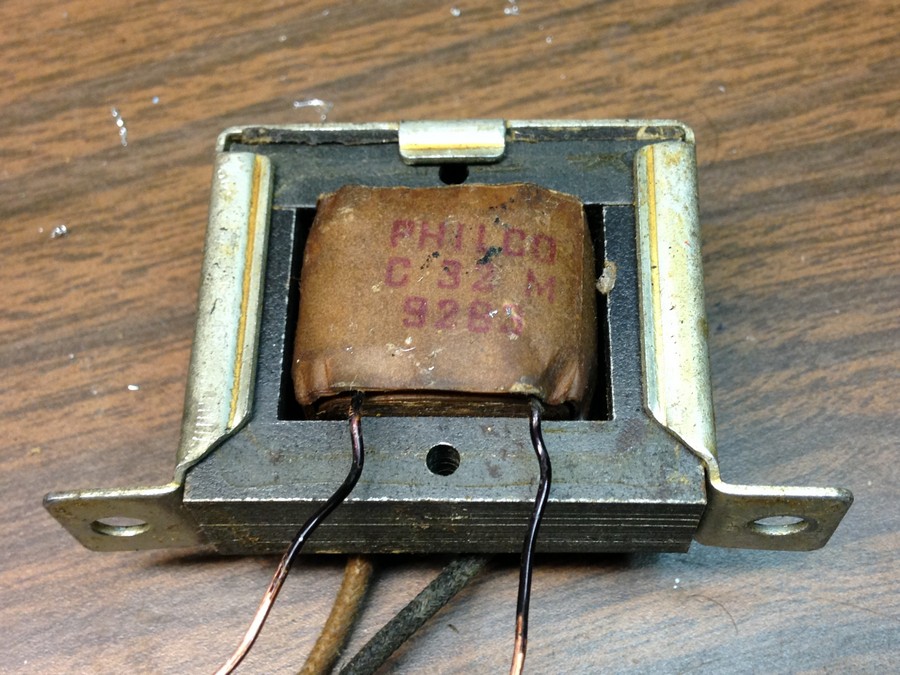

Now you will need to install the core into the frame of the original transformer. Notice how both are nearly identical in appearance? They also have identical electrical characteristics.
[Image: http://www.philcoradio.com/images/phorum..._00032.jpg]
Remove the core from the frame of the original 604 transformer...and install the core of the 37-602 transformer into the 604 transformer's frame.
[Image: http://www.philcoradio.com/images/phorum..._00033.jpg]
[Image: http://www.philcoradio.com/images/phorum..._00034.jpg]
Lengthen the leads as needed, and install in the 604.
[Image: http://www.philcoradio.com/images/phorum..._00035.jpg]

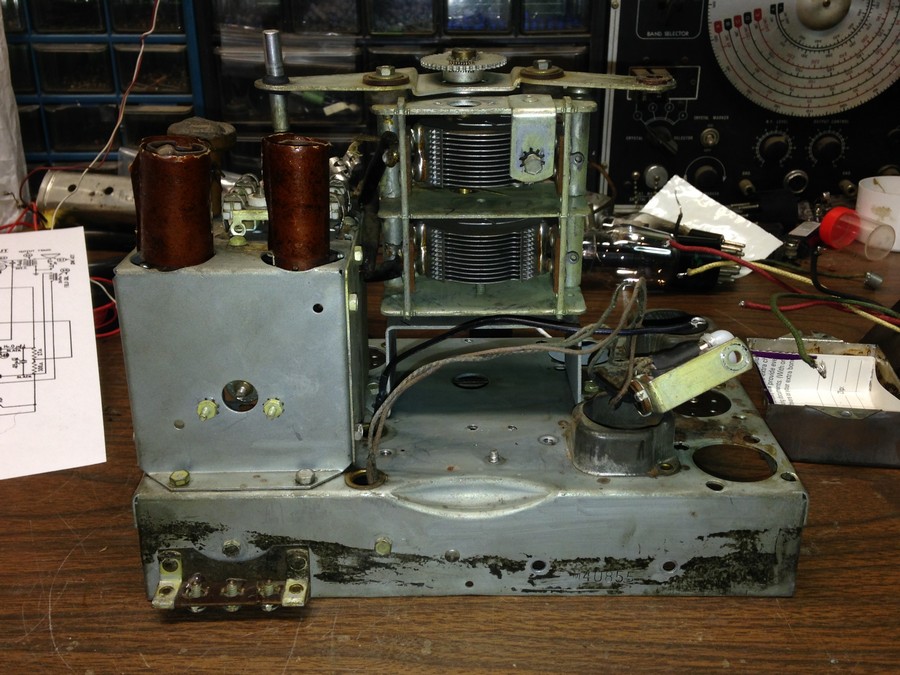

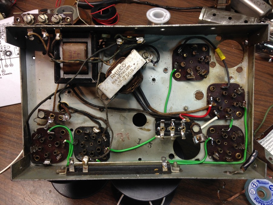

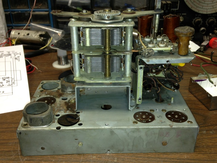

So today, I made good upon my threat to completely re-do this radio.
After a couple hours of work, I had an almost bare chassis.
[Image: http://www.philcoradio.com/images/phorum..._00036.jpg]
[Image: http://www.philcoradio.com/images/phorum..._00037.jpg]
[Image: http://www.philcoradio.com/images/phorum..._00038.jpg]
I cleaned the chassis somewhat, and also removed the IF transformers. The 1st IF is suspicious - its secondary winding is reading near zero, and so that transformer will be replaced.
The next step is all new wiring under the chassis.

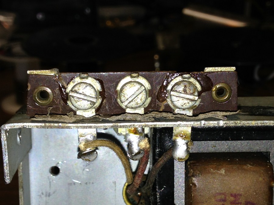

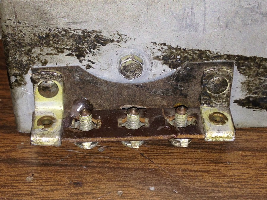

In case you were wondering (or care) about the antenna terminal strip, I managed to glue it back together and I think it will be OK.
[Image: http://www.philcoradio.com/images/phorum..._00039.jpg]
[Image: http://www.philcoradio.com/images/phorum..._00040.jpg]

And so the work begins (again)...
[Image: http://www.philcoradio.com/images/phorum..._00041.jpg]
This is what I managed to get done this evening before we left to go see a fireworks show...
