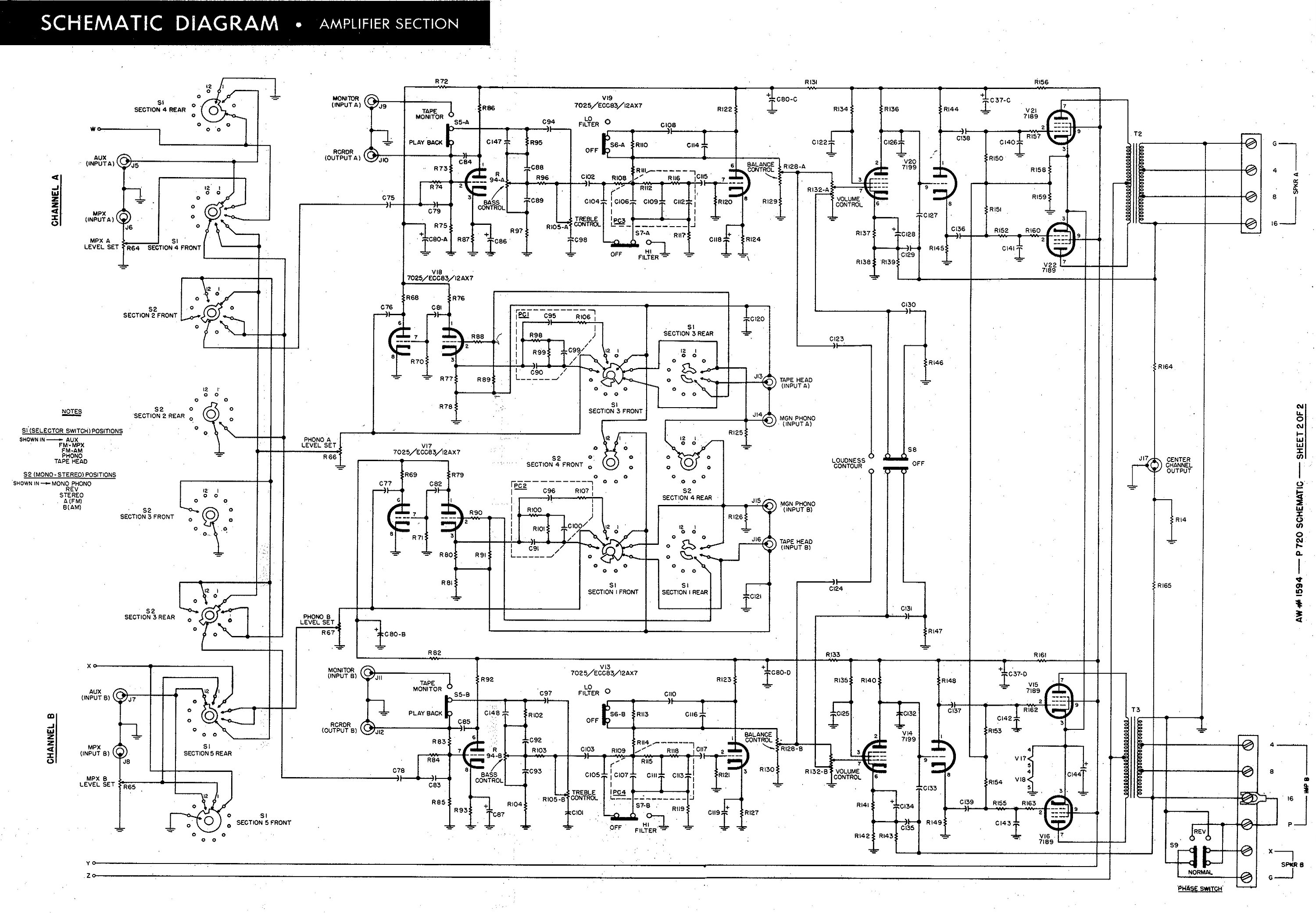

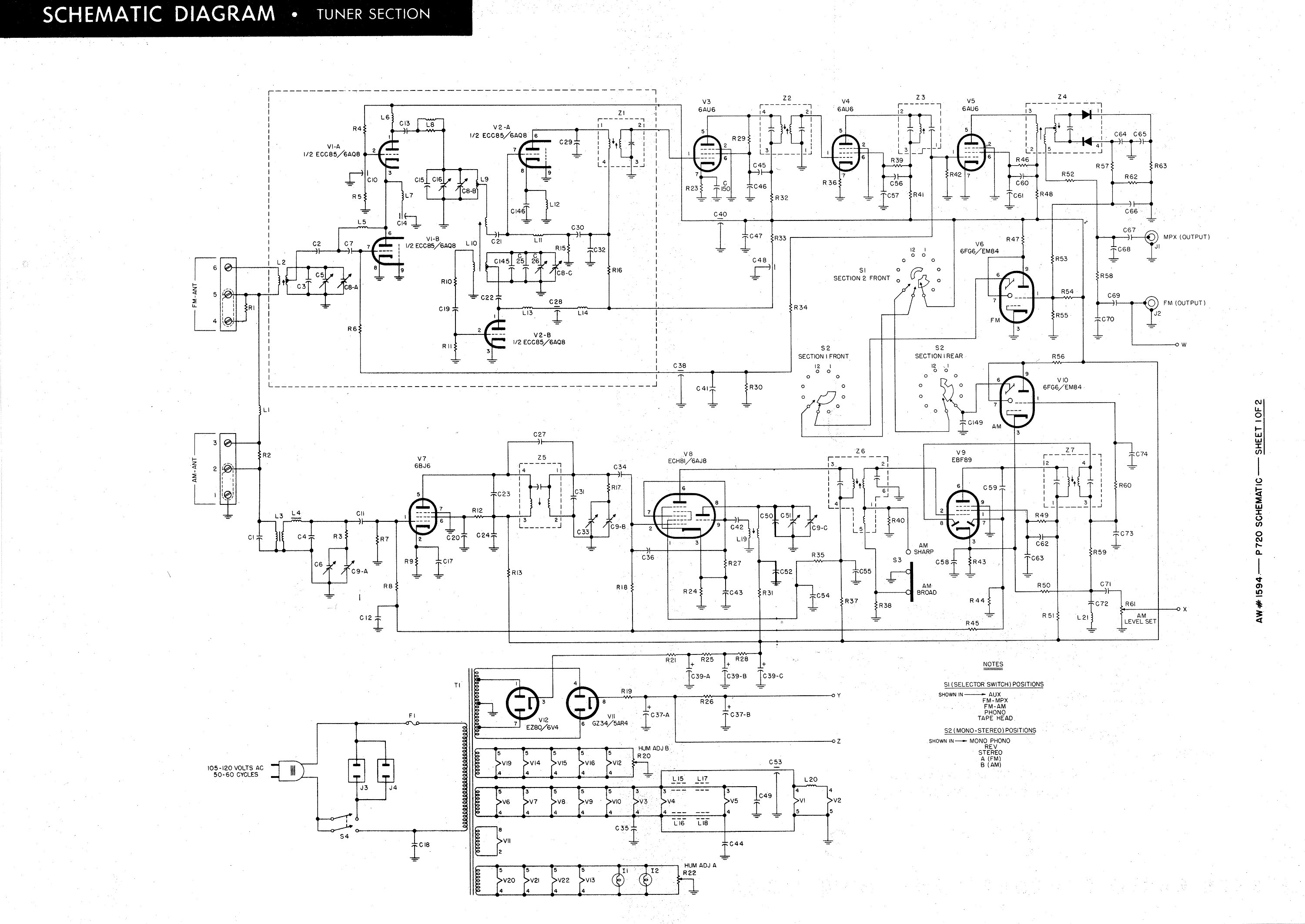

Schematics:
Tuner and power supply - Click Here
Stereo amplifier - Click Here

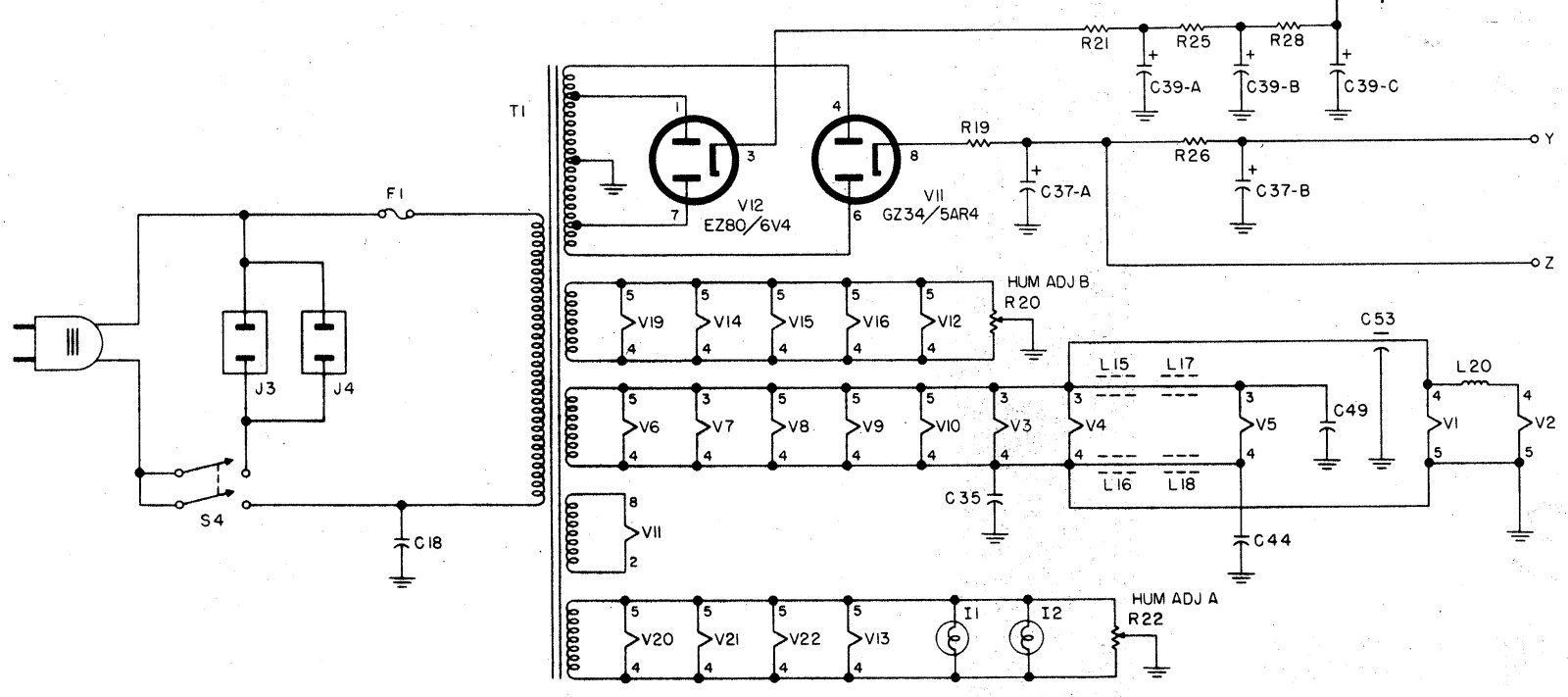

Here's the power supply - click to enlarge.
[Image: http://www.philcoradio.com/images/phorum...s01_sm.jpg]
As you can see, with R19 open as it is, no B+ is going to get to the stereo amplifier. Point Z goes to the center taps of the audio output transformer primaries (and from there to each of the 7189 plates); point Y goes to the 7189 screen grids. Point Y also serves as the B+ source for the rest of the amplifier section.

I now understand why R19 is open in my TA-600 - the resistor was under-rated to begin with, and late production models switched to two 280 ohm 7W resistors in parallel to equal 140 ohms, 14W. I'm replacing mine with a 150 ohm, 20 watt resistor.

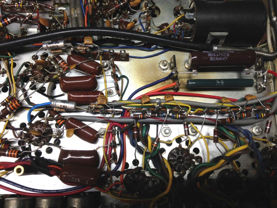

So the real work began today.
[Image: http://www.philcoradio.com/images/phorum...00_008.jpg]

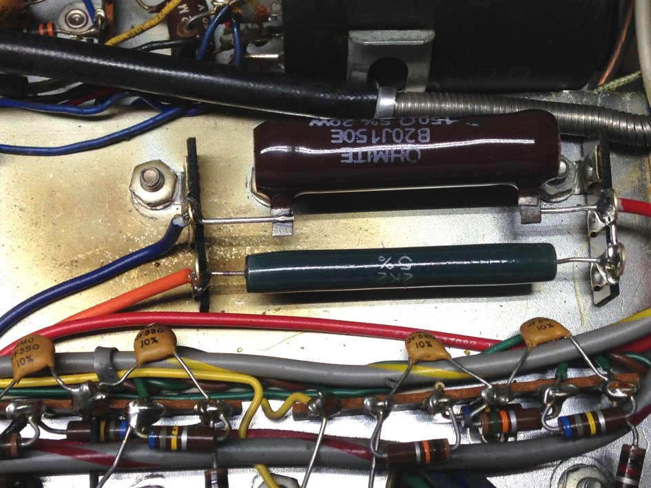

I have replaced three electrolytics and some resistors, most notably R19 and R26.
[Image: http://www.philcoradio.com/images/phorum...00_009.jpg]
Following the recommendations by Dave Gillespie on Audiokarma (see post #32 above), I changed R19 to a 150 ohm, 20 watt resistor. I added new terminal strips to hold R19 and R26, and to get their ends away from audio section wiring as Mr. Gillespie suggested.
[Image: http://www.philcoradio.com/images/phorum...00_010.jpg]

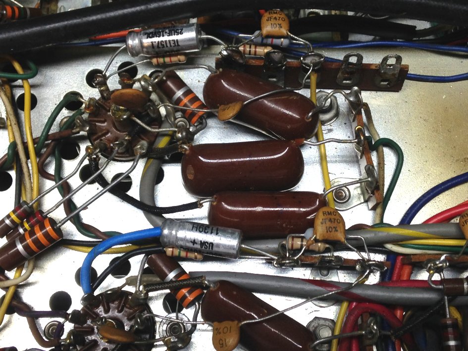

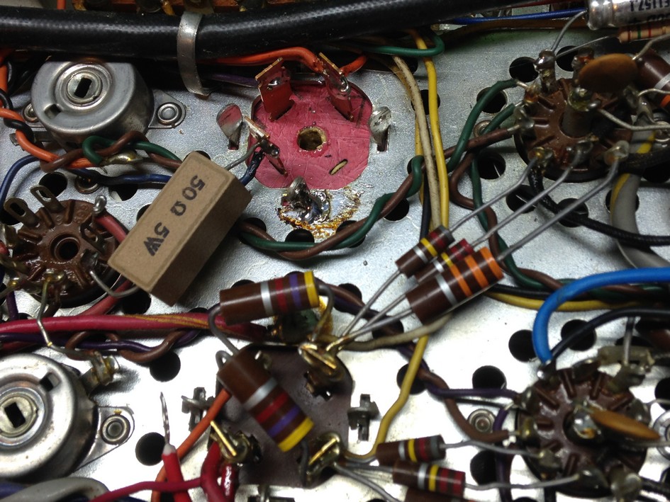

A closer look at a couple of the 25 uF electrolytics I replaced, along with the resistors that also connected in the same areas:
[Image: http://www.philcoradio.com/images/phorum...00_011.jpg]

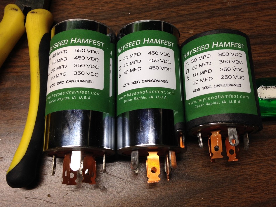

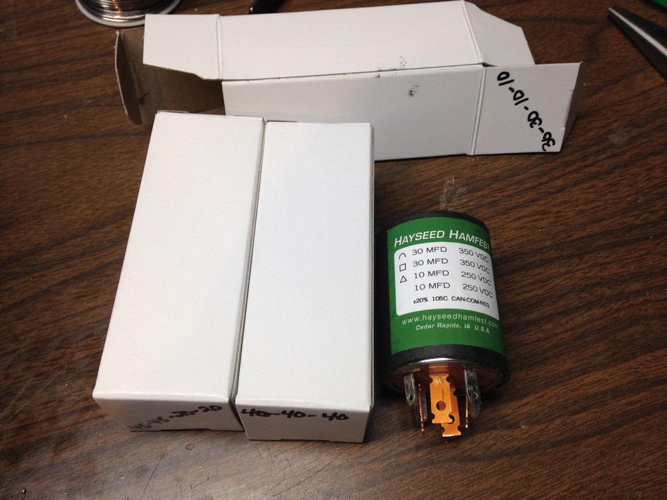

A nice CARE package arrived in today's mail from Iowa.
[Image: http://www.philcoradio.com/images/phorum...00_012.jpg]
[Image: http://www.philcoradio.com/images/phorum...00_013.jpg]

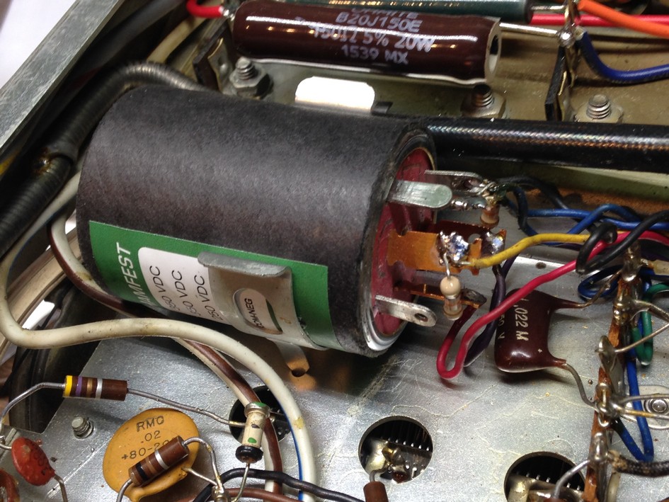

Three new Hayseed Hamfest twist-lock electroytics, custom made for the Fisher TA-600. This was my first order from Hayseed, and I must say these caps look great.
My goal for today: Get all three mounted in place.
The first one was easy:
[Image: http://www.philcoradio.com/images/phorum...00_014.jpg]

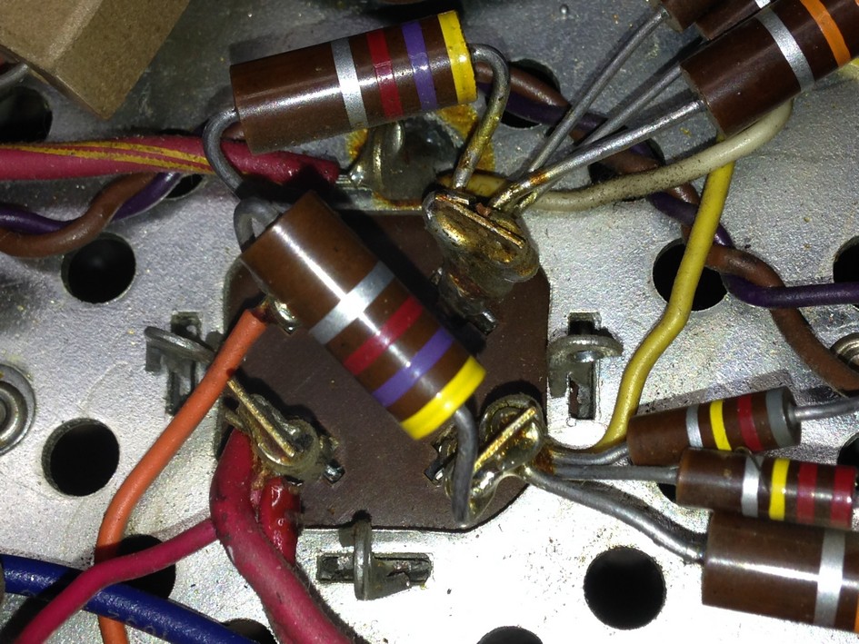

Next, I took a photo of C37 - just in case I forgot what went where, since so many wires and resistors connect to it:
[Image: http://www.philcoradio.com/images/phorum...00_017.jpg]
