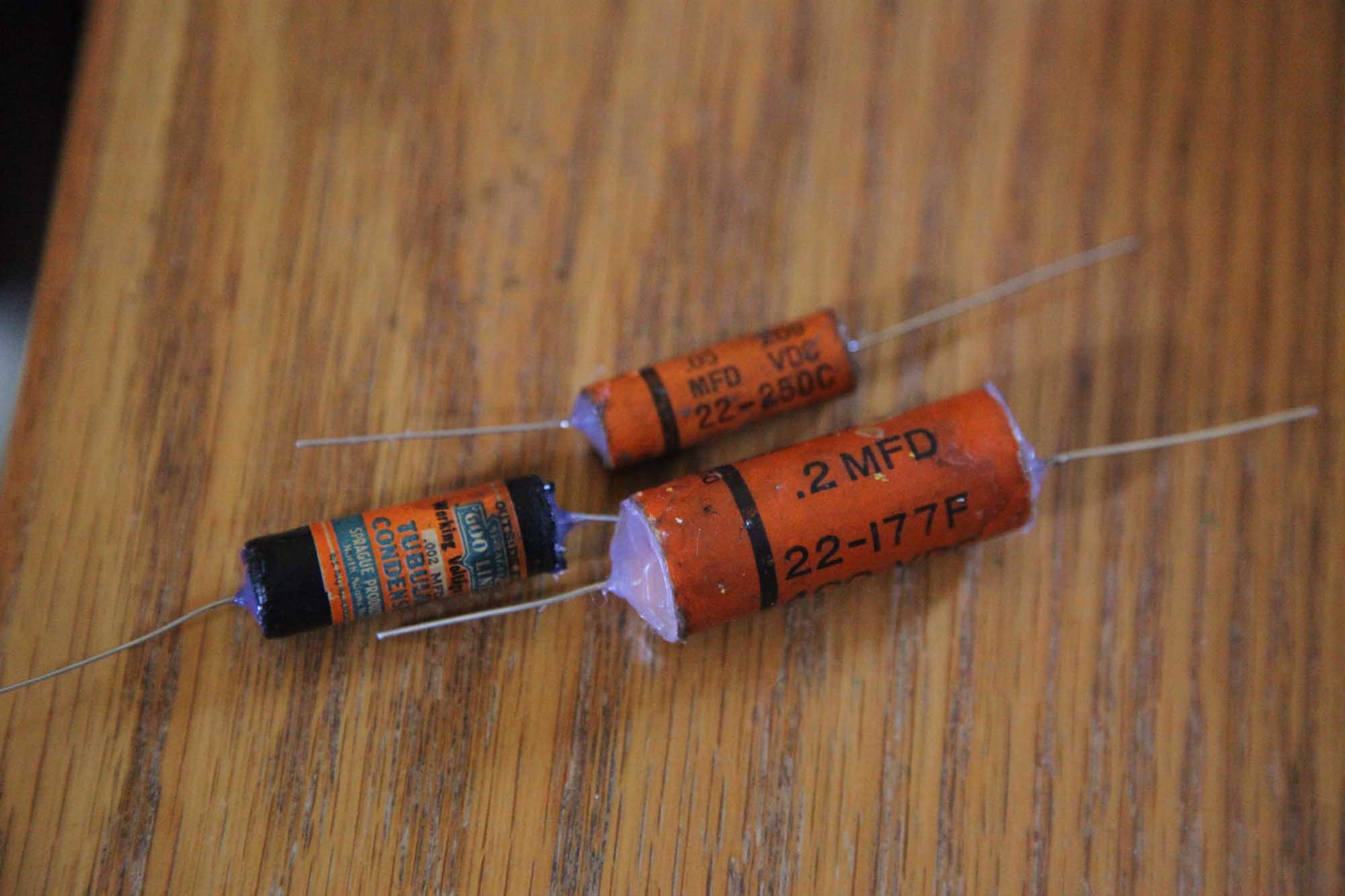

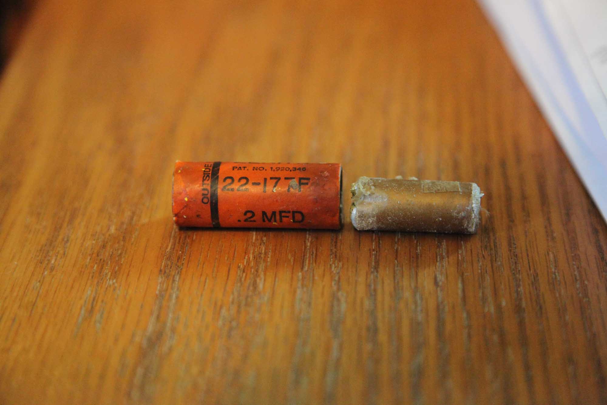

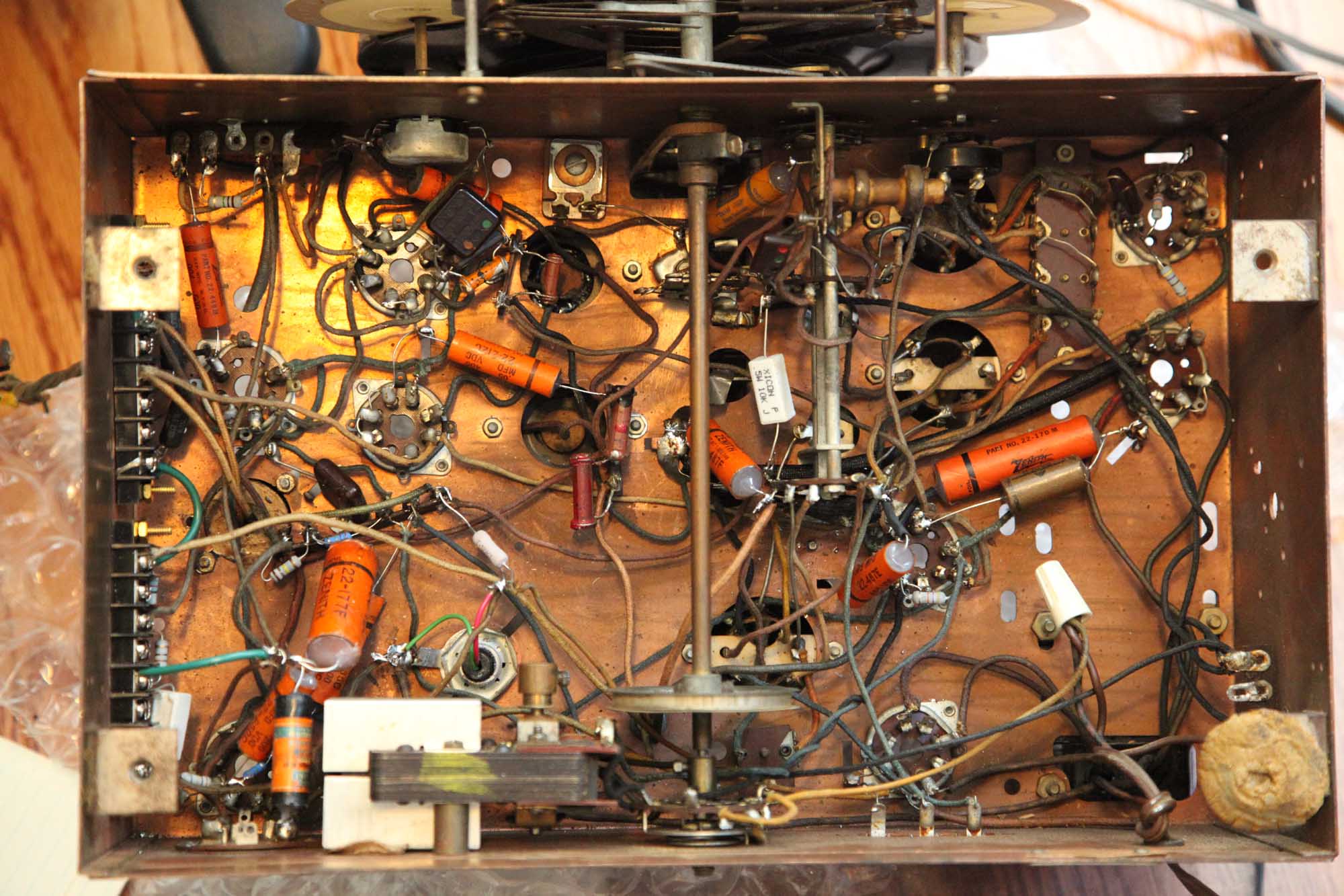

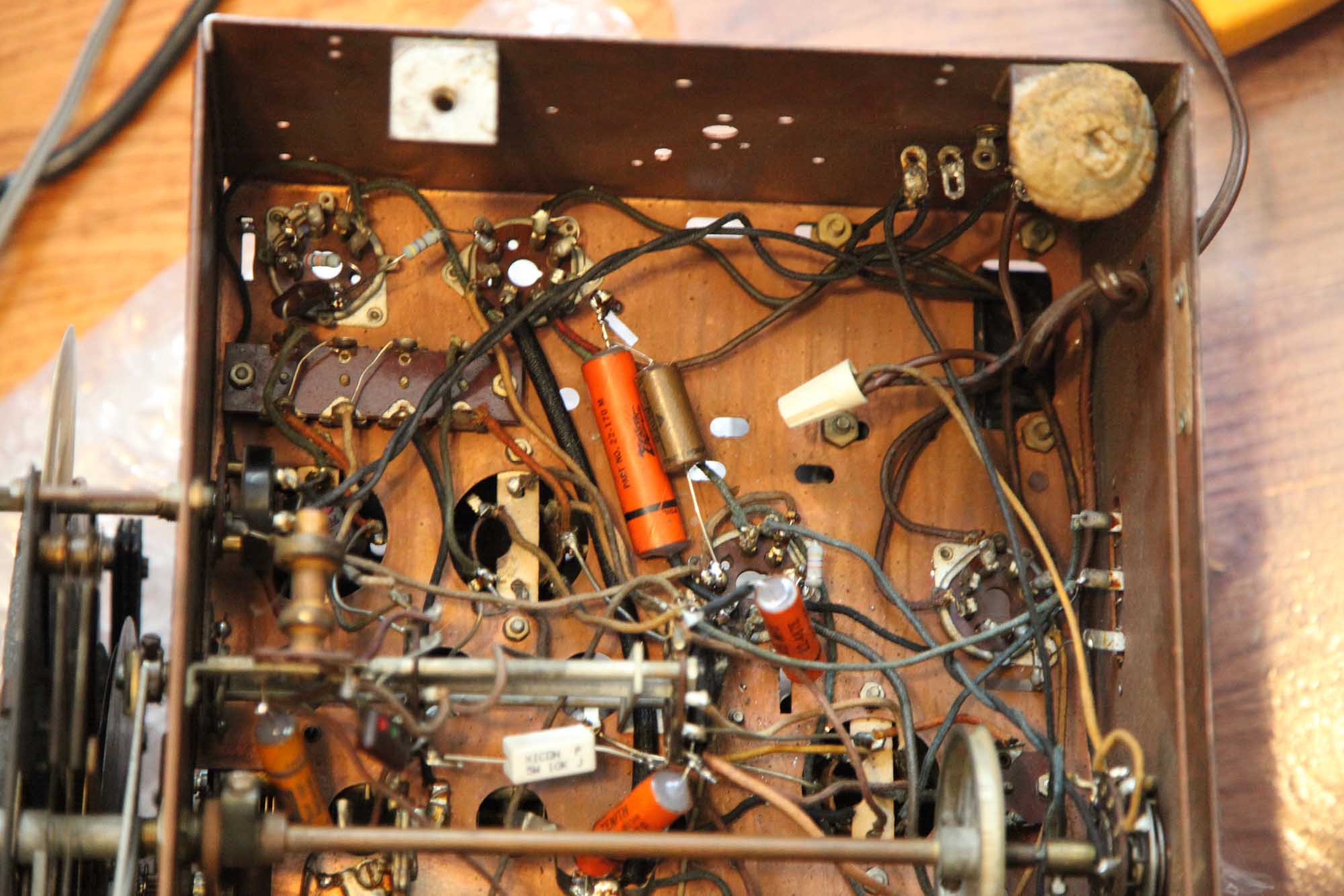

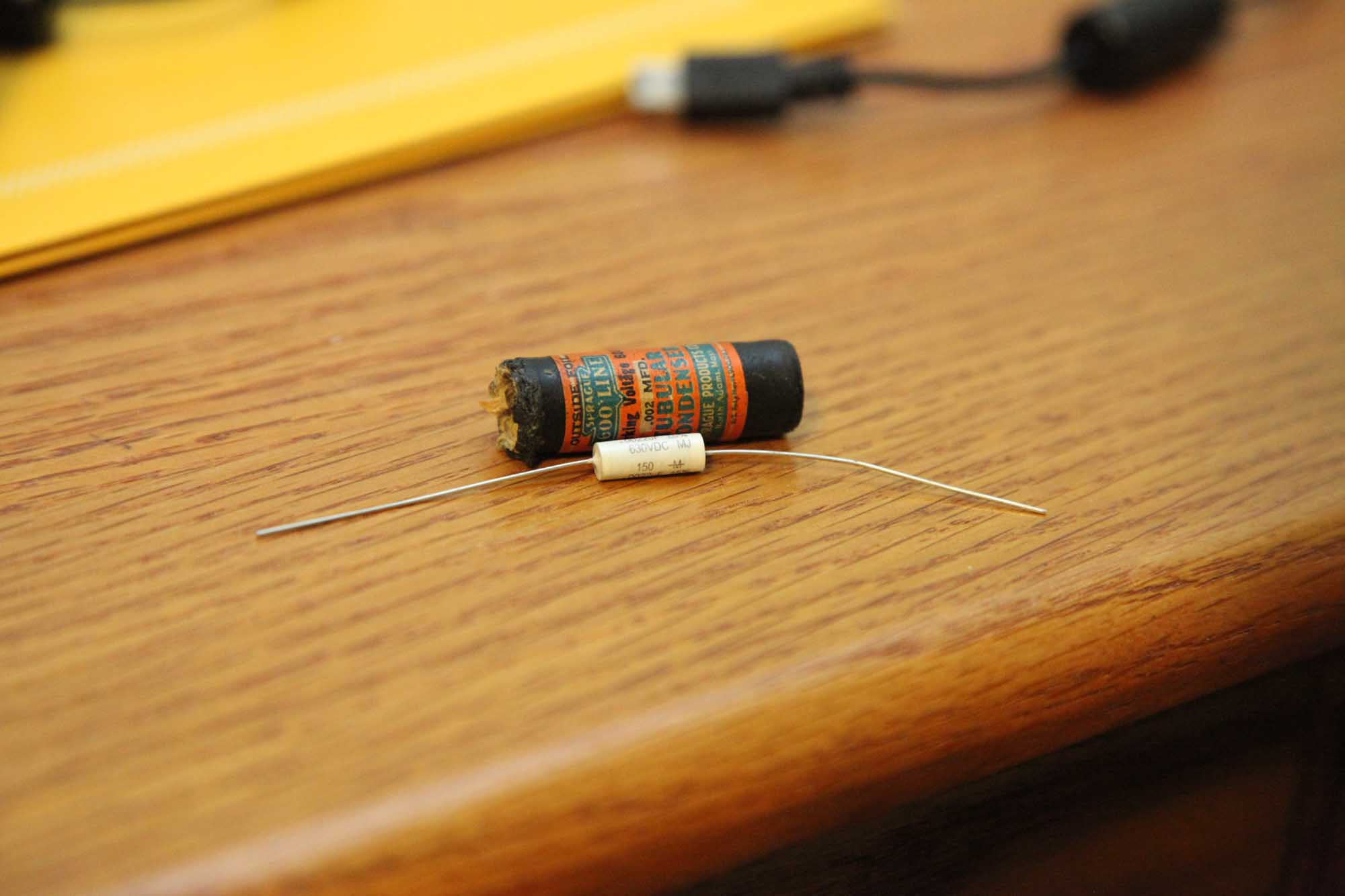

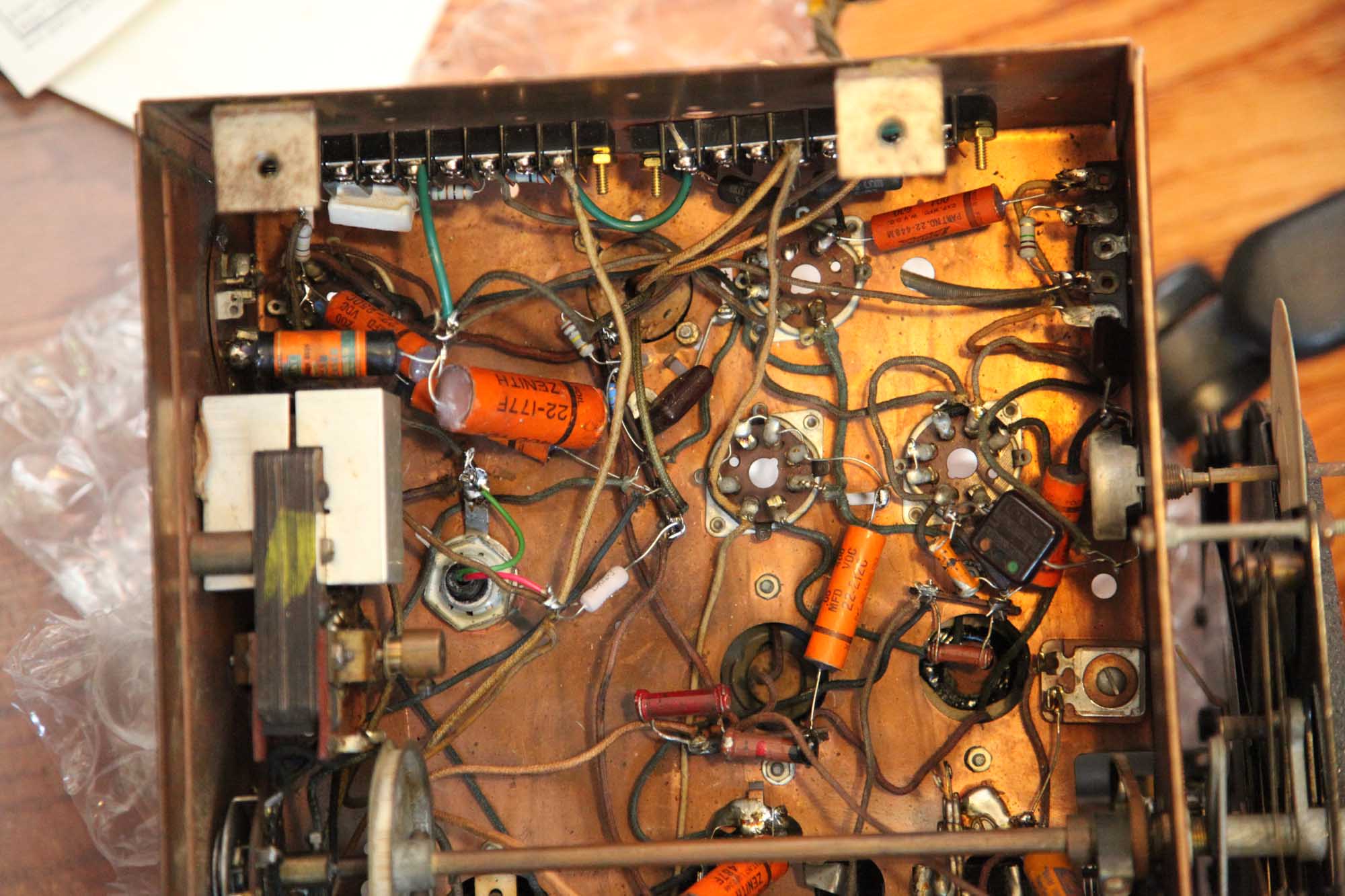

Well, have just finished recapping. Except the micas I took every tubular cap, drilled the guts out, stuffed them with new film caps. The old ones were totally off. Now they look good, authentic and are right values too. Will show pictures later.
Oh and most resistors are replaced also.
Well, today is the day of the first reward - the Zee played the local "Good oldies" station, and the sound was great.
And this is with the tone control still broken. - not even sure what it is set to.
After yesterday's recapping finished, I cleaned the tubes, which all had at least their filament intact and no obvious shorts, one of them, the second detector, said "bad" on its base, but I thought it is probably subpar but still working, at least for testing, as I still don't have a tube tester; soldered the grid cap to one of the tubes where it came off; put the rectifier in, made sure it rectified, then plugged the speaker, made sure the voltage is everywhere, plugged the rest of the tubes, saw them glow, then t oched the grid of the first stage and heard the hum. Connected a wire to Antenna, set the dial to the local station I usually listen to, and, voila, it played.
Well, I'm gonna finish the beer, then take the RF Gen. to it.
Now I have to:
- Find a new tone ctl switch
- Fix the tuning belt
- Fix the motordrive belt
- tune the IF and the dial
- The magic eye tube does not even glow green. Probably needs fixin'.
- check the SW foreign broadcast;
- Eventually test the tubes (well, just earned a little side money, enough to buy something nice, so, my love, take that!)
The audio transformer obviously is a successful choice, as it plays well and fit right in with minor adjustments.
This is it so far; will go to my main computer and post the photos of the recapped chassis.

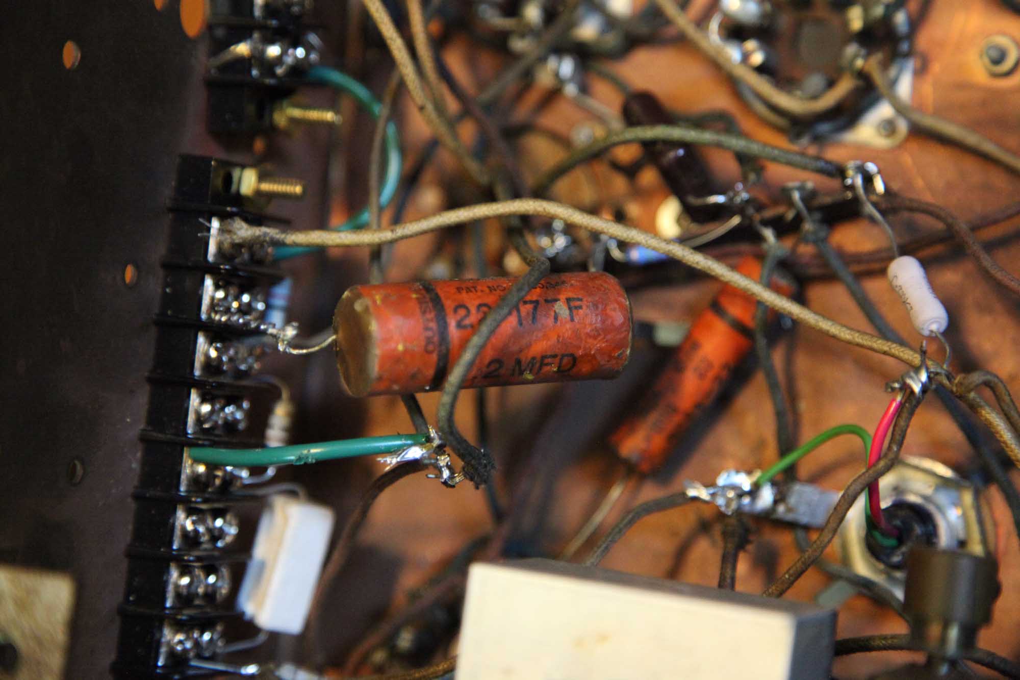

I see you have a non zenith wax/paper cap from the back of your speaker plug to the candohm lug (where all the negative leads go from the other caps). My 9s262 chassis does not have this. I assume it was done at some point in the past to eliminate noise?
No, it is a cap that is in the sch, the C17. They obviosly changed some caps, probably way back, in 40s or 50s, there is another one that is not Zenith.
This is 0.002uF, but supposed to be 1000V, and this is 600V, and I also put 600V in.
There were some replacements done.
My magic eye tube is 6u5 and it is supposed to be 6T5, for example. And so on.
