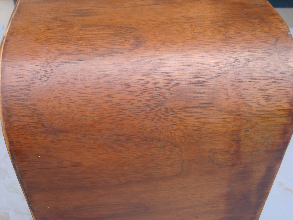

Here you can see the grain, even though it has had one coat of Constantine wood filler already.

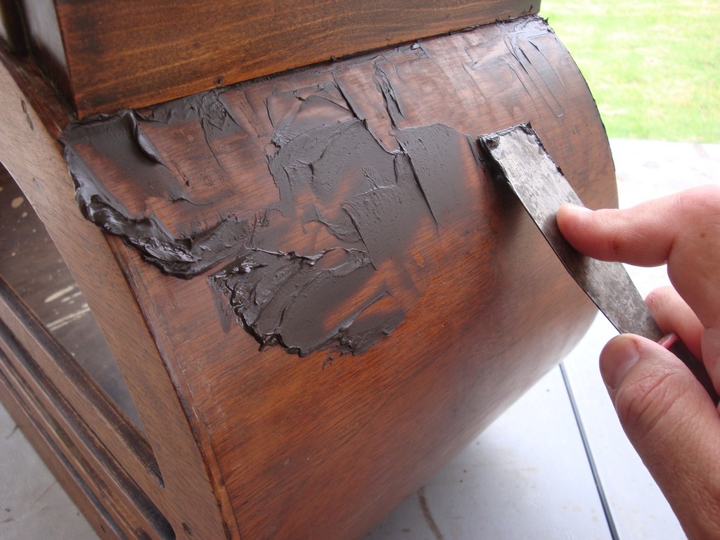

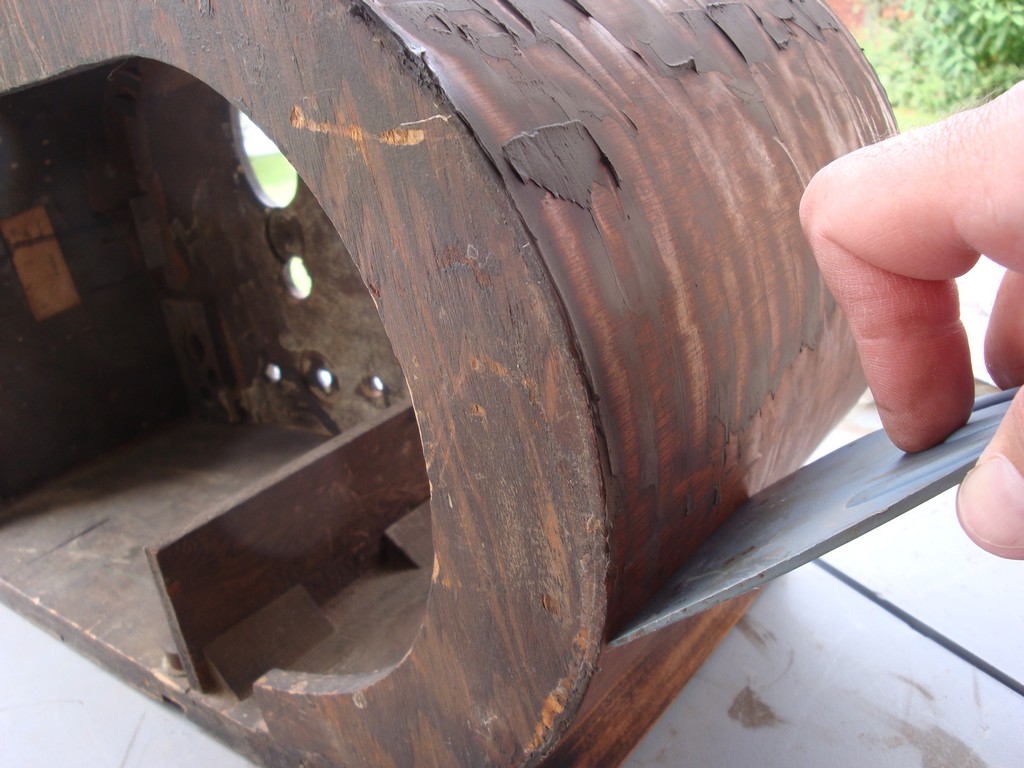

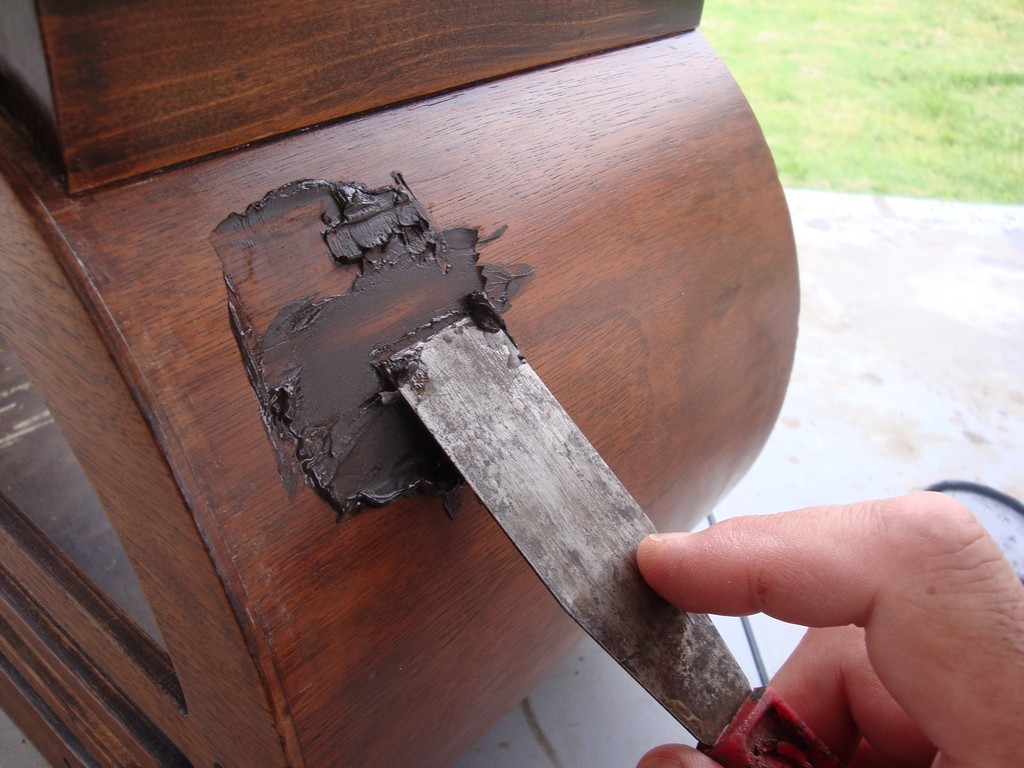

I find it easier to apply the stuff straight from the can without thinning it. Here, I am pushing it into the grain by applying forward and backward pressure, against the grain, with this small putty knife.
[Image: http://www.philcoradio.com/images/phorum...0003-4.jpg]

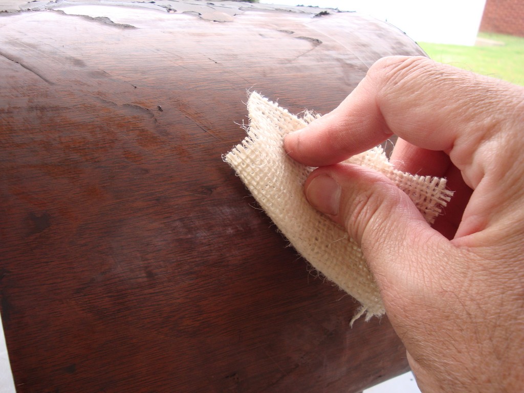

Once most (not all) of the excess has been squeegeed off, I use a piece of burlap to rub the remnant into the grain as much as possible, using a circular motion.

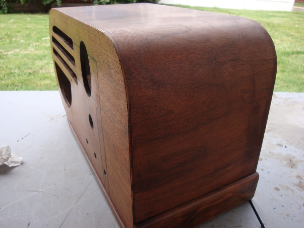

Finally, how the 610T looks after the second coat.
[Image: http://www.philcoradio.com/images/phorum...0007-2.jpg]
I took the cabinet out into the direct sunlight and carefully looked it over. All grain appears to be filled. This stuff does shrink somewhat, though, so I shall see either tomorrow or this weekend, depending on whether we get any of the rain the meteorologists are predicting for this area. If the rain holds off and the grain appears to be filled, I'll be spraying lacquer this weekend on the 610T cabinet.

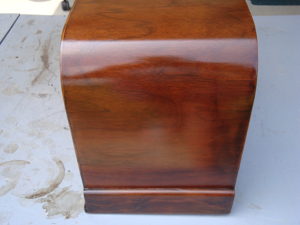

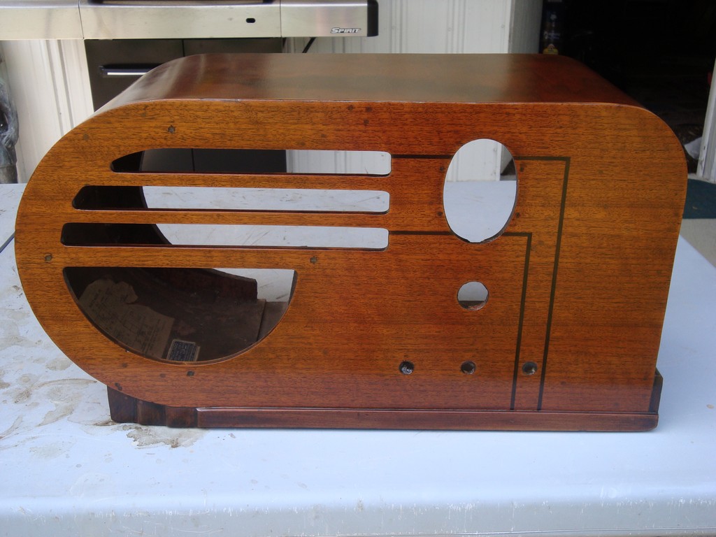

So just a little while ago, I applied two coats of Medium Walnut toner to the 610T:
[Image: http://www.philcoradio.com/images/phorum...0001-6.jpg]
[Image: http://www.philcoradio.com/images/phorum...0002-5.jpg]
Nice and even. (Edit: The light spot on the side is a reflection from the table, not unevenness in the color.) And I would say the grain is easily 95% or better filled. Next comes the contrasting darker toner on the bottom trim, after the Medium Walnut has a chance to dry some more, plus dark lacquer on the inside edges of the speaker grille. Then a couple coats of clear, wet sanding, a couple more coats of clear, the PHILCO decal, then a couple final coats of clear. This 610T is well on its way to completion.

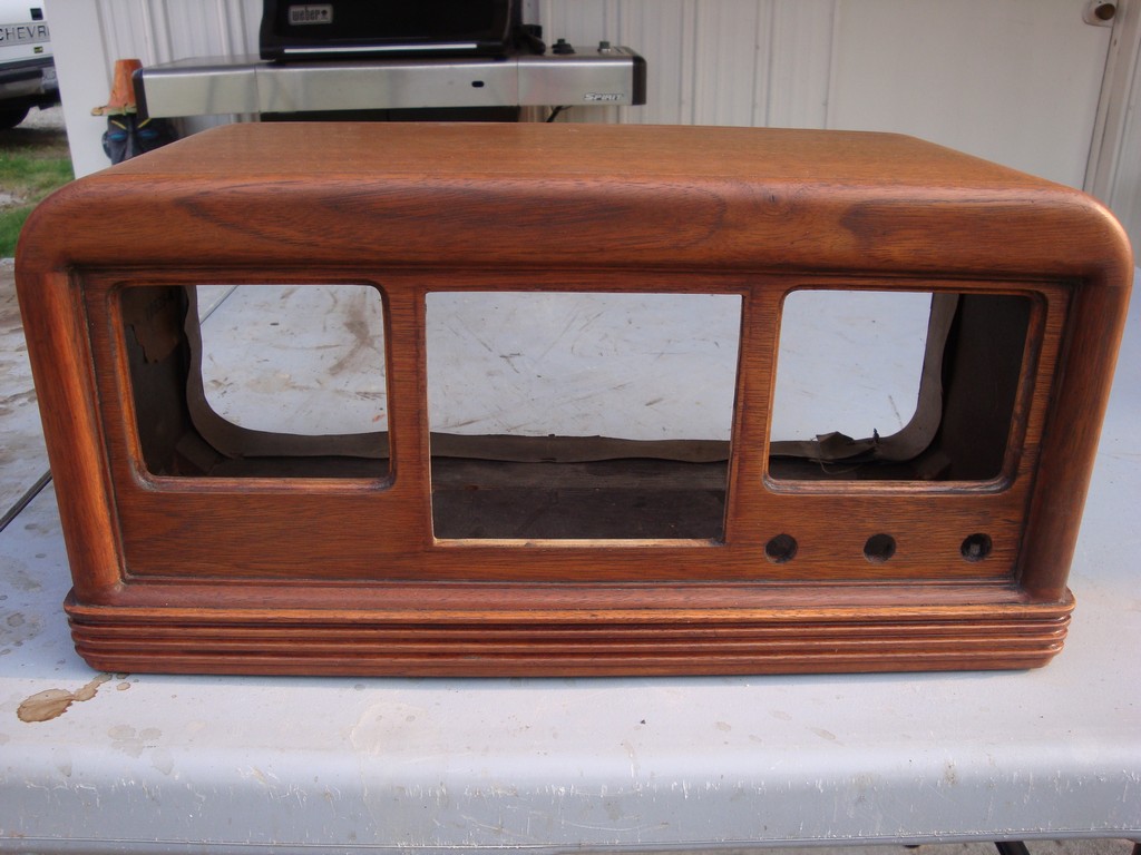

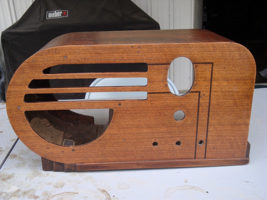

I gave the 42-22CL another coat of Constantine grain fill. Here's how it looks now:
[Image: http://www.philcoradio.com/images/phorum...0005-3.jpg]
Notice how the really bad scratches that were on the right side of the cabinet front are barely visible now. Using a wet rag and a hot iron (thanks for the tip, Arran), I was able to steam out the worst of the scratches.

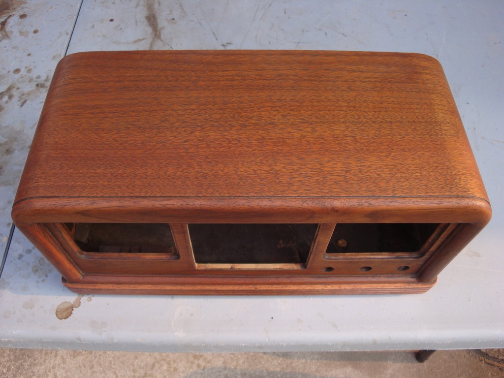

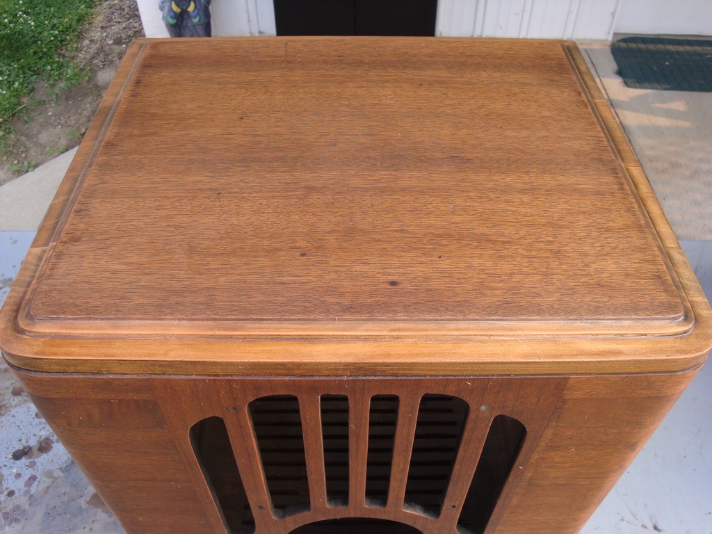

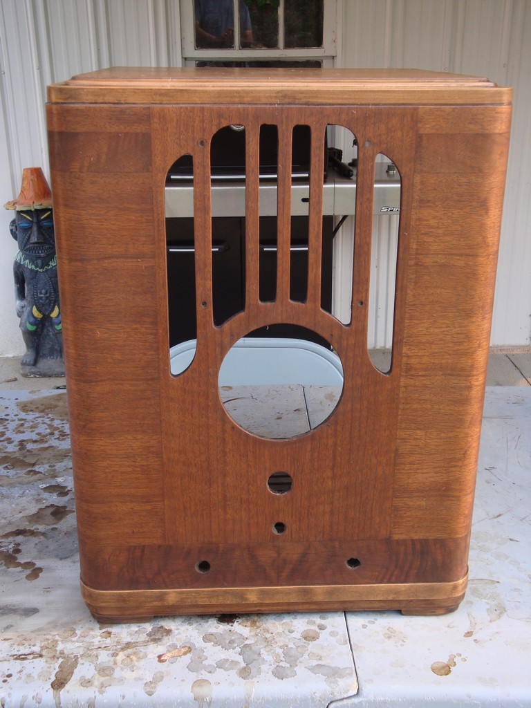

I also sanded down the 38-2670 cabinet, spray sealed it, and let it bake in the sun most of the afternoon. I then set it in the shade to cool off. Afterwards, I started filling grain on it.
[Image: http://www.philcoradio.com/images/phorum...0003-5.jpg]
[Image: http://www.philcoradio.com/images/phorum...0004-3.jpg]
I only managed to get one coat on the top and front. I still have to give both sides the first coat of grain filler.
