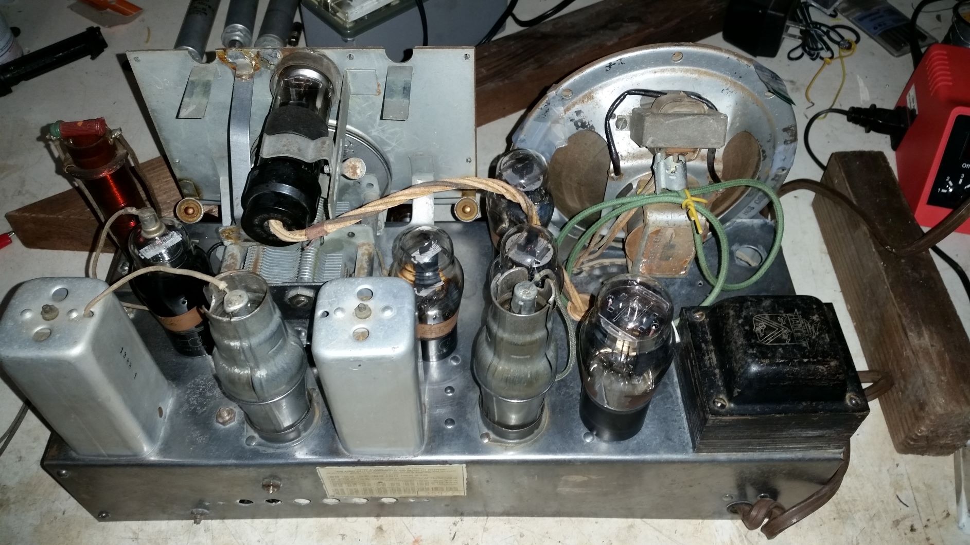

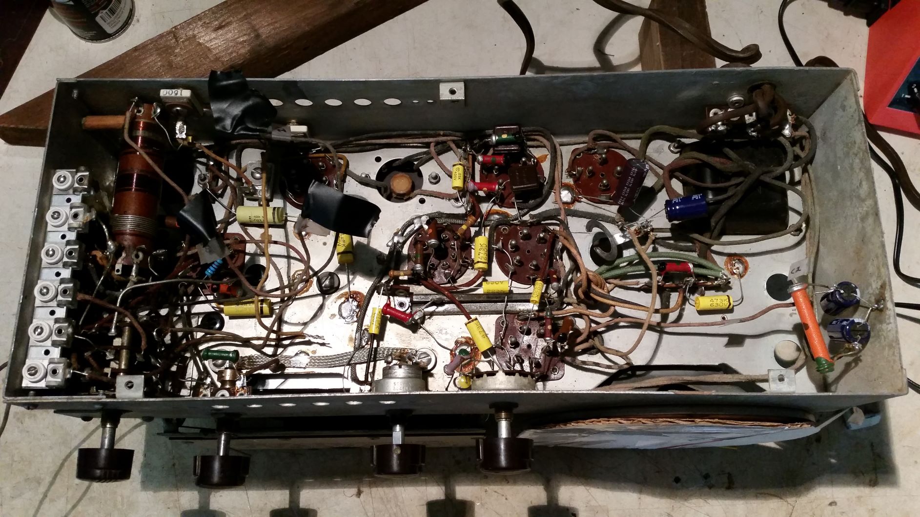

While I am thinking, here are some more pictures. The only thing missing from the chassis are the tall "Solar" electrolytic caps. I am still deciding whether to cut these open and restuff, or replace them, leave disconnected and add capacitors under the chassis.
Anyway, here is a view of the recap work:
And here is the top, valves back in place and playing on AM.
Posts: 4,511
Threads: 425
City: Boston
Gee the chassis cleaned up very nicely. Hope you get it all to your satisfaction soon.

I should mention two things about the under chassis pic:
1) The electrolytics are only tacked in place (safely enough) for a bit of testing. They won't stay like that
2) The push button and adjustable coils for the AM presets are not installed. They were tested briefly over the weekend, and work nicely. For now, I want them out of the way while I continue testing.
