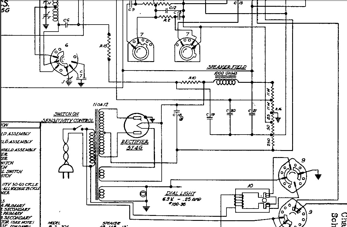

I have a question for you about the candohm. I replaced mine for longevity reasons and piece of mind. The schematic has the candohm grounded on (I think) the 3rd tap. Did you do this? I can't see any wires going to ground in your chassis pics. I'm trying to find some noise issues with my set and I grounded it there.
#54
Please post schematic or link here. something does not sound right to me. Candohm is usually used as a voltage divider and rarely terminates in B- or ground in 3rd tap of a four tap unit if that i's what you have. Not unheard of, but let's have a look. Associated capacitors etc... will tell us what is right. Maybe perfectly OK and third hook is B-, and there might be bias supply, well, hard to do this blind.
#55
R16, 6 tap candohm.
www.nostalgiaair.org/PagesByModel/500/M0025500.pdf
#56
OK I see 5 section candohm on schematic, and as suspected creates negative bias supply with respect to ground if properly wired and part is good. Some Zenith power supplies and voltage dividers are quite tricky. Has been my rule that if one section of candohm is bad, cut it out, mount a terminal strip, get appropriate discrete resistors and dress them against chassis to disperse heat, fuse the set, and of course replace electrolytics and all paper caps.
Since there is a voltage chart, a quick check of the audio section should reveal any major flaws. Beware that modern meters do not load down circuits, so higher readings are likely in many cases.

Yes there is the GND tap, I think third from the bottom.
Obviously I followed the schematic and GND-ed it. I used a green wire to connect it to the chassis, I think it is visible on the photo; if not I could post a new one but of course without it it wouldn't work.
Mike N.
#58
NUTS! I see it now. Thanks morzh.
