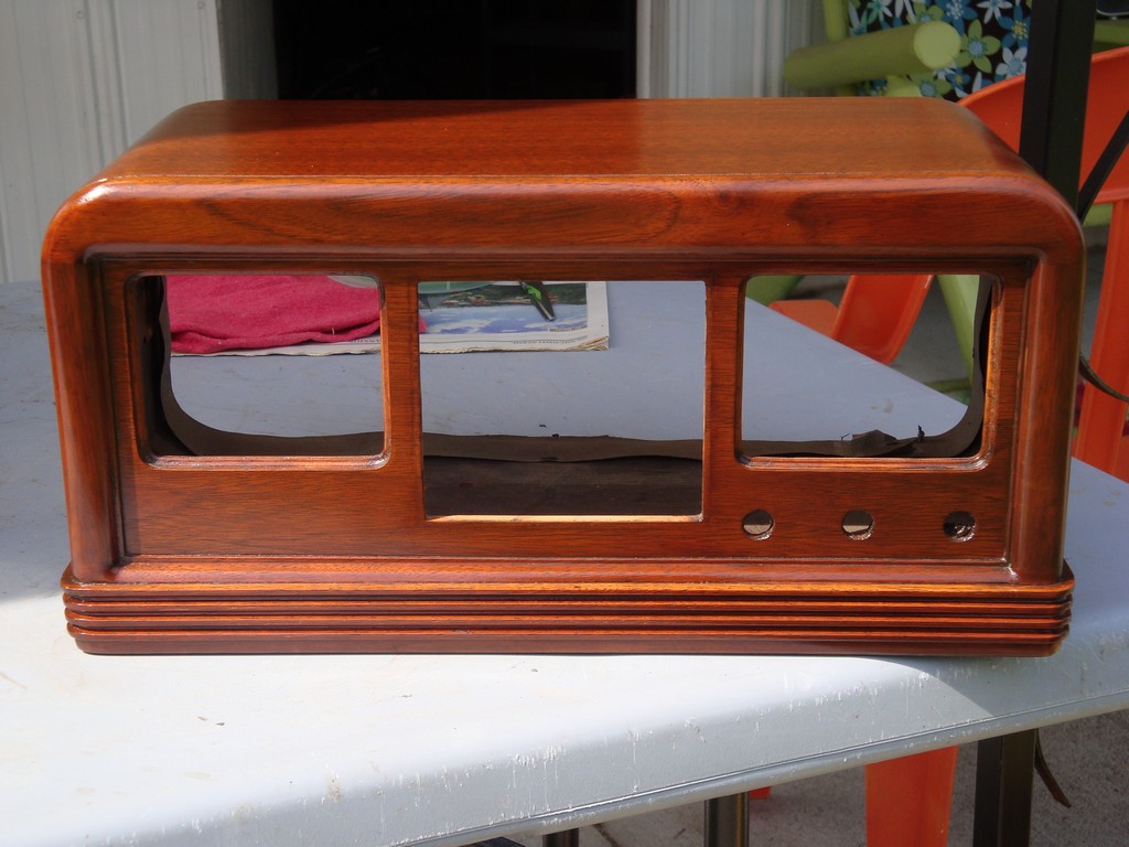

Next came the 42-22CL cabinet. I sanded it down with 320 grit while I was letting the 610T trim dry. After sanding, wiping down, and blowing it off with a can of compressed air, I applied two coats of Medium Walnut toner to it.
[Image: http://www.philcoradio.com/images/phorum...0008-2.jpg]
This cabinet is turning out quite well indeed; actually, better than I expected it to. I think the average person will not notice where the scratches were, or at least, they will not know how bad those scratches were. I can see a small bit of scarring, but then again, I know where they were so I will notice the area more.

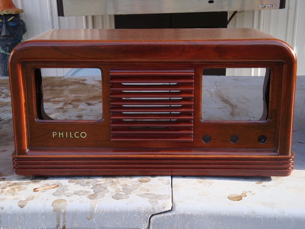

I applied dark brown lacquer to the inner edges of the 610T grille openings, after which I gave it another light wet sanding, this time with 600 grit - except in the area where the PHILCO decal is placed. Then, I applied PHILCO decals on the 610T and 42-22CL cabinets. I let both dry in the sun a while. Then, I applied two good coats of clear Deft to the 610T cabinet.
Here's how the 610T looked after stripping, and after the first coat of grain filler:
[Image: http://www.philcoradio.com/images/phorum...0001-5.jpg]

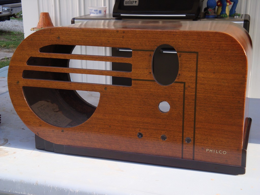

And here is how the 610T looks now:
[Image: http://www.philcoradio.com/images/phorum...0001-7.jpg]
This 610T has turned out to have the best grain fill job I have ever managed to accomplish. It is very smooth and looks great. Oh, yes, it has imperfections - chiefly from where someone, probably a kid, drilled several indentations in the front panel. I filled all of those with Timber Mate wood filler. Somehow, I did not get two of them completely filled, but oh well...it still looks much better than it did before I began to work on it.

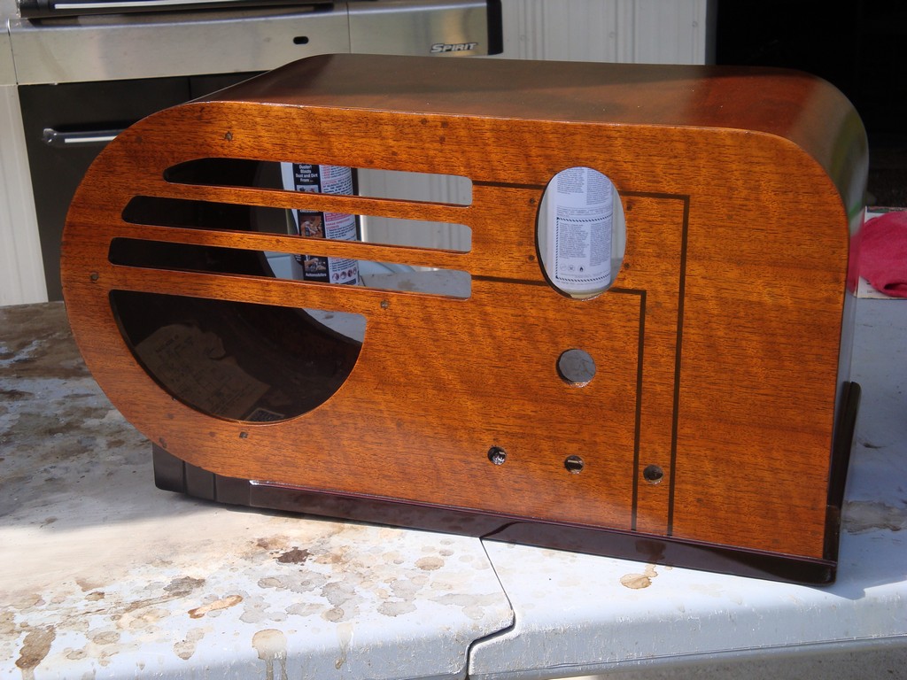

I went out this morning and was rushing my work as I had to be away this afternoon. I sprayed what I thought would be final clear coats on the 610T, and stupidly left it in the sun. Result: Minor bubbles/blisters on the front panel, and a few serious ones on the bottom trim in front.  I'm hoping I can save all of my hard work on that cabinet with some careful wet sanding. I feel the ones on the panel itself will be fairly easy to sand smooth; I'm not so sure about the ones on the bottom trim, but I will do the best that I can with it. Lesson learned - do not leave a freshly lacquered cabinet in the sun!
On the good news side, I did get the second coat of grain fill applied to the top and front of my 38-2670B cabinet. I did not have time to apply the grain filler to the sides, I will do that tomorrow if it isn't raining.
OK, if anyone's still following along, here's a look at today's progress.
I carefully wet sanded the 610T cabinet with 400 grit wet/dry paper. I ended up having to mask off the cabinet and re-tone the bottom trim on front. Later, it received a few more coats of clear Deft. As far as I am concerned...it is done. Not quite as good as it would have been, but still pretty good. Photos later.

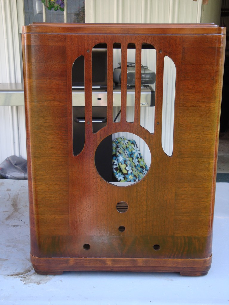

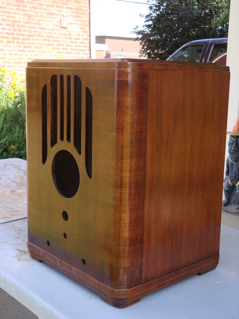

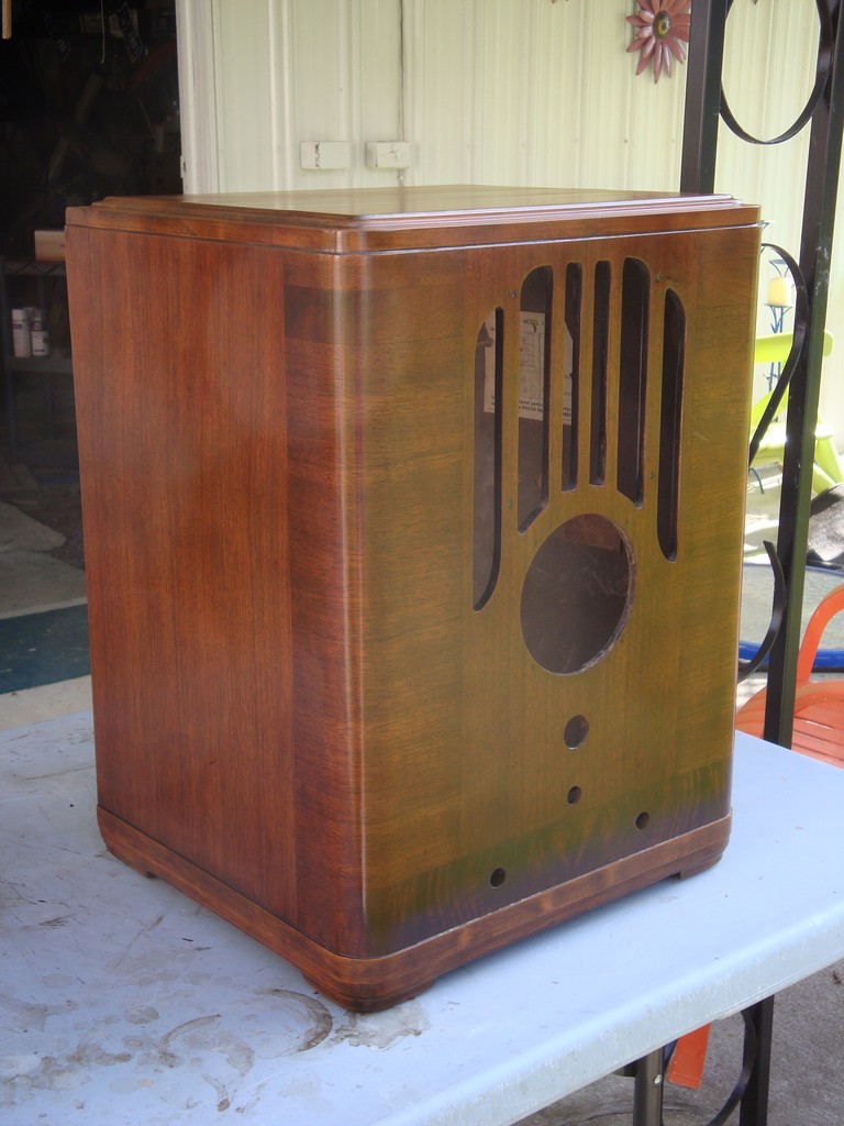

Yesterday, I began to sand down the 38-2670B cabinet in preparation for its first coats of lacquer. About 3/4 of the way through the job, though, it began to thunder outside, so I quit for the day.
This afternoon, I sanded the one side that did not get sanded yesterday. Wiped the cabinet down, sprayed it with compressed air, wiped it down again. Then, I gave it a coat of sealer followed by two coats of Medium Walnut toner.
The results:
[Image: http://www.philcoradio.com/images/phorum..._00001.jpg]
[Image: http://www.philcoradio.com/images/phorum..._00002.jpg]
[Image: http://www.philcoradio.com/images/phorum..._00003.jpg]
As usual, light spots you see are reflections from the work table. The cabinet is a uniform color of Medium Walnut now, save for the upper trim which will get a darker shade of toner anyway.
The next step is to carefully mask off most of the cabinet, leaving only the upper white wood trim and the bottom trim exposed. These areas will receive a couple coats of a darker color - Perfect Brown Ultra Classic. I only want some mild contrast, not too dark. After this, if all goes well, the entire cabinet will receive its first coats of clear Deft lacquer.
