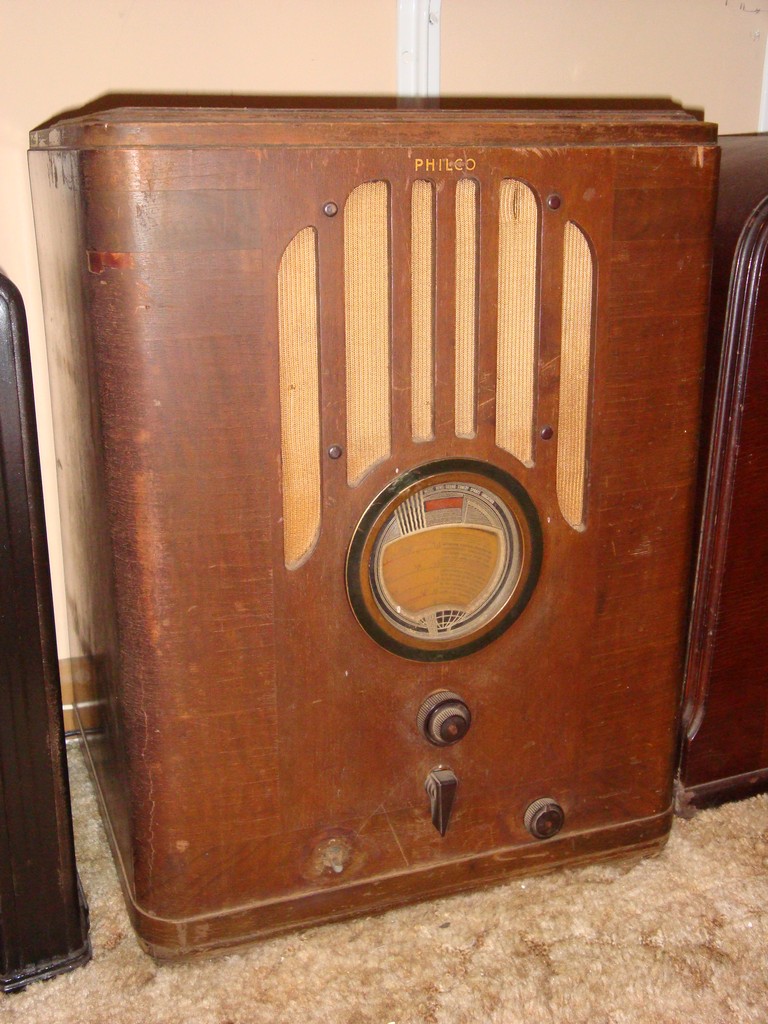

Now, in case you are wondering why I am refinishing this empty cabinet instead of the original 37-670 cabinet, here is why:
[Image: http://www.philcoradio.com/images/phorum..._00001.jpg]
I bought this set just over a year ago, and it is mentioned here:

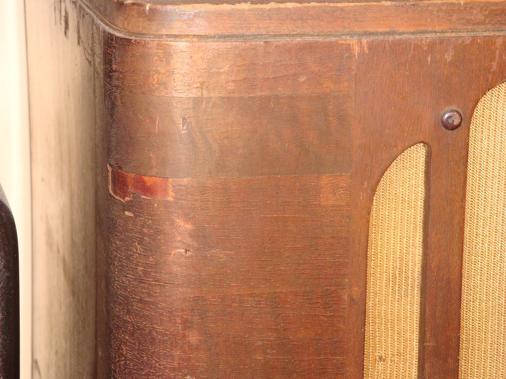

You will notice this cabinet has multiple issues. First, a missing bit of veneer at upper left:
[Image: http://www.philcoradio.com/images/phorum..._00002.jpg]

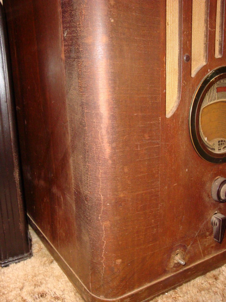

Cracking along the lower left edge where the veneer curves over from the front to the side:
[Image: http://www.philcoradio.com/images/phorum..._00004.jpg]

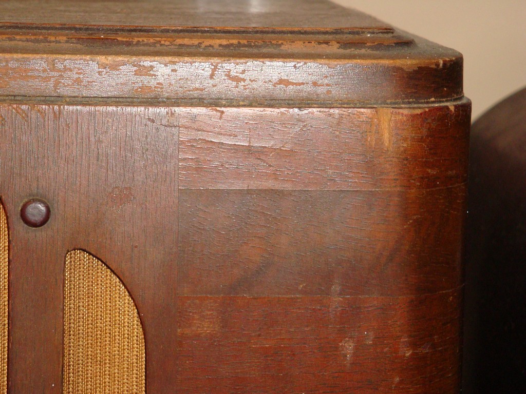

And someone did a little wood carving at upper right:
[Image: http://www.philcoradio.com/images/phorum..._00003.jpg]

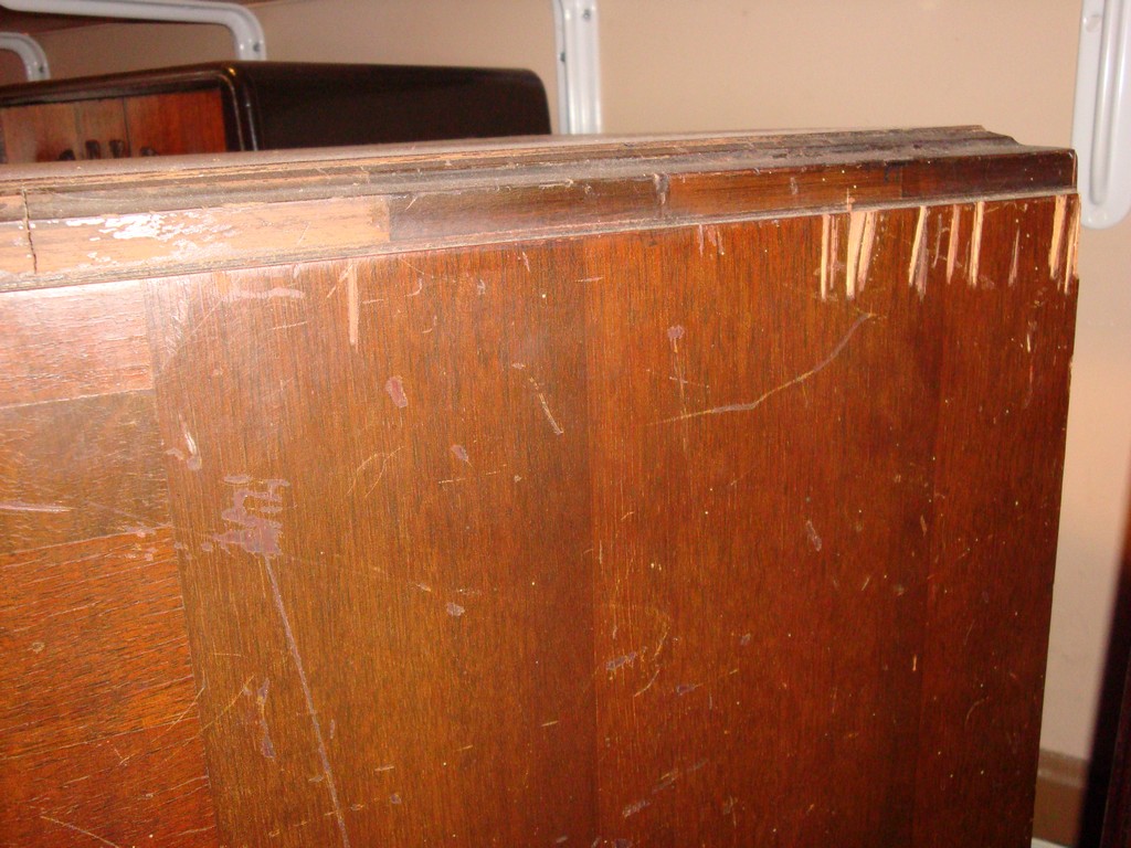

and along the upper right side:
[Image: http://www.philcoradio.com/images/phorum..._00005.jpg]

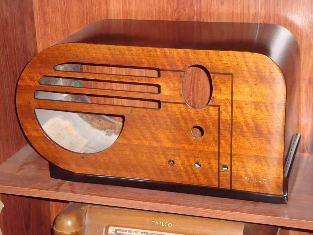

Today's progress report:
With many thanks to Phorum member DeckApe, I received the "B'DC'ST - POLICE" decal I needed for the 42-22CL today. So I applied it to the cabinet this afternoon, then gave the cabinet two coats of clear Deft. The result:
