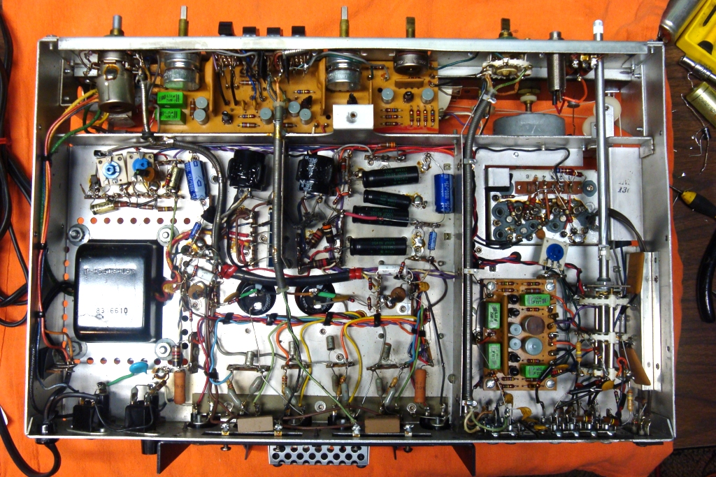

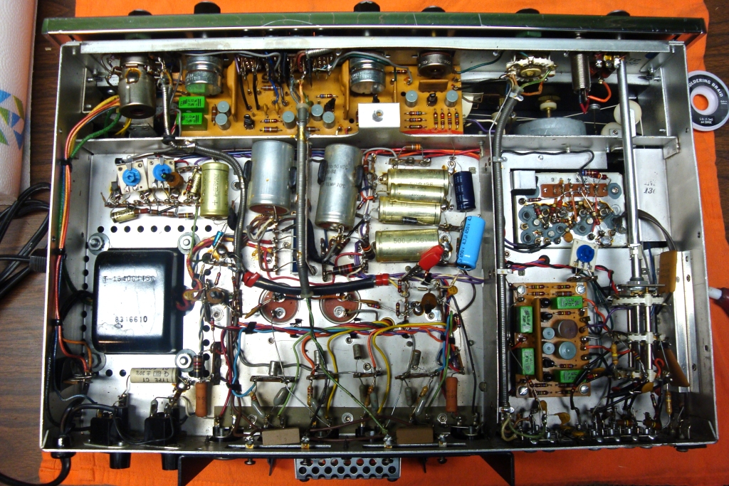

The 4400 plays loud and clear, on both left and right channels now. All of the under-chassis power supply and audio section electrolytics have now been replaced. I also replaced both 2N2924 audio transistors, and replaced the line-to-ground tubular cap with an X1/Y2 safety cap.
To review, a "before" picture:
[Image: http://www.philcoradio.com/images/phorum...0001-2.jpg]
and the "after" photo:
[Image: http://www.philcoradio.com/images/phorum...0001-3.jpg]

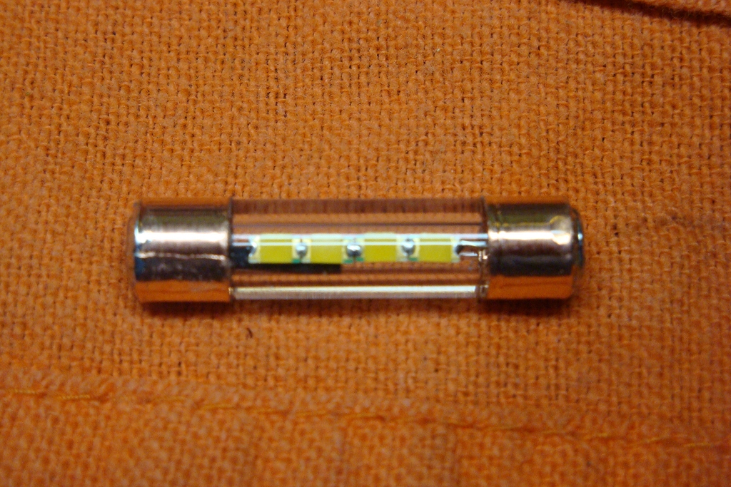

Today, four LED festoon lamps arrived.
[Image: http://www.philcoradio.com/images/phorum...e00003.jpg]

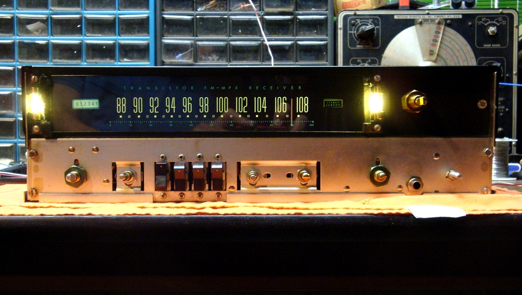

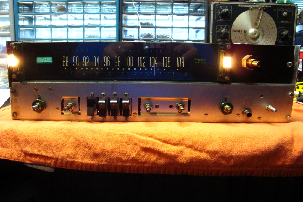

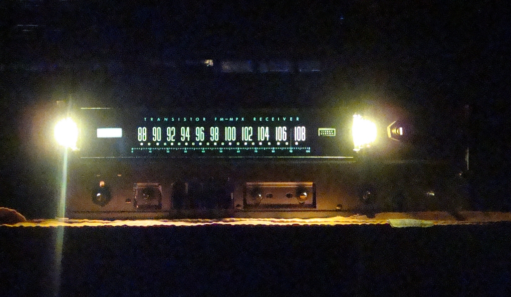

I promptly installed two of them in the 4400. The dial looks much brighter now, although these photos do not do the set justice, I think:

I'm really happy with how this receiver turned out. It works great and looks great!
