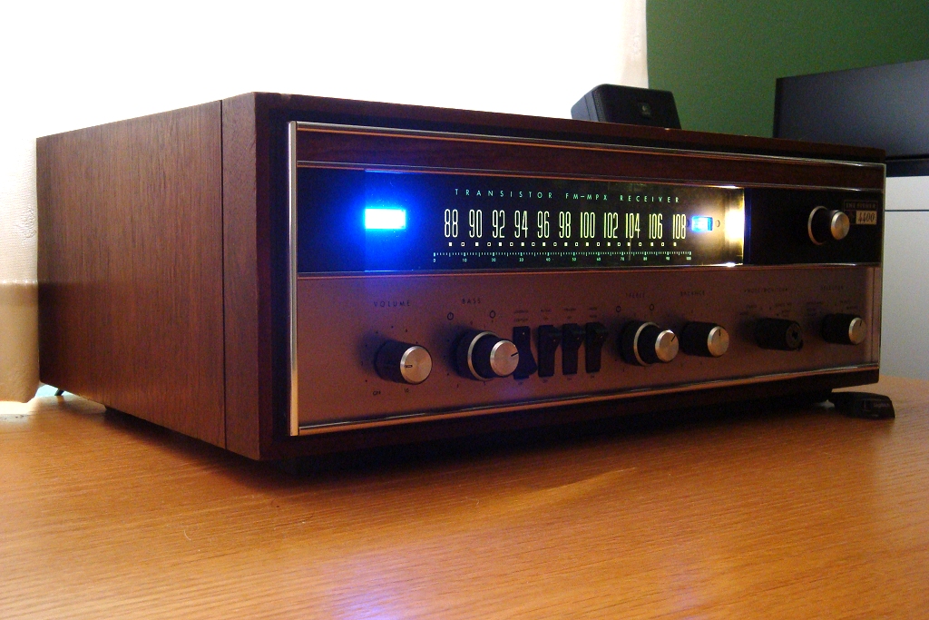

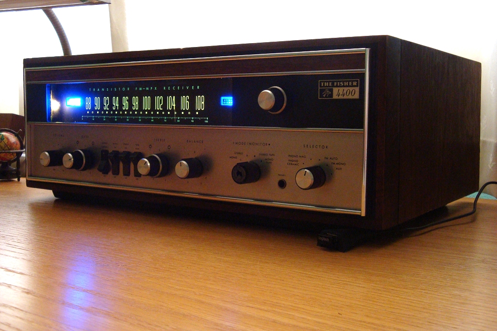

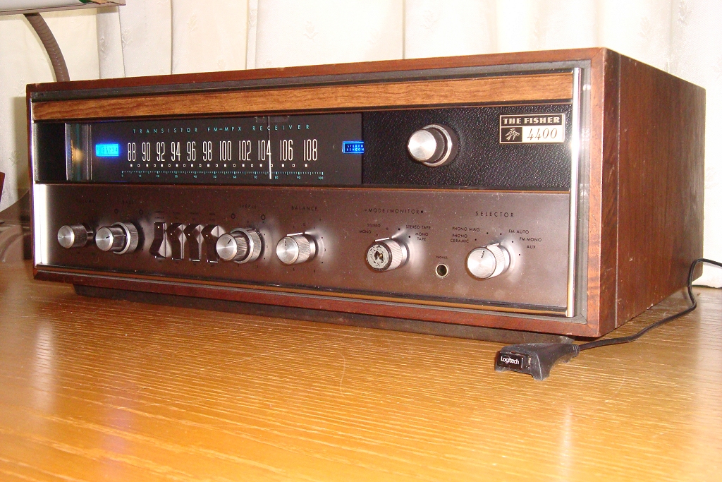

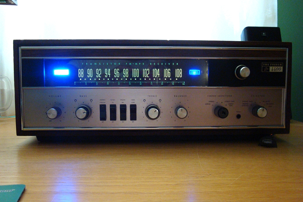

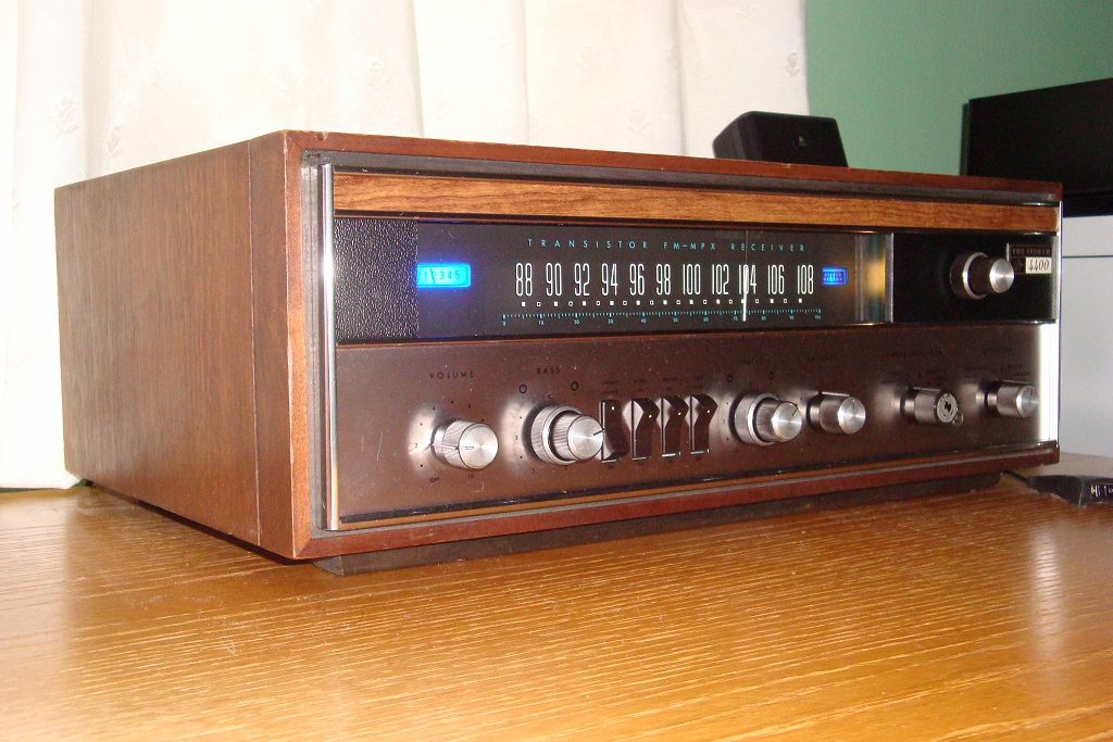

Photos, dimly lit room with no flash:
[Image: http://www.philcoradio.com/images/phorum...0001-5.jpg]
[Image: http://www.philcoradio.com/images/phorum...0002-4.jpg]
[Image: http://www.philcoradio.com/images/phorum...0003-1.jpg]
and two with flash:
[Image: http://www.philcoradio.com/images/phorum...e00004.jpg]
[Image: http://www.philcoradio.com/images/phorum...e00005.jpg]
I know Arran probably will not approve  ...but I really like how the blue LEDs look in this receiver. In my opinion, they really make the dial look great! This is the only late 1960s Fisher receiver I have seen so far that uses a blue Stereo Beacon and a blue tuning meter.

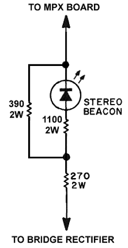

This afternoon, I decided to try an experiment on my 4400.
You may remember that the Stereo Beacon circuit had no electrolytic capacitor, as follows:
[Image: http://www.philcoradio.com/images/phorum.../led03.jpg]
However, the other Fishers I have worked on recently have Stereo Beacons with at least one electrolytic, like this:
[Image: http://www.philcoradio.com/images/phorum.../led02.jpg]
So...I added the 200 uF electrolytic. I don't know if it was never present in my 4400, or if someone removed it along the way for whatever reason...but after I added this capacitor, the Stereo Beacon LED became much more responsive and acts more like an incandescent lamp now in terms of response time - when you tune off station, it goes out like it should, with very little delay.
I am now very pleased with the LED Stereo Beacon conversion.

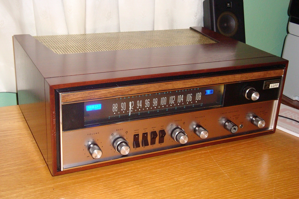

A semi-formal portrait - the 4400 with its "new" clothes, a refinished cabinet:
[Image: http://www.philcoradio.com/images/phorum...0003-2.jpg]
The 4400 has become my "daily driver."
I will try to touch up the flaws in the lacquer on the left front edge when warm weather returns.
My 440-T cabinet (which this 4400 resided in until this past weekend) needs a screen like the gold-colored one on top of this cabinet. I found a source that makes repros at a reasonable price; they also make reproduction knob caps, so I'll be getting a cap to replace the missing one on my 4400, as well as a screen for my 440-T cabinet.
