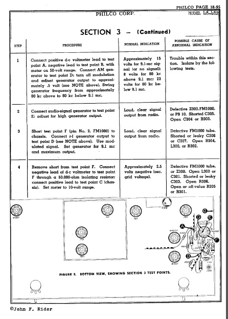

I have run the troubleshooting procedure listed in the Nostalgia provided Rider literature.  Sections one and two checks are all within specs.  In the section three procedure I’ve run into a roadblock, and this is where I’m looking for help.
The introduction to section three troubleshooting says an rf AM signal generator needs to produce at least .5 volts output for this procedure.  If that isn’t possible the signal can be injected further upstream.  My vintage Simpson 315 signal generator is capable of only .5 millivolts output.  However, I tried testing with the signal injected at test point D with the .5 mv signal anyway.  I found that there was no response in the speaker at 9.1 mhz input, but did hear a response when the frequency was several khz off the 9.1 mhz frequency.  In fact there was a null position where nothing was heard and a tone heard either side of the null.  This with no modulation of the rf signal.  Voltage measured between test points A and D was 18.9 vdc at the null and 18.8 either side of the null, so no significant change.
I then went to steps two and three since it failed step one.  Audio signal injected at test point E and modulated rf signal at test point F yielded loud and clear signals.  Step four procedure yielded -2.5 vdc  (-2.9 vdc called for).
I then used the “less than .5 volt rf” procedure with the same results.

The problem could be in the FM1000 circuit or Z300, but it could be in the FM IF stages also.
The fact that you have -2.5 V at step 4 is a good sign, as it indicates the FM1000 and Z300 is oscillating. Keep in mind that this is an oscillating FM detector, where the oscillation frquency locks to the incoming IF signal and follows the FM modulation. This causes a variation in plate current of the FM1000 tube, which produces the demodulated audio signal. The microphonics is normal, as the frequency of the FM1000 oscillation is affected by the vibration as you tap the chassis and is an indication that the FM detector is working correctly.
In order to work properly, the FM1000 needs an adequate signal at test point D. If there is not enough IF signal, the frequency will not lock and you get no audio out.
If you have aligned Z300 according to the procedure and you have the -2.5 V at test point F, then the detector may not be the problem. Rather there may not be enough 9.1 MHz IF signal feeding the FM1000.
Have you aligned the 9.1 MHz IF stages per the procedure and do all tuned circuits peak properly? With a properly operating and aligned 48-480 you should hear loud rushing noise on FM when tuned between stations. If you don't hear noise, then there is an RF or IF gain problem, or Z300 is not tuned correctly.

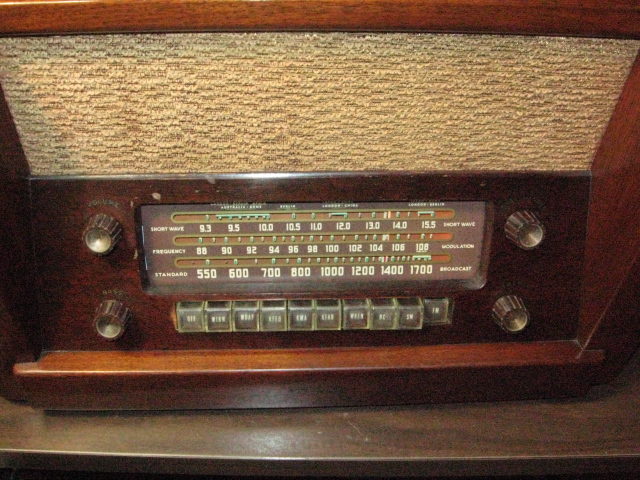

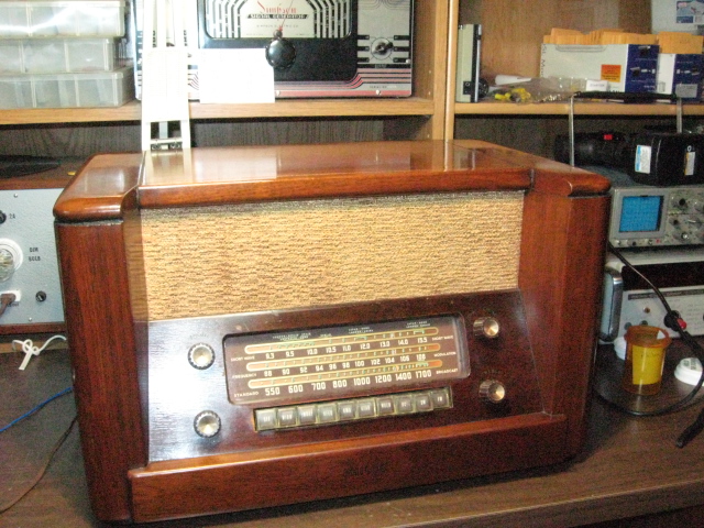

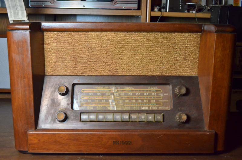

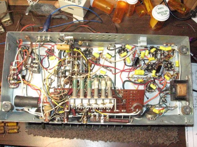

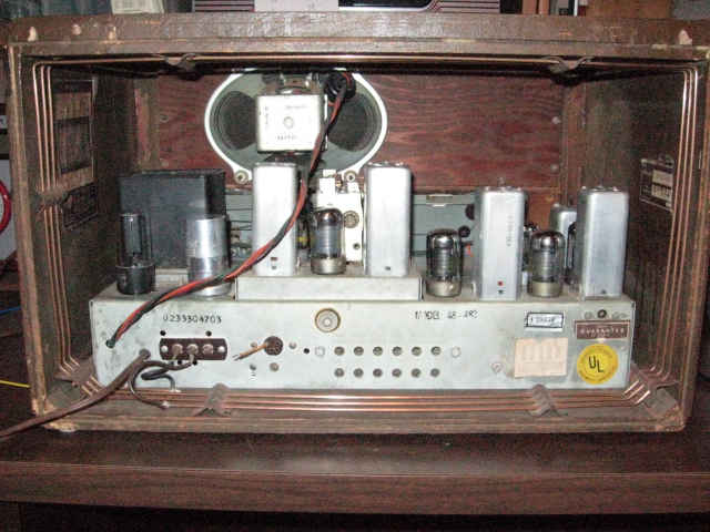

Anyway, it plays beautifully now.  Here are some before and after photos.  It needed a couple tubes, the Z402 IF, and a new dial glass, and of course all paper and electrolytic caps.  The cabinet looked pretty rough when I got it.  I used the GoJo/Howard's treatment with amazing results.
