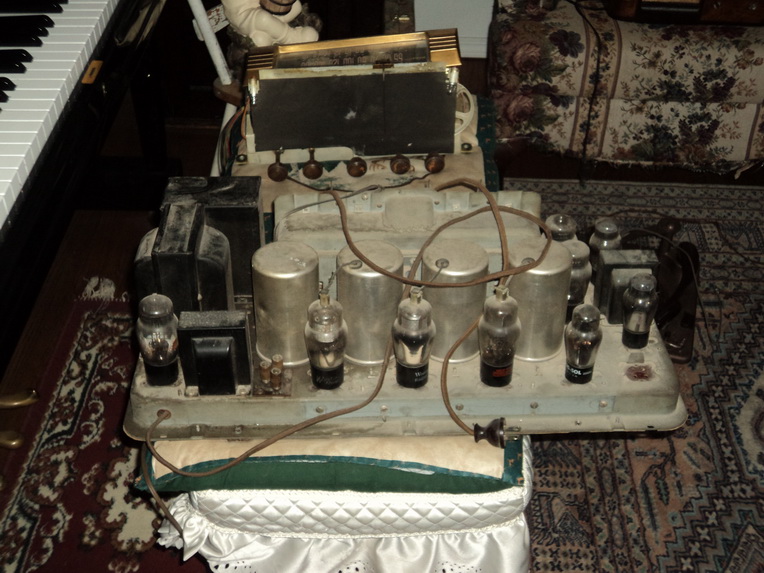

Hello,
I received a radio chassis from a friend.  It came with a Philco Model G speaker and I am sure the chassis is a Philco.  It has 7 tubes but does not seem to match a Model 511 or Model 86 chassis.  I want to restore it to working condition so my kids and grandkids can see how early radios worked.  I plugged it in and all tubes lit up except what I think is the rectifier tube (80).
The identification tag is mostly gone but I can make out Philedelphia Storage Battery Co. on the very bottom of the tag.
Would you help me please identify the chassis.

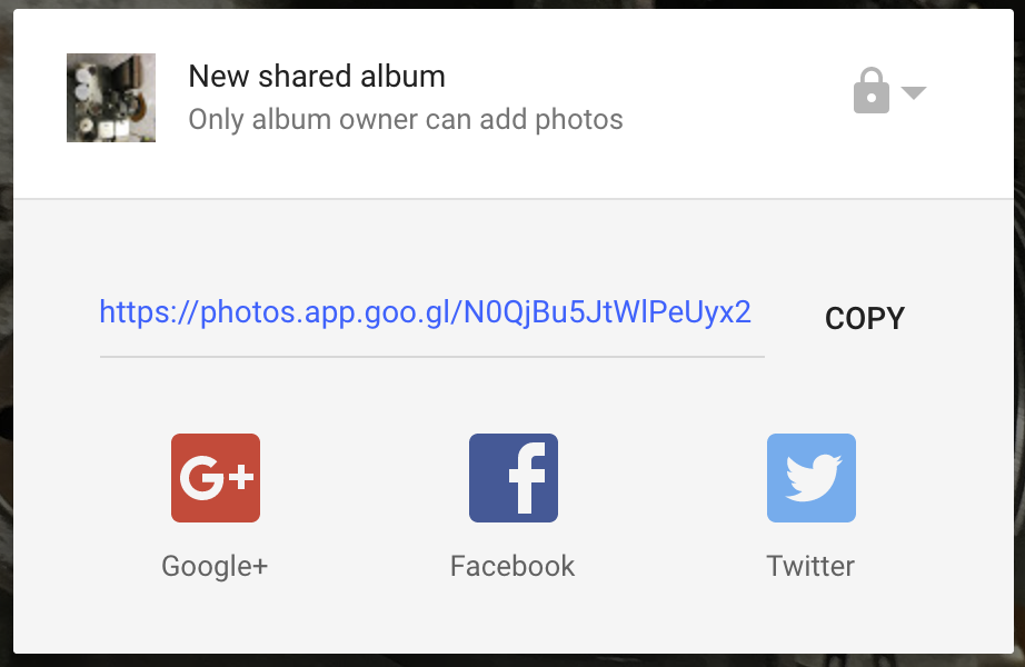

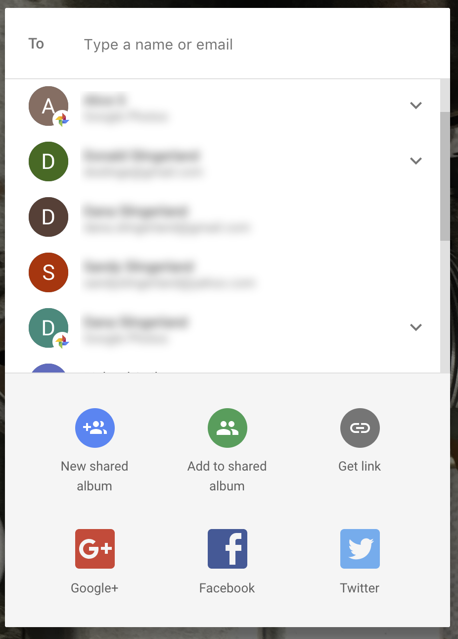

It is possible to get a shared link for a photo from the Google Photos interface:
1. Click share
2. Click 'Get Link'
3. Click 'COPY'
The resulting link can't be embedded as far as I can tell though - it's just a link to your photo in Google Photos that people have to click on. So you wouldn't use them with the

Without seeing photos, the only two early chassis with 7 tubes would be a 76 (73) or 77 (77-A).
73 = 25 cycle version of 76
77-A = 25 cycle version of 77
Edit: Ah, you posted some photos as I was typing. Looks to me like a 76 or 73 - volume control on left, local-distance switch on right. The 77 has the volume control on the right and a four-position tone control on the left (no local-distance switch).
Rich - awesome, the new links / hosting site works much better. I edited your post to fix one of the links.
Thank you!  Looks like the 77.77.A schematic is closest.  A couple of differences which probably don't make much difference.  On the output side where is shows two #45 tubes.  The one closest to the front of the chassis is a 45 and the one to the rear is a CX345.  The #27 tube on the schematic is a #127.  The three #24 tubes are there as well as the #80.
So is this a 76 or 77 chassis?
Thank you all.
Looks like I have a 76.  Now I need to get it working.

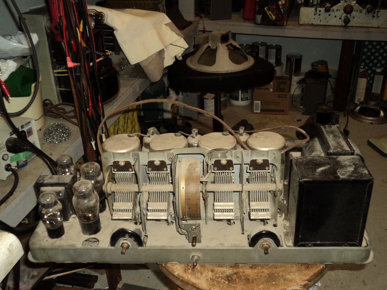

I just picked up this Philco chassis , and I don't see any marking on it to determine what model it is.
  It has nine tubes with push pull 45s, and an 80 rectifier.
 I can post more photos if needed. thanks

Either 95 or96.
It's a 96.
Tone control on left, translucent dial.
Model 95 has the volume control on the left and a local-distance switch on the right, and a brass dial.
Thanks Ron. It makes a difference when you have the schematic.
