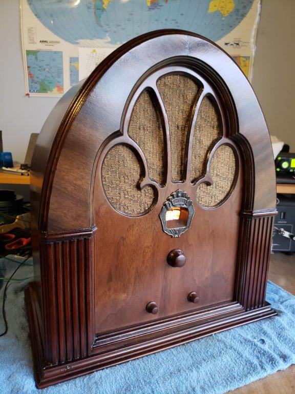

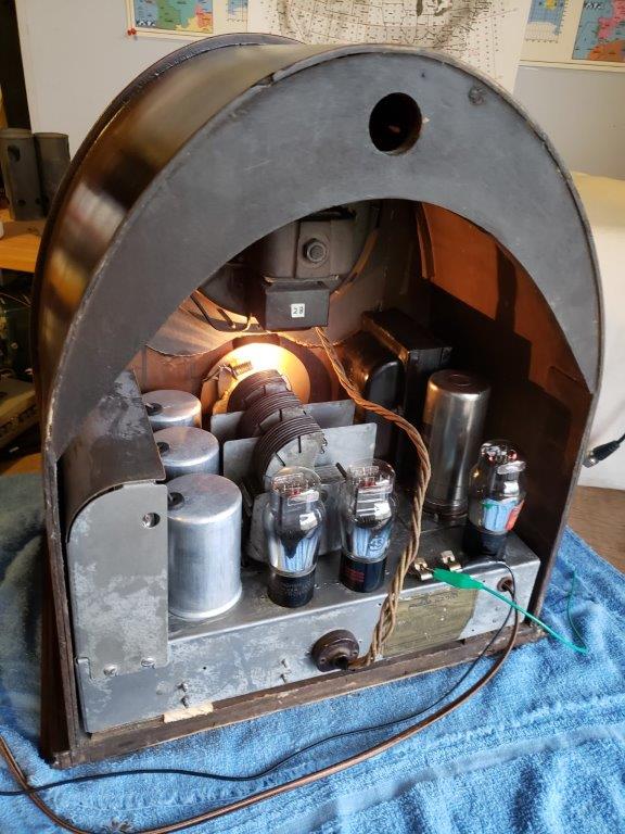

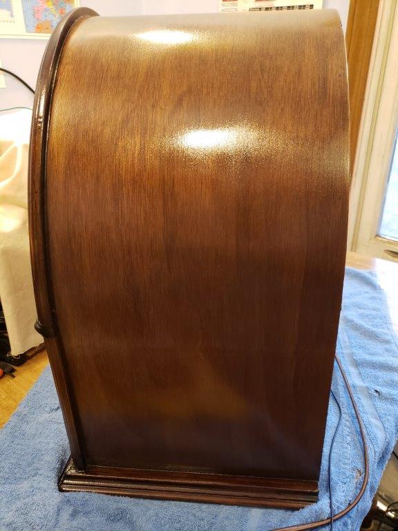

Here she is, cabinet by Benjamin sharp, chassis repair by me. Appreciate all the help from everyone! And it looks like this is just the start, we have other projects we are working on.

Posts: 15,323
Threads: 530
City: Jackson, NJ
Looks very nice!
