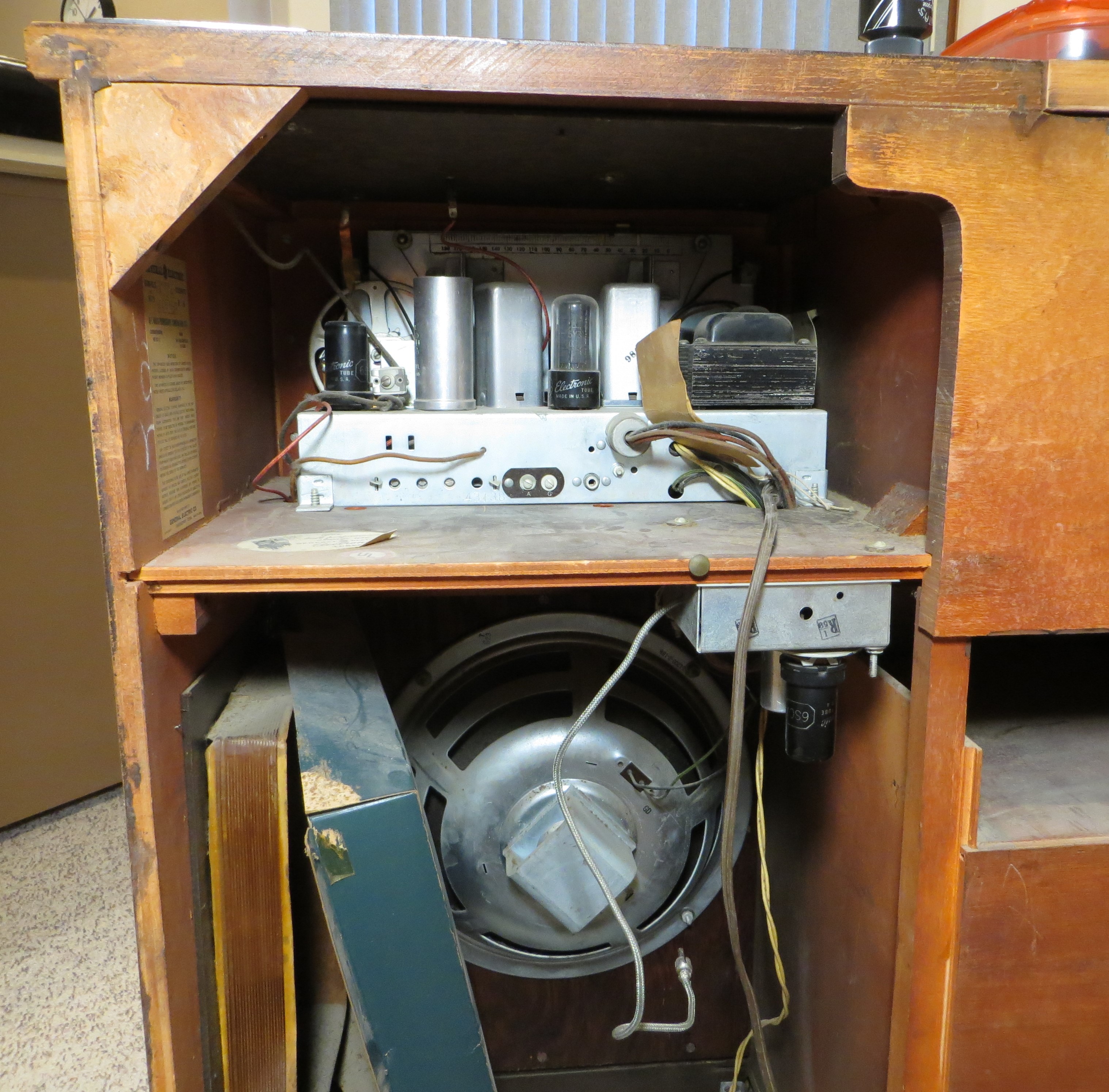

Here are two pics of the phonograph in it...
