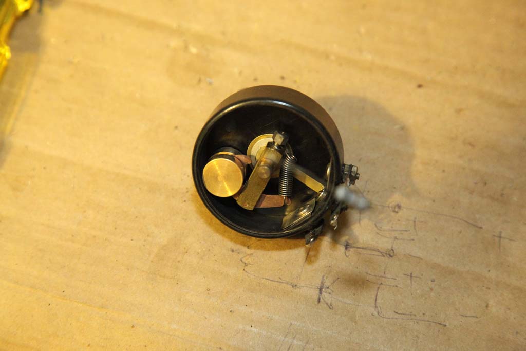

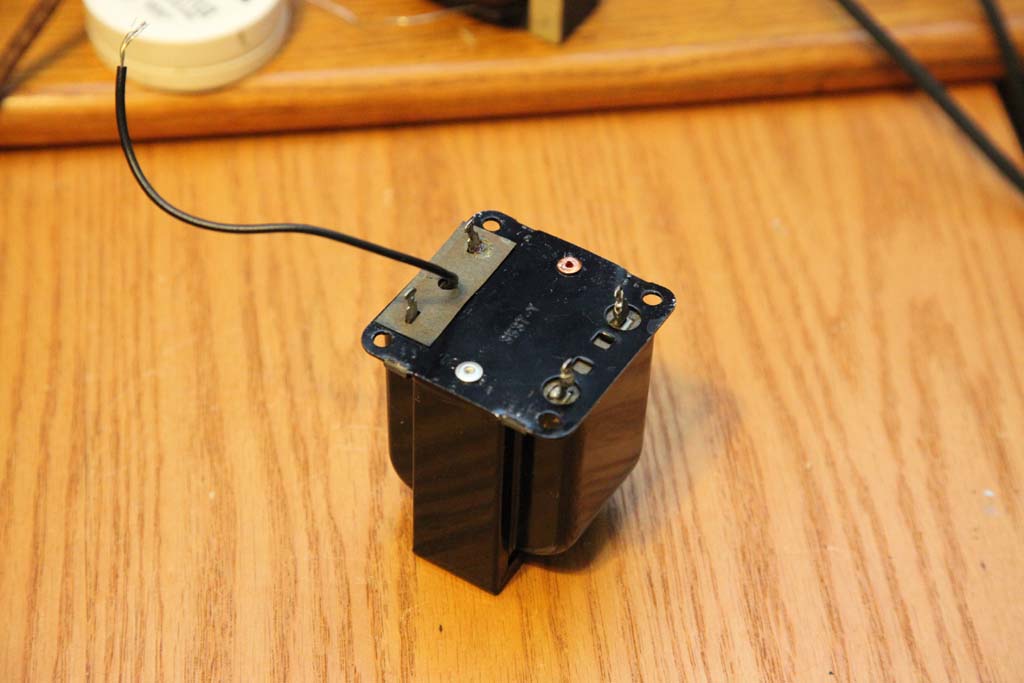

Sm'Pics.

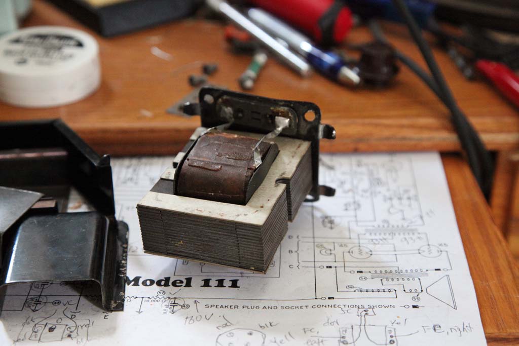

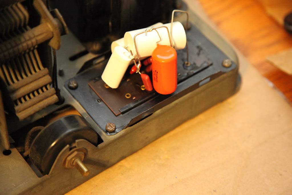

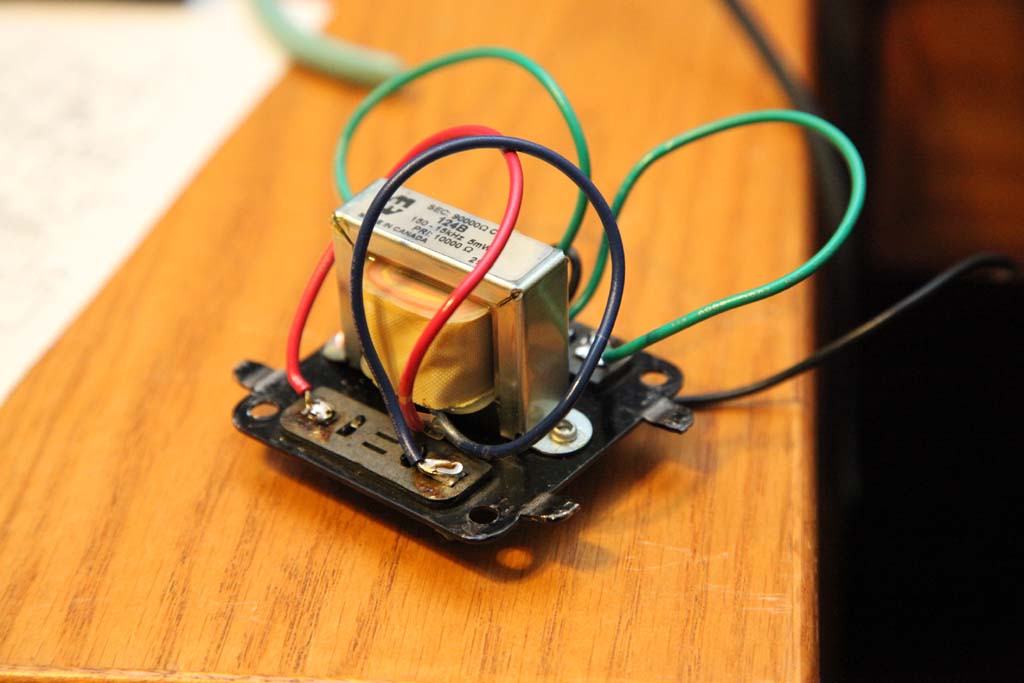

Capacitor block restuffed. Tone control: Old transformer New transformer stuffed.

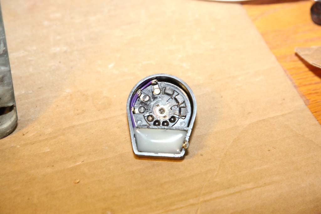

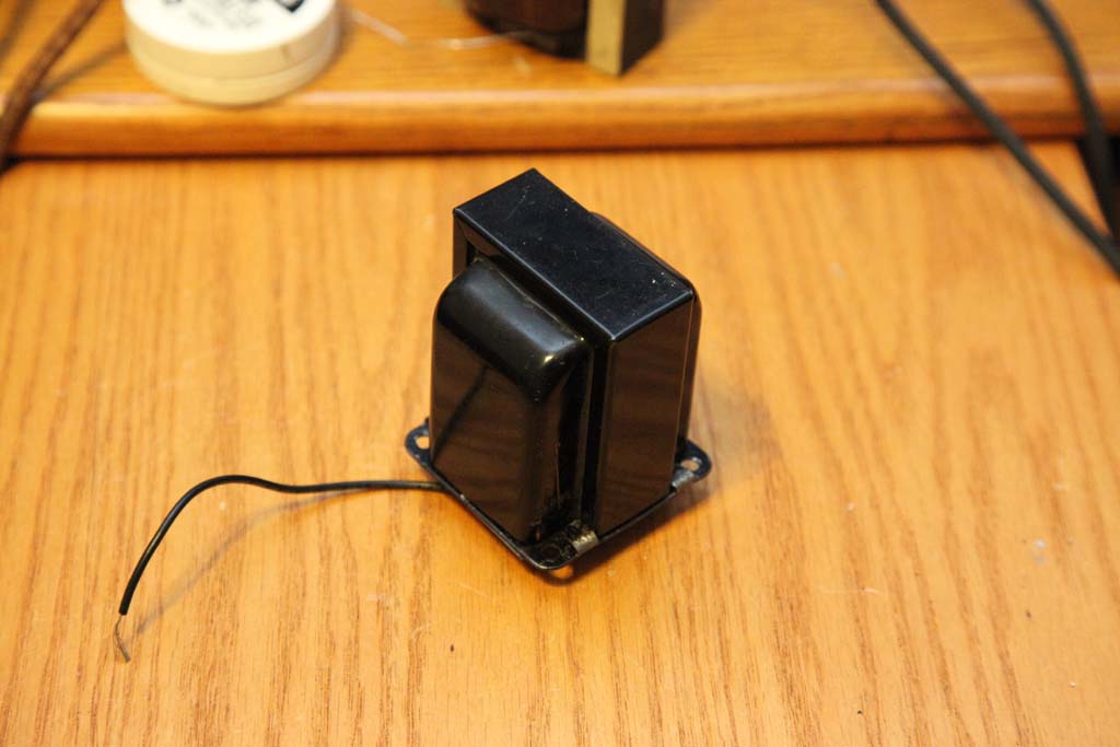

S'more pics:

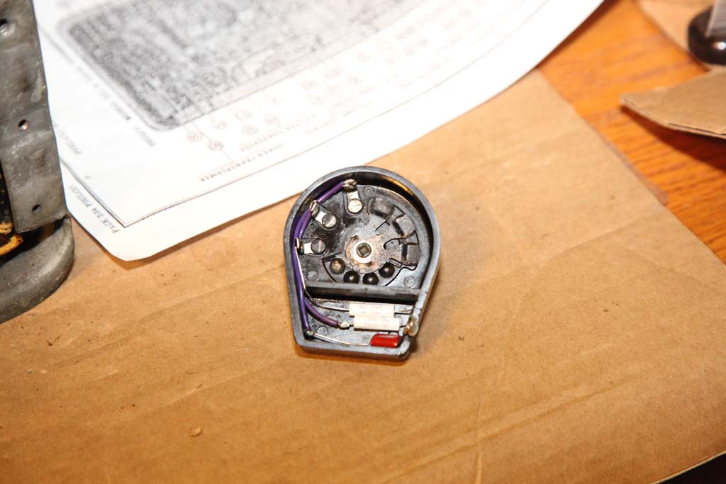

The transformer assembled: Old Volume pot: After alignment, shield installed.
05-03-2014, 11:31 AM
Now I have to cut off the excess shaft (this is again a replacement pot so it has universal shaft that can be easily trimmed (aluminum) and has easily opening back cover - you simply pop it for cleaning/lube) and install it back in the cabinet.

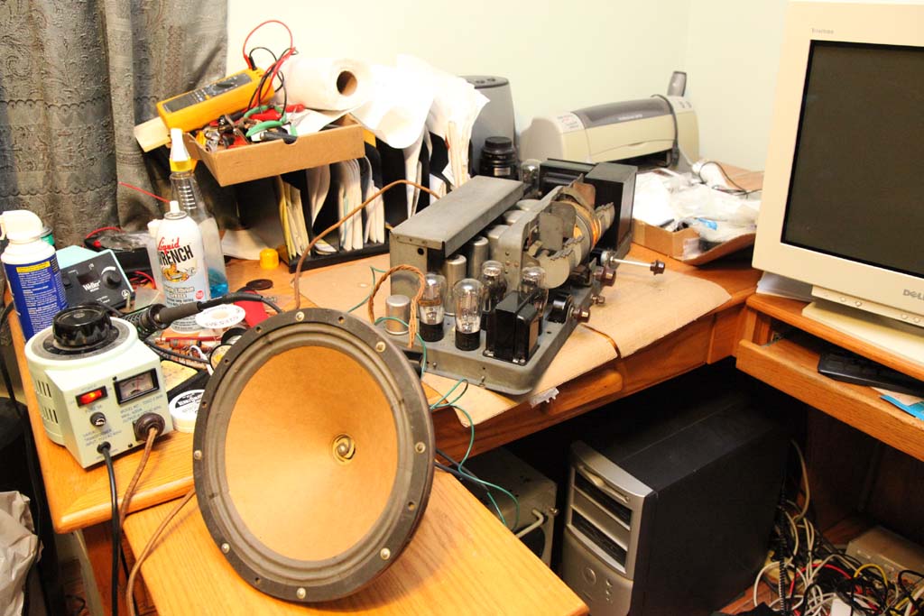

I think I need to either rebuild the speaker cord or reuse one from the other speaker - which is soft and in good shape - this one is cracking a lot). OK, changed the cord. So the speaker now is how I bought it on eBay except the transformer. It is interesting though, why the same radio sometmes comes with the wires cracking, and sometimes with pliable. Climate?

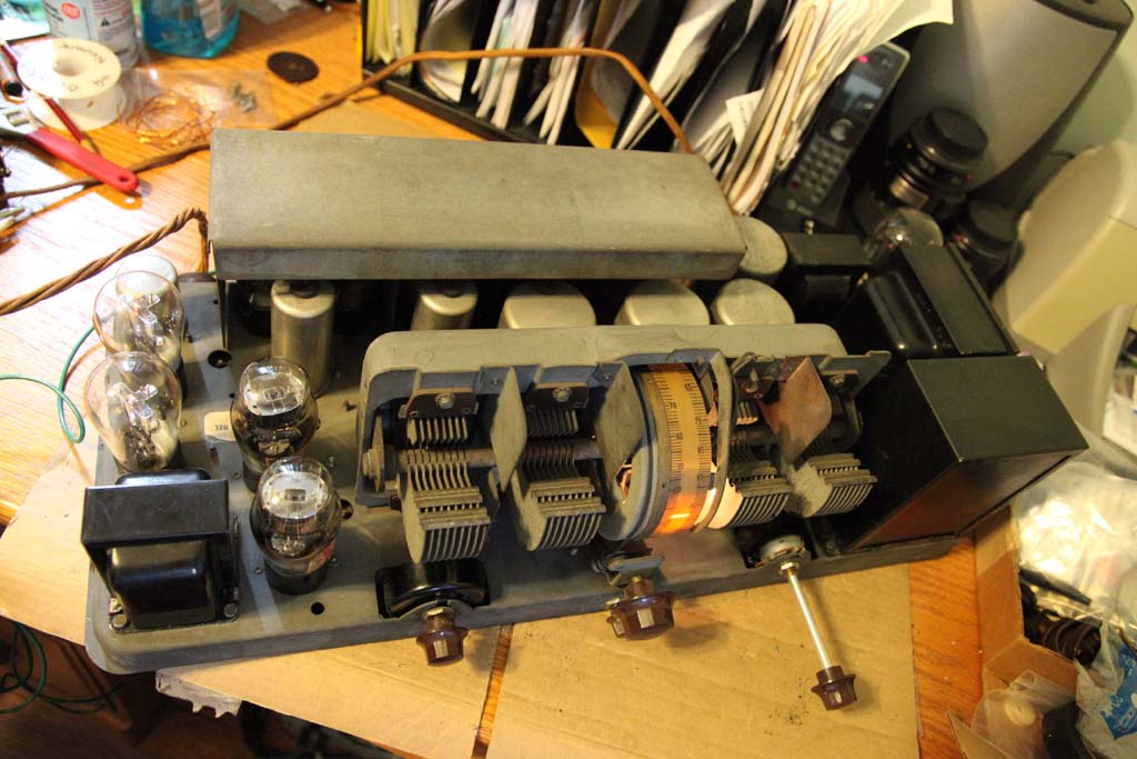

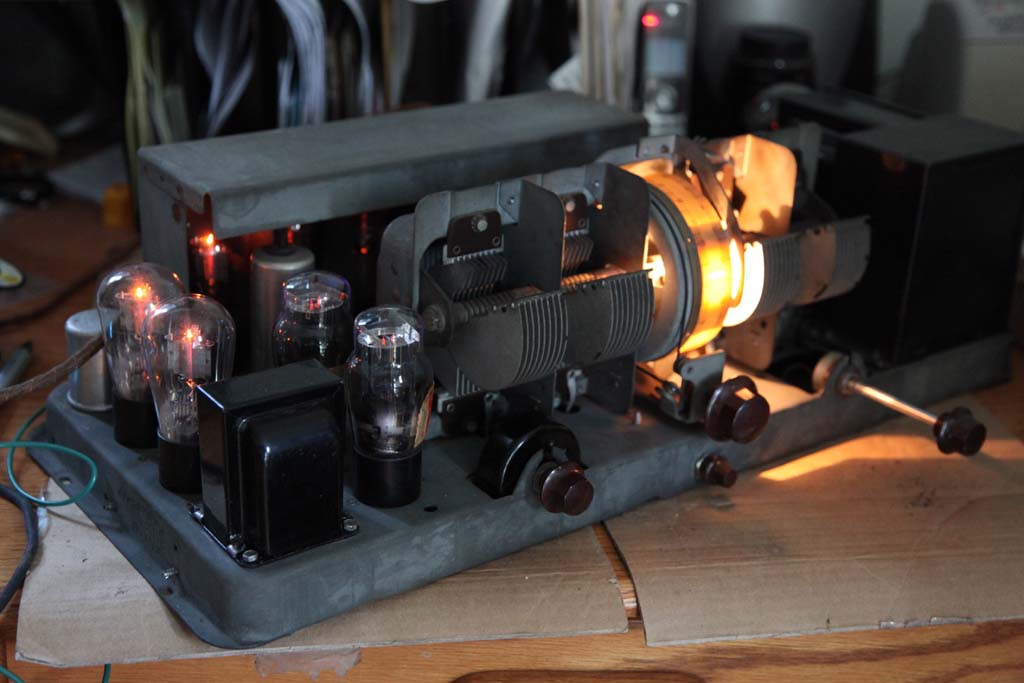

05-11-2014, 08:08 PM
Glowing red.
05-11-2014, 09:04 PM
Mighty Pretty Mike. Brings back fond memories of working on my 111 and 112. As for the labels, I just used printer paper and rubber cement. Probably not accurate but the graphics are correct.
