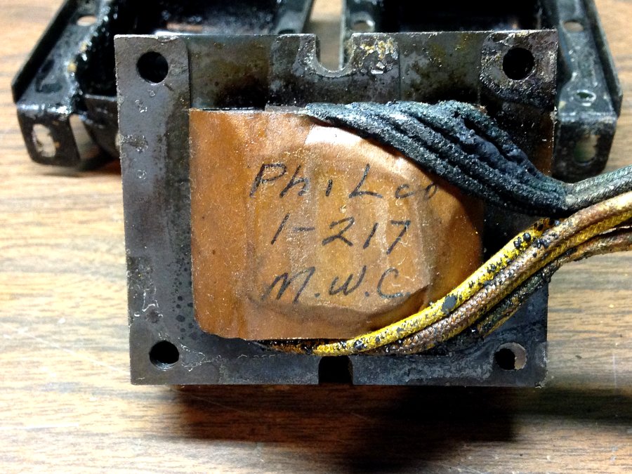

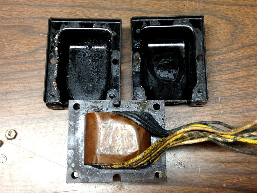

This morning, I removed the power transformer and performed a limited autopsy (limited in that I did not open up the windings).
[Image: http://www.philcoradio.com/images/phorum...e00020.jpg]
It doesn't look bad in the photo, does it? The only tell-tale signs of burning are some of the wires exiting the windings, and the charred appearance on the inside of the bell on the left. But the smell of roasted transformer is very strong.
Note the handwriting on the winding:
[Image: http://www.philcoradio.com/images/phorum...e00021.jpg]
'Tis a shame to lose this transformer, but if this radio was indeed a preproduction sample (and it gives many indications that it is), someone took it home and used it to death.

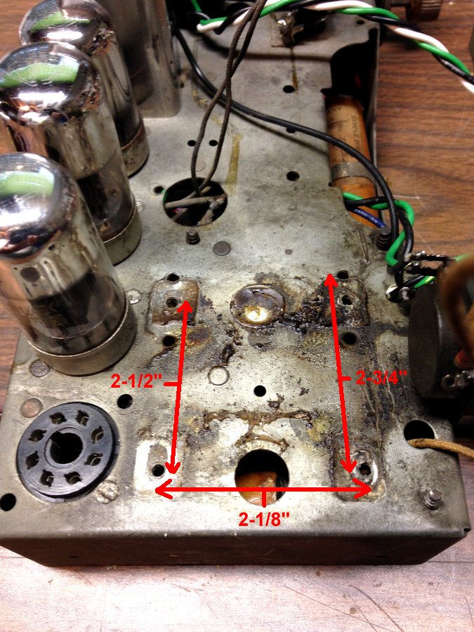

Arran, I really appreciate the effort you made to find suitable Edcor replacements. There is only one problem - the mounting width of the holes on either side of the bell is 2-1/2 inches. The original transformer only has 2-1/8" on either side of the bell, and as you will see in the photo below, there isn't much room to go much more than this.
[Image: http://www.philcoradio.com/images/phorum...e00022.jpg]
In addition, whether I purchase Edcor or Hammond, another hole will have to be drilled where the melted wax from the transformer formed a round indentation on the chassis - both new transformers have wires protruding from both bells while the original had all wires coming out one end only (hence, only one large hole in the chassis).

That isn't a hole in the chassis - re my previous post:
Quote:In addition, whether I purchase Edcor or Hammond, another hole will have to be drilled where the melted wax from the transformer formed a round indentation on the chassis - both new transformers have wires protruding from both bells while the original had all wires coming out one end only (hence, only one large hole in the chassis).
What you see there is a spot neatly made by the wax that melted and came out of the old transformer. There is a hole cover in the other bell of the original transformer, and much of the wax collected there when it melted out and left a bowl-like indentation in the chassis. No hole in the chassis there. I will have to drill a hole, and enlarge it with my Ryobi "Dremel" tool and a metal cutting bit.
Anyway, I'm going to have to go with Hammond because an Edcor would be rubbing against the rectifier tube and one of the output tubes on one side, and against the volume control on the other side - that is, if it would even go in that limited space.

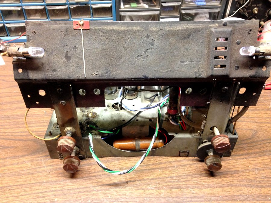

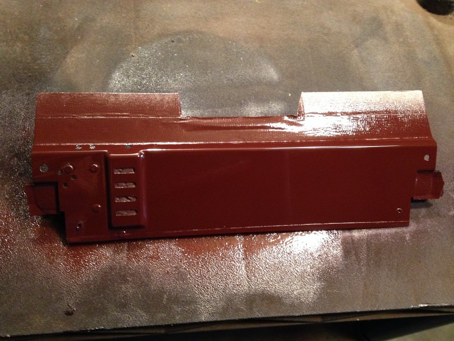

Having finished the Canadian 39, before I start on another set I decided to revisit this 42-720.
That dial backing plate really looks bad...
[Image: http://www.philcoradio.com/images/phorum...e00023.jpg]
Here's how it looks in back:
[Image: http://www.philcoradio.com/images/phorum...e00024.jpg]

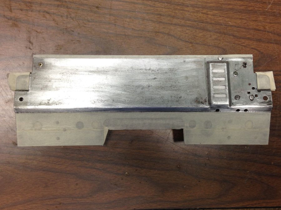

I removed this metal piece, and using a combination of scraping and sanding, managed to remove all of the old, worn, blackened flocking.
[Image: http://www.philcoradio.com/images/phorum...e00025.jpg]
I found that the backing plate of my 41-246 is identical, so I used it as a pattern as to where to mask it off. I then proceeded to paint it brown.
[Image: http://www.philcoradio.com/images/phorum...e00026.jpg]
The next step is to apply the new flocking, once the paint dries. I will use the same method used by Greg (NostalgiaRadioTime) as outlined in this thread. Wish me luck...I shall need it...
